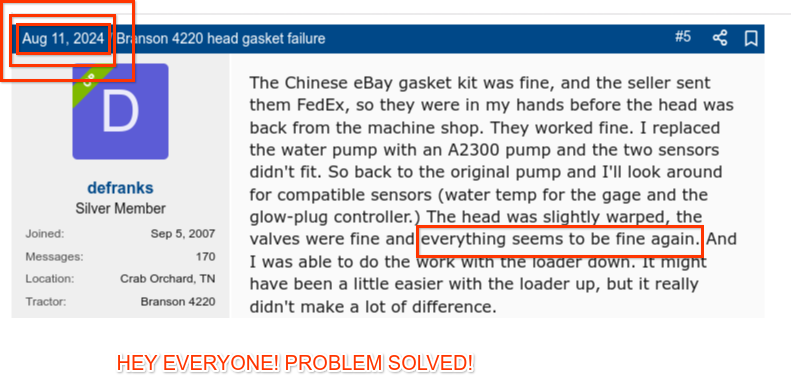

The Chinese eBay gasket kit was fine, and the seller sent them FedEx, so they were in my hands before the head was back from the machine shop. They worked fine. I replaced the water pump with an A2300 pump and the two sensors didn't fit. So back to the original pump and I'll look around for compatible sensors (water temp for the gage and the glow-plug controller.) The head was slightly warped, the valves were fine and everything seems to be fine again. And I was able to do the work with the loader down. It might have been a little easier with the loader up, but it really didn't make a lot of difference.

So the previous repair did not last long. How warped was the head?
I'm not the op.
Why are you thinking that the previous repair didn't last?
The op was the last to report on this thread, stating that "everything is ok" then (in August 2024), until you responded 8 months later.
/ Branson 4220 head gasket failure #16
I'm not the op.
