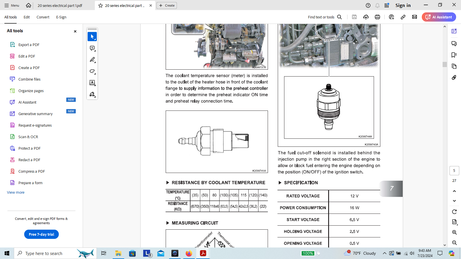

Does this 2 coil solenoid have a relay between ignition switch & solenoid? Does the 70 amp relay on left side of firewall under dash control any part of the fuel solenoid function?
What is the function of the rectangular electrical box mounted on right side of firewall under dash? My fuel electrically solenoid pulls in ~25% of the time. It stays in once activated & shuts off normally. Ideas & suggestions welcome

On my Branson 3510, the shutoff solenoid’s rubber boot was shot. It limited the movement of the shutoff solenoid, the plunger was extending too far. I used a couple of zip ties to limit the extension after researching and finding the cost of a new solenoid $$$.

From the 20 series manual;
  • Branson 20 series wiring part 1 pdf.pdf
