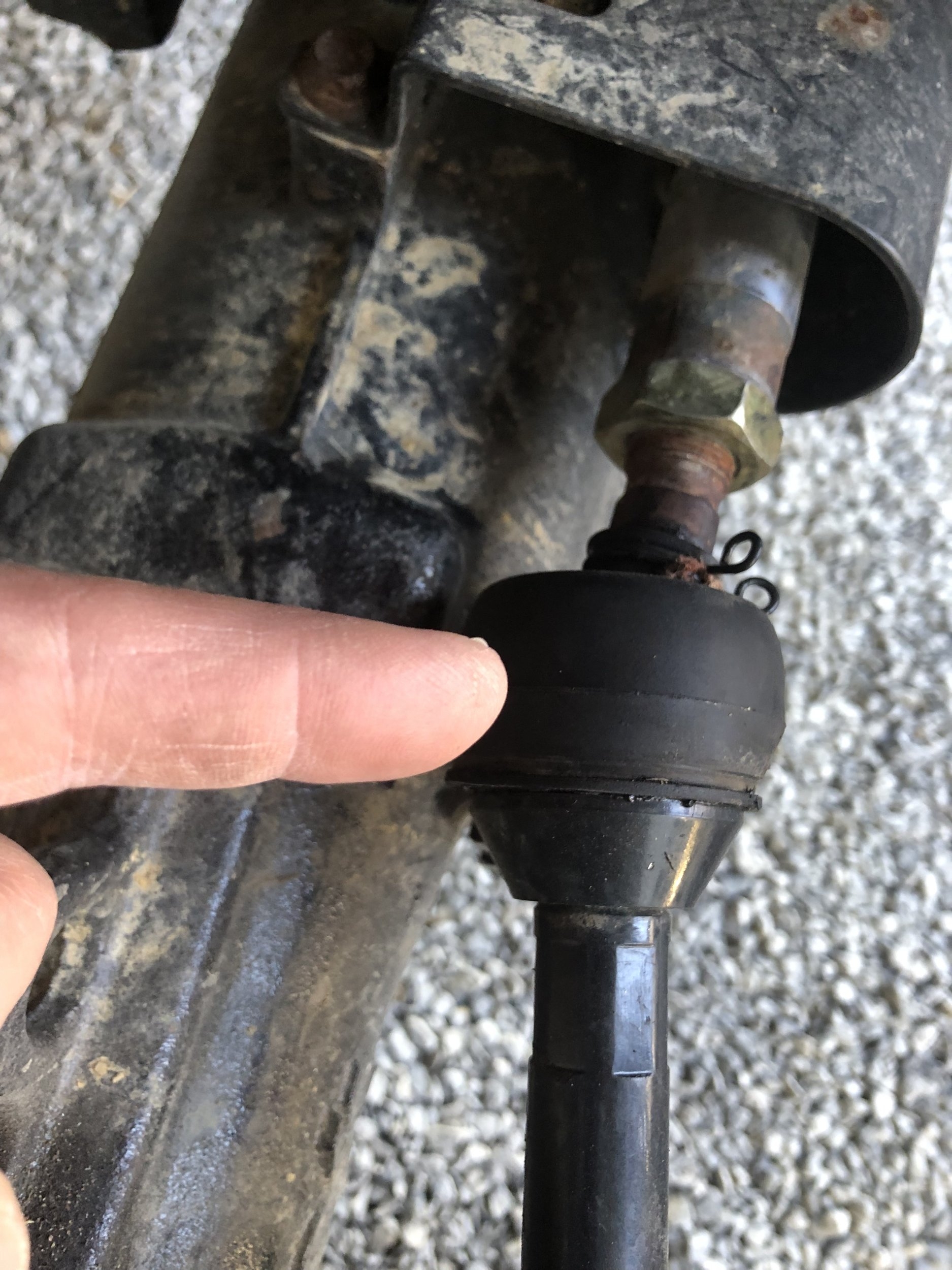

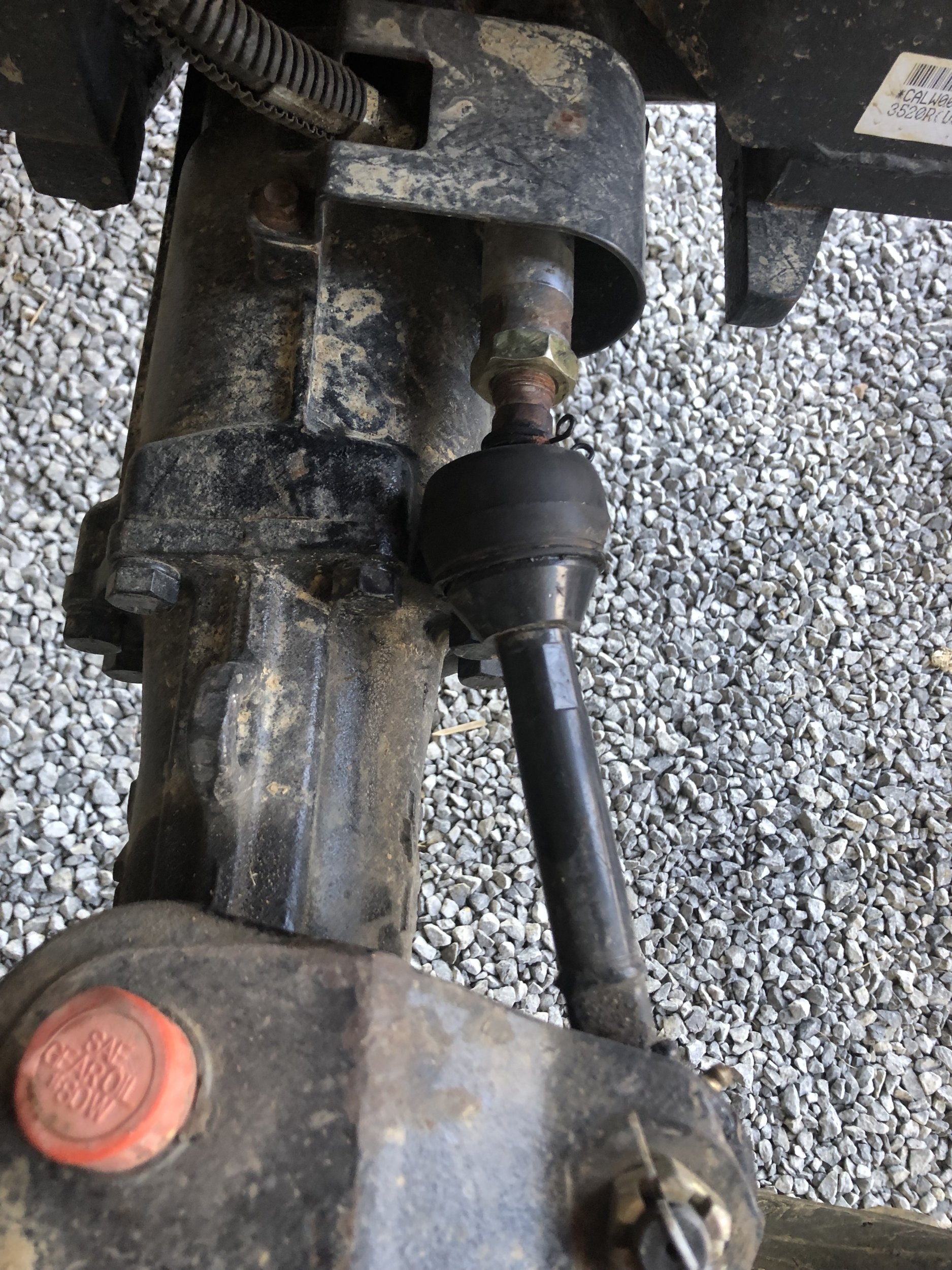

Pull apart my tie rod assembly today at the point where i am pointing.
Put it back together by using front loader to lift wheels , lined up assembly , lowered the tires to the ground, then turned wheel to get it to push back together.
It came apart again. Repeated process.
Is this repairable? Or just replace?
Wasn’t sure if there was any fixes out there that i didn’t know about …
Branson 3520R
Also where is your “go to” buy parts for this ?
Dealer and aftermarket?

That is where the ball end sits inside a socket. Usually not worth fixing. Best to buy a replacement.
Hope this helps!!
/ Branson 3520r tie rod assembly #3
That particular part is equipment specific or a small range of such so you will probably have to go to a dealer. Branson dealers are all across the US and take orders and ship parts. One near me Is Big Tex Branson on I 30 East of Dallas. They will order and ship your part and are nice folks. One of the guys in the parts dept. is a member of a farm forum....either this one or Yesterday's Tractors.
