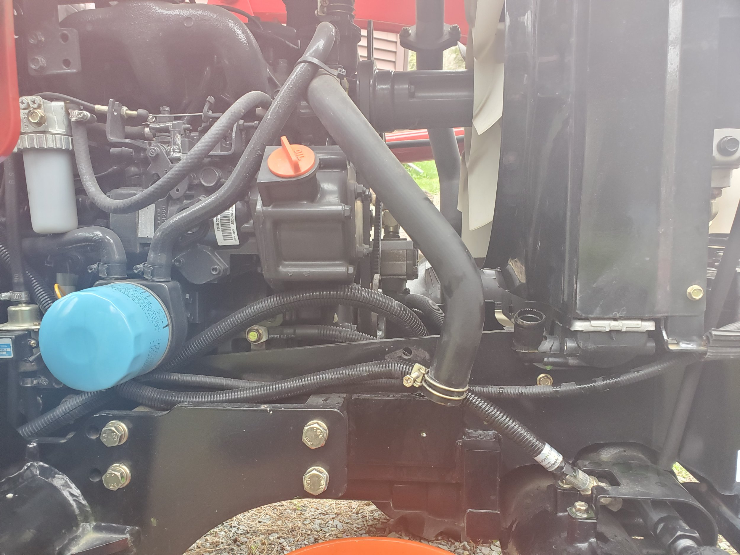

I have my dunce cap at the ready - please know that I am a newbie. I have a Branson 3520h that was sitting a couple of seasons. The coolant level was low so I decided to do a full flush to get any grime out.
Popped radiator cap, removed drain plug. Didn't get as much fluid as I expected - capacity is 1.58 gallons. Replaced drain plug and added distilled water to radiator which took less than 1 gallon. I ran the engine for approximately 15 minutes. Confused, I hit tractorbynet and found a post that I may only be draining the radiator but NOT the engine block. Suggestion: Remove lower radiator hose.
Drained again and plenty of neon green coolant came out and again, less than ~1.58 gallons. I popped off the radiator hose and ... nothing. I have seen some posts that suggest a drain plug on the engine block itself but if there is one, it's not obvious (again - newbie). Given the < 1 gallon refill and neon green on the second drain, I am sure I am missing a drain and not getting everything (probably a little more than half).
Lastly - I don't know what I can mix and match for coolant. I know the coolant in there is/was green and I have a new bottle of Peak Fleet Charge SCA. Is it a matter of sticking a garden hose on and flushing through the radiator? Is there any issue flushing with well water vs. distilled? If I am going to flush with a hose - fine, but it seems like there should be a reasonable way to gravity drain most/all and then flush for the residue.
The manual is nearly completely unhelpful.
Picture showing right side of tractor, rad hose off, and drain plug off.
Thanks for reading.

I think you are probably good. Most antifreeze today will say safe for all colors so just go with that and fill the system and don't worry.

This is from the service manual. It is not real clear but no mention of a block drain. I do not know of a location for a block drain on your tractor. If it looks clean you have done good enough. If the bottle of coolant says it is compatible with all then you will be ok. If you just really worried about it then keep going with distilled water until you drain just clean water back out. Personally I do not like tap at all in a cooling system even for flushing. Hope this helps.

It's just good practice to not mix different coolant types. I would thoroughly flush prior to switching. See if there is a coolant hose that comes off of the bottom of the engine, and remove it. Perhaps that will drain the block.

Most of the newer tractors will not have a block drain. On your tractor the heater type hose on the oil cooler/heater will drain more out of the block then the radiator hoses.

Then I would pick a different coolant that is compatible or keep flushing with distilled water till clear.
To speed things up some you could remove the thermostat and get a longer top hose to pump water out into a bucket. The key here is not letting it get to temperature but shorter runs with long cool down times.
It would probably flush it all out with one radiator full of distilled water that way.

Thank you for all of the responses and advice. I flushed a few times with distilled, grabbed GREEN antifreeze and filled the radiator with concentrate, figuring it would give at least a 50/50 to avoid winter freeze issues. I was able to move on from this and hit more issues as is always the way. But that's another topic for another post.
