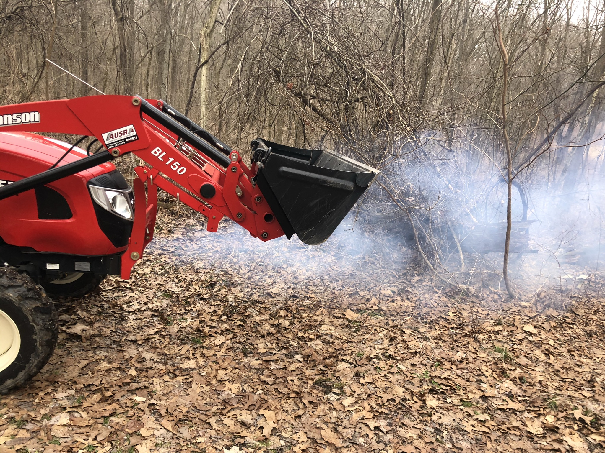

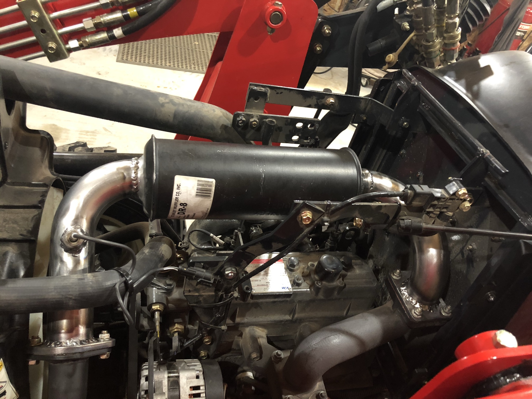

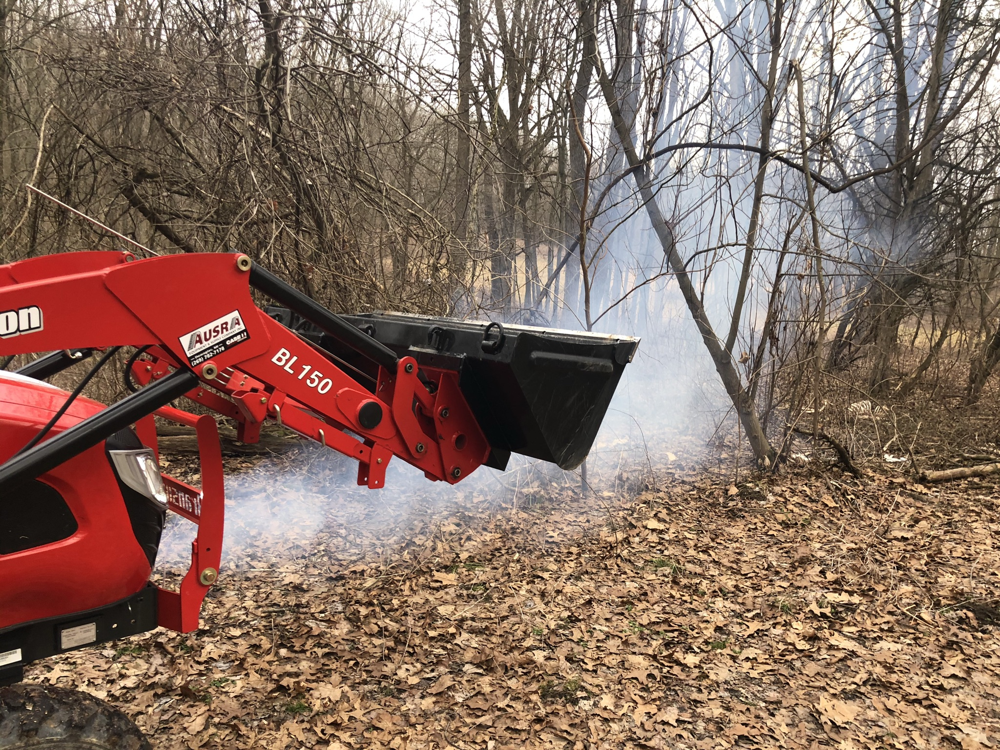

I have a 2018 3515R. I just went ahead and did a DPF delete (replaced the DPF with a muffler). Everything went fine except I notice blue smoke from my exhaust now. See pic of my new exhaust setup and smoke at 2500 RPMs. More details below.
At startup some smoke but clears up for the most part.
- Idle to about 1500 rpms not much smoke
- 1500 - 2000 bearable but start to notice the blue smoke
- mid 2000s it starts to pick up.
- at 2500 constant billows of bluish smoke
I can't understand how an engine this new could have bad rings or seals, but i'm very concerned at this point.

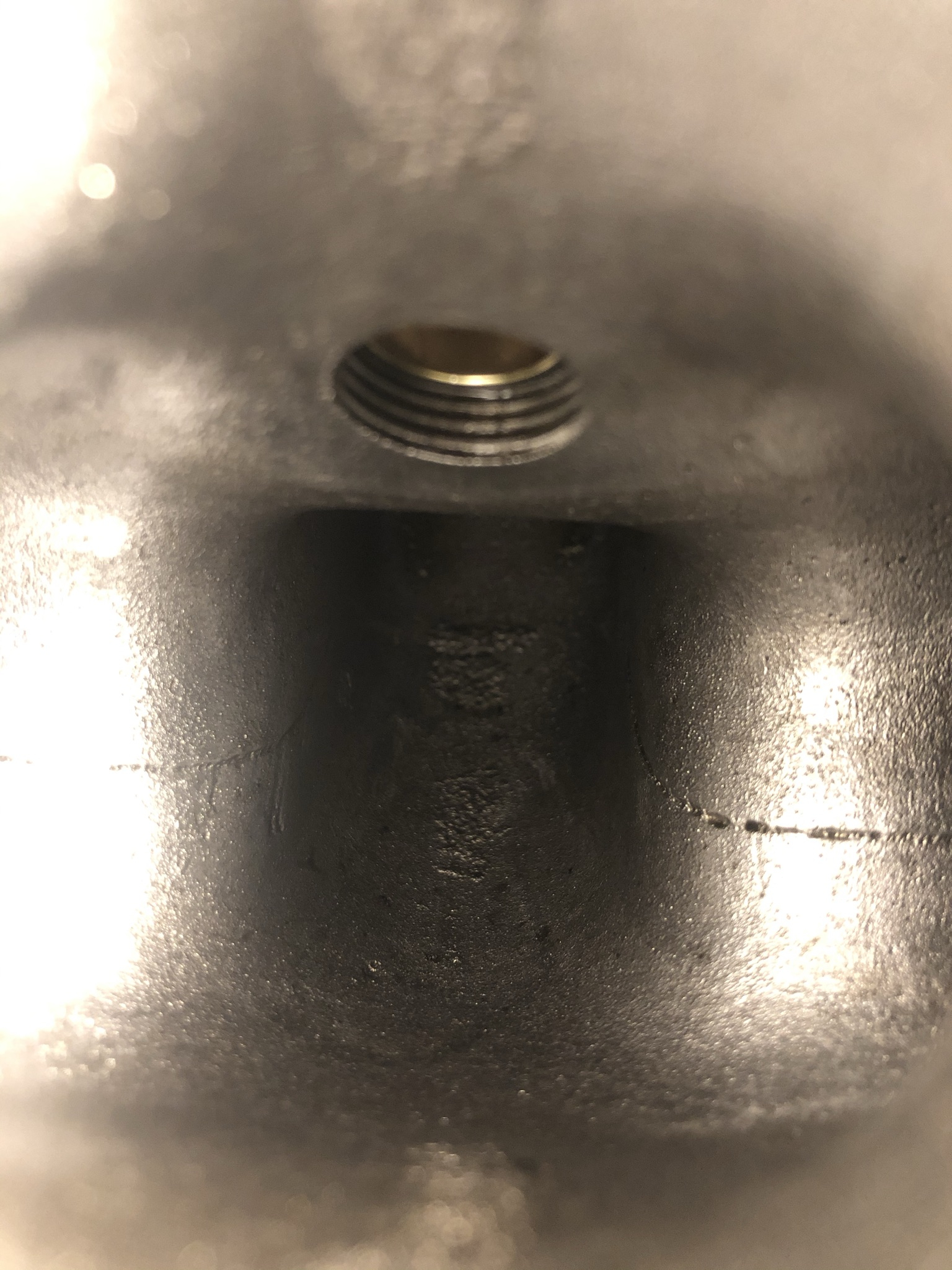

- I read online that the crankcase breather valve (PCV) could be stuck and sucking oil from valve cover to intake. Pulled the breather hose, had a little oil in it but not any visibly in the intake(see pic). To confirm i removed the hose completely, plugged the intake port and vented the valve cover to atmosphere. Ran for about an hour and no change. Put hose back on. I assume that rules it out?

He can put the emissions stuff right back on. They might notice the cut and weld on the exhaust pipe, but I doubt if they will give a rip. Most Branson dealers know about the dpf delete and probably don’t care.

I made new flanges and all so it will bolt right back on and look stock. Also both sensors still hooked up, so will be logging exhaust temp and that filter isn’t clogged. I just plugged the differential sensor but actually installed the exhaust temp sensor in exhaust.

I'm wondering if the underlying issue was masked by the filter trapping the blue smoke from the beginning. And yes, blue smoke is oil, not fuel. I don't think this has anything at all to do with your filter delete. If it was blowing black smoke, I'd be inclined to think that maybe there was a fuel adjustment issue, but not blue smoke.

If it was mine I'd run it and just keep a close eye on the oil level.
A diesel can have blue/gray smoke from fuel especially if the engine is running a bit cool.
If you get another 15-20 hours on it with no change in the oil level and not having to add oil,
the smoke would not be oil.
