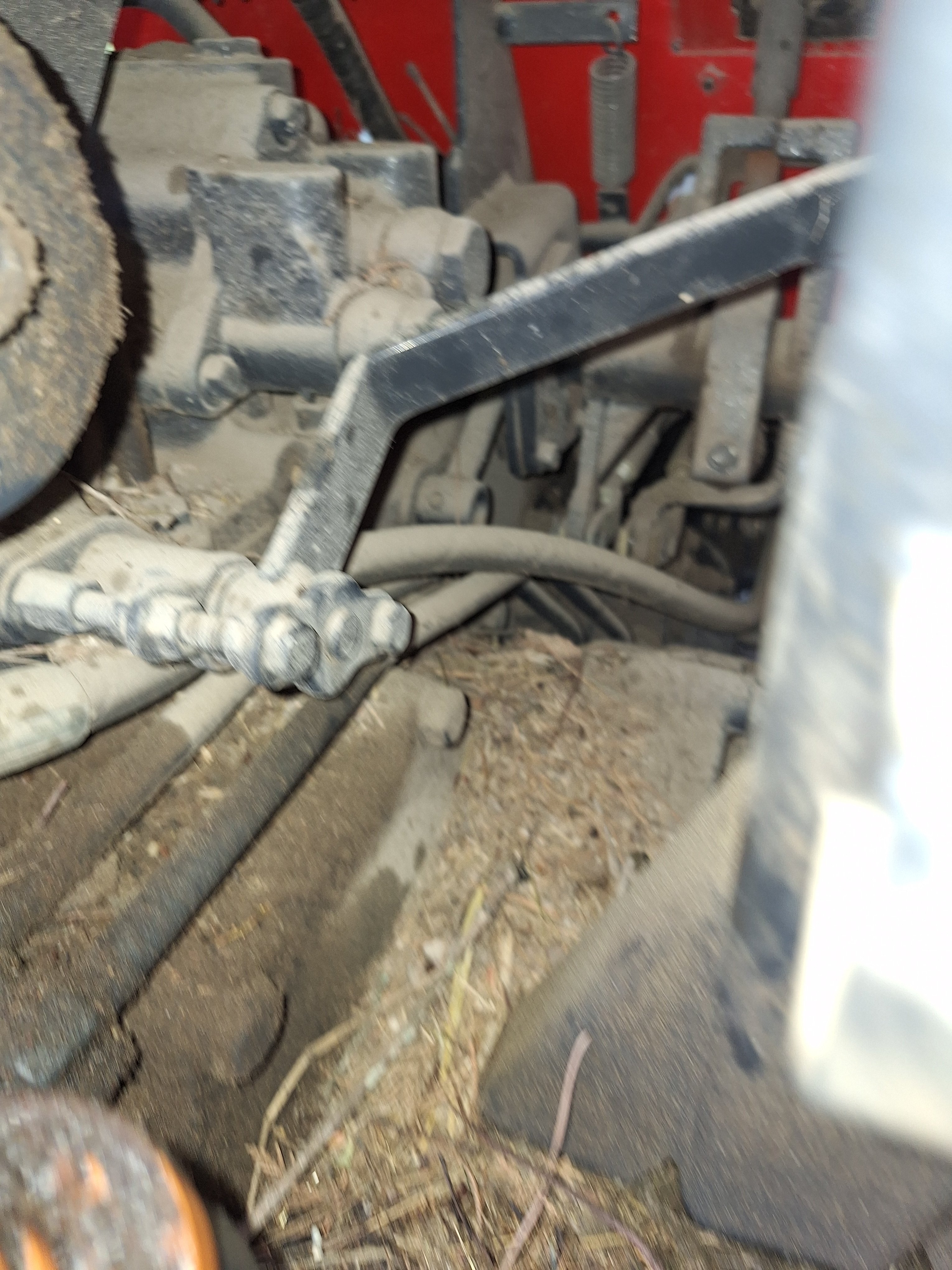

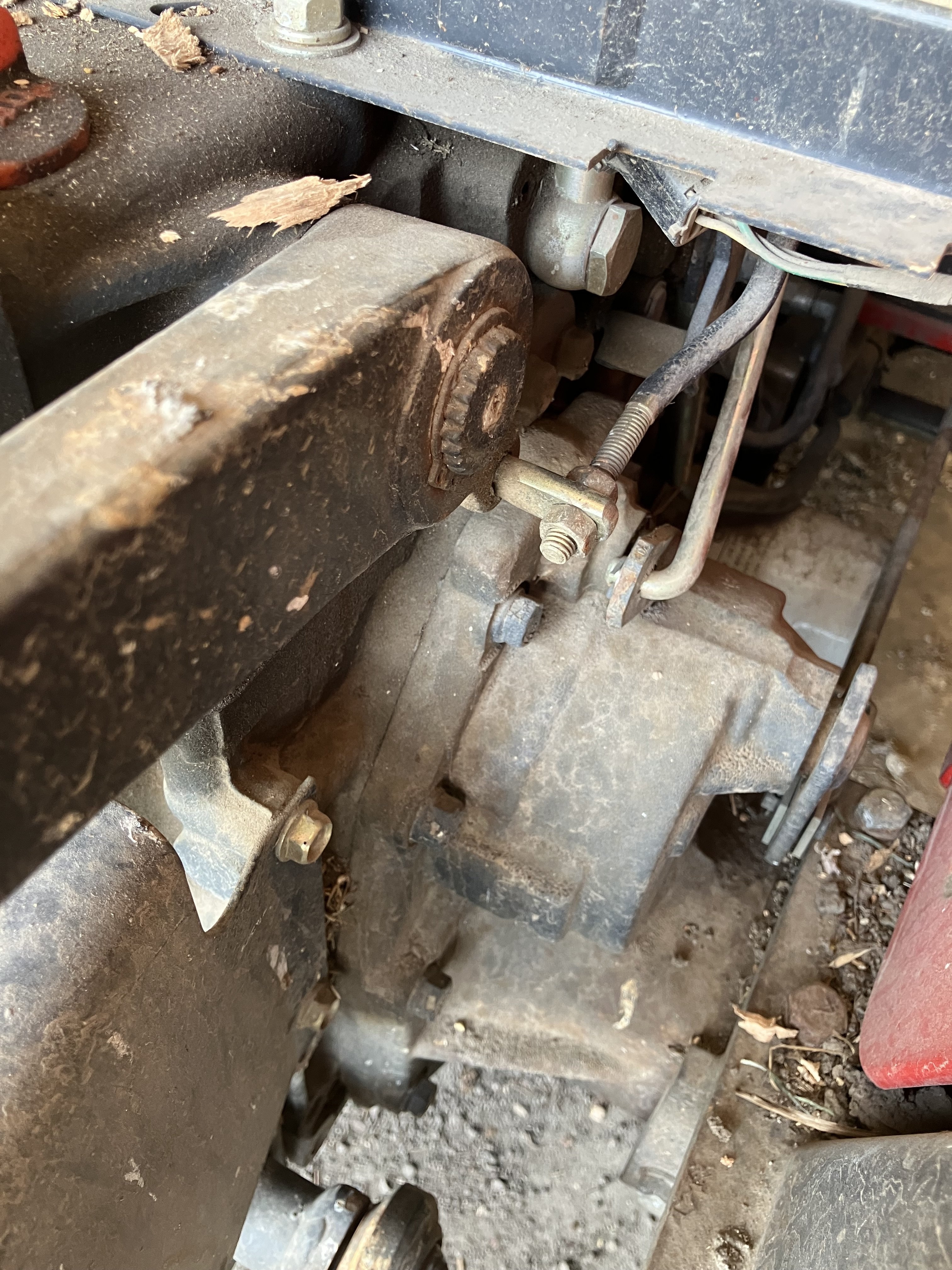

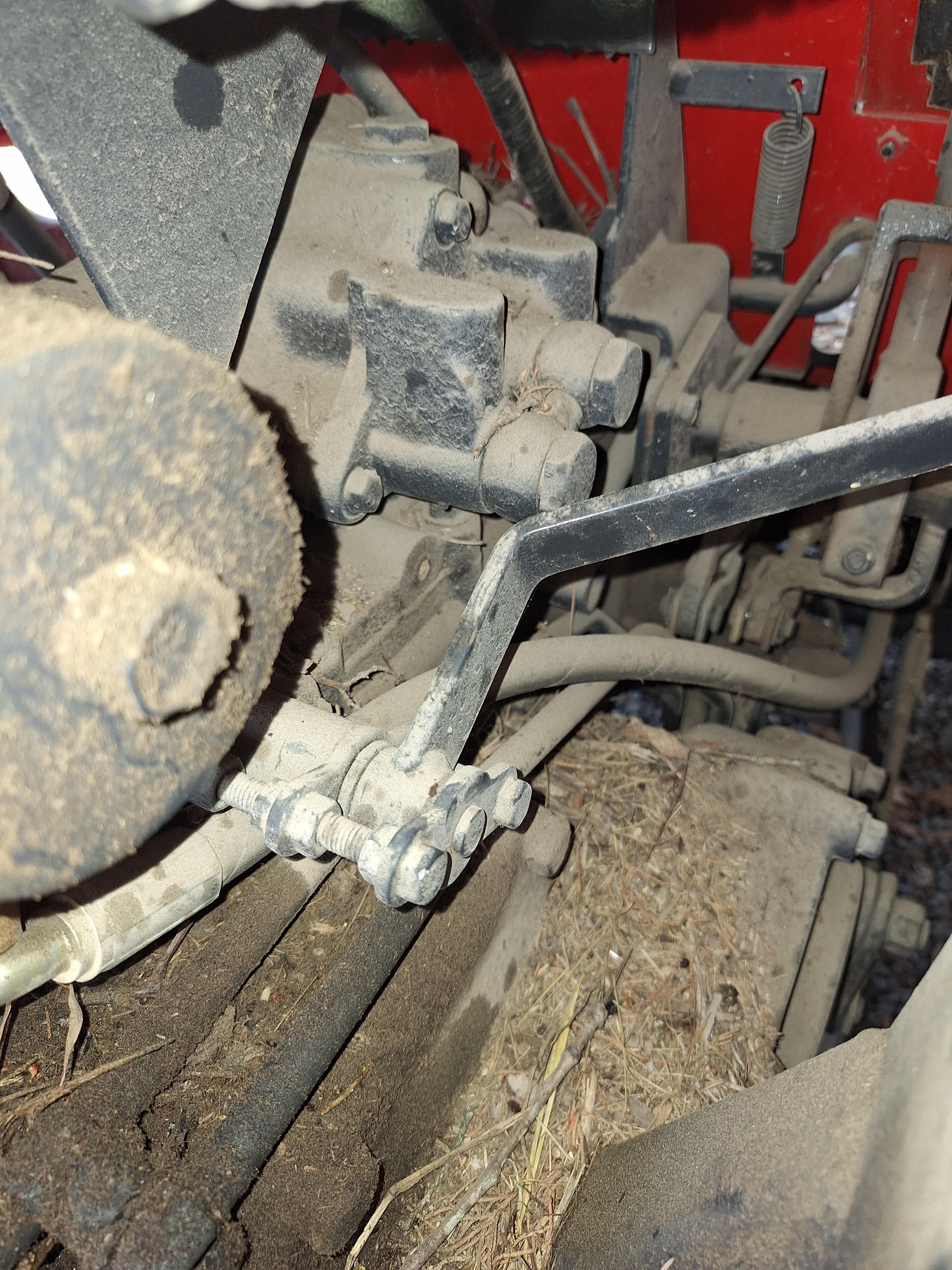

On my 2400H there is a feedback lever connected to the right lift arm. It has two nuts that you adjust to obtain desired max lift height. If one of the nuts works loose it will not operate correctly. Not sure how yours is made.
Threaded rod in picture
/ Branson 3-point hitch hydraulics
The attached photos show what I have. I don't see a detached linkage or anything loose.

/ Branson 3-point hitch hydraulics #8
I believe it's all done internally on that tractor. It could indeed be the feedback linkage but it will require take the top cover/rockshaft housing out to inspect it.
Although, I was checking some pictures from the service manual and it may have a linkage on the left side of the top link mount. Looking from the rear of the tractor.
You were right about it having feedback linkage on the left side of the tractor, looking from the rear. However, there is no missing or loose linkage there. However, there is a limit switch that makes contact as full lift is approached and it looks as if the wire may be broken. I don't know what the limit switch is for except, possibly to indicate max up position. Don't know what happens if the limit isn't made.
