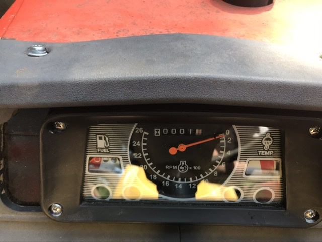

I was wondering if there is a cluster meter board that doesn’t cost over $500 dollars to buy, a universal one?
I believe the board on mine is digital.
Thanks You, any advice is welcome.
Sally

can but chinese instrument clusters for about 100 bucks , i guess its just a case if you can get a need fit, as ptsg says the interface isnt terribly on basic tractors. most tach signals come of the W connection on the alternator, then you just have to match the resistances on fuen senders, oil pressure senders etc... i guess sits a tradeoff of what your time versus the part is, have you looked into getting the branson board repaired?

you would have to sound out an electronics enthusiist, you would likely need to find/provide a schematic for the tractor, (see 10m, 20 seireis survice manual. Servicing Manuals for Branson - Google Drive page 33) from that they would know what power to pit on which pins to fault fond the cluster, is the whole cluster not working of just some specific signals? if its the whole cluster its likely something common like a negative link or a 12v supply.
fwiw it looks like the wiring loom of these bransons is same across a few models,
"Branson Tractors OEM HA00000014J Wiring Harness Assembly
Used in Branson models 2100, 2400, 2400h, 2800, 2800h"
alternatively migrate each guage/indicator across 1 at a time to individual guages, such as this one for tach/hourmeter,
and pilot lights, 12V 24V 8mm Symbol LED Dash Panel Warning Indicator Pilot Light Car Boat | eBay

What is the issue with your existing display, Sally?
the fuel gauge,temperature gauge, turn signals, dash lights do not work,

The only thing that works is the pto rpms and the hour meter and the needle on the rpms is broken, it looks to me a previous owner had attempted to repair. I didn’t buy tractor from a dealer.

Also, keep in mind it could be a matter of bad grounds, bad connects or even as simple as wiggle the plug in the back of the dashboard.
It doesn't necessarily has to be a bad board. Even if it is, it's still a simple dash, so it could also be just broken solder joints on the components inside.

I sincerely doubt that all those items would fail at the exact same time. I would propose that you don't have bad instruments, but a bad connection from the instrument panel to the rest of the tractor. I would check out the connectors before taking on such a drastic course as changing out all of your instrumentation.

Op says they got the tractor used, possibly these items have failed progressively over time. moisture inside the cluster can corrode tracks, solder joints and connectors. our deutz we got 2nd hand i had to repair the instruments, some had blown pilot globes (replaced with LED all but the alternator charge light which has the exitation current to the rotar run through it) , some has corrosion on the in pilot lamp bayonet fittings,

download the manual that has the wiring diagram in it i posted earlier. will make fault finding far easier.
