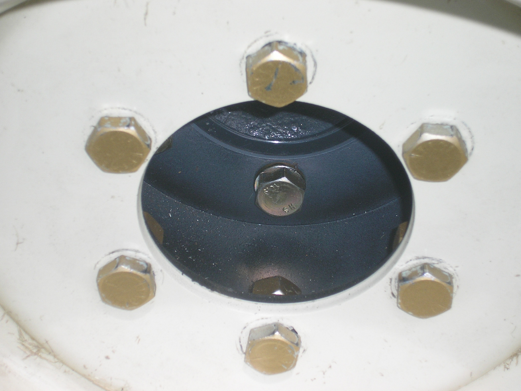

I have a 2810 with the solid extra wide track wheels and R4 tires. Outside rear width is over 72? I致e been trying to plow with two bottom plow but it won稚 stay in furrow. I can稚 get the point to be in line with edge of inner tire because wheel is so far out. I can稚 turn wheel around because it hits lift arm adjusters.
Does anyone know if they make spacers that will allow me to turn wheels around or where I may can find some narrower wheels with ag tires. If not, does anyone know the wheel bolt pattern?

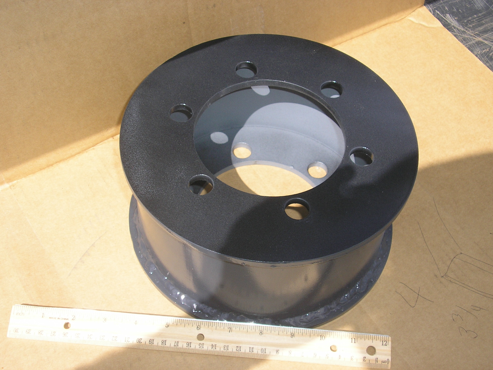

You do any steel work, welding? I made my own for a 2400. Took one quarter inch steel plate stock and a diagram to a machine shop and they made 2 plates per side. Went to a pipe supplier and got a piece of 8" diameter pipe which I cut (or could have had the machine shop cut) to 4" length as for my application and tires that made my max width within 60" and my 5' mower would run within my tread width. Cost me less than 80 bucks for the deal.
I initially looked online and found some on ebay but weren't for my tractor and I figured I could do exactly what I wanted for a cheaper price. So I emailed the guy (through ebay) and he makes different sizes. Might give hime a look-see. By the time you figure what he has in making/selling them, his price isn't unreasonable. I don't have his address, just go to ebay and plug in "tractor wheel spacers" and go from there.
