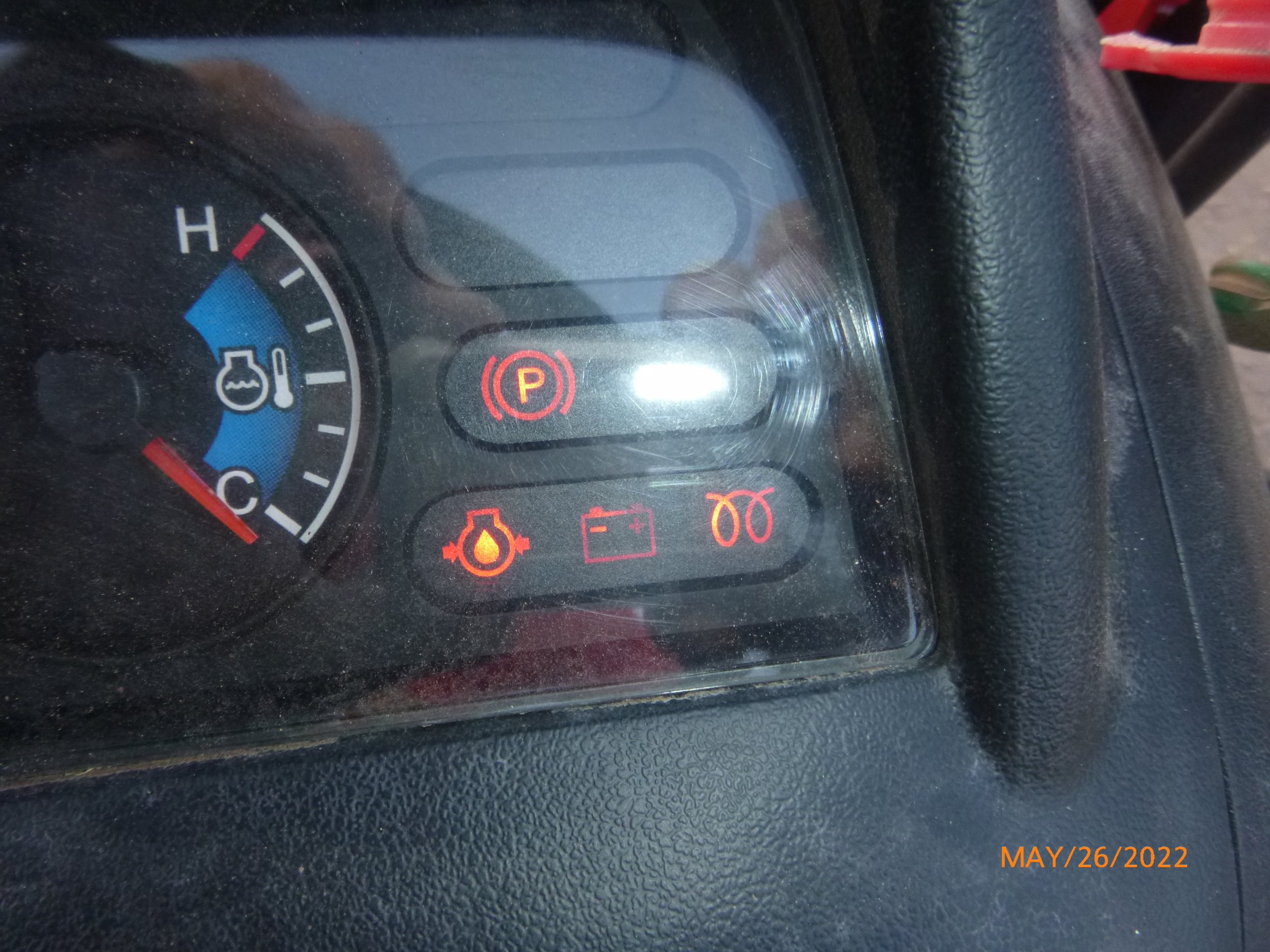

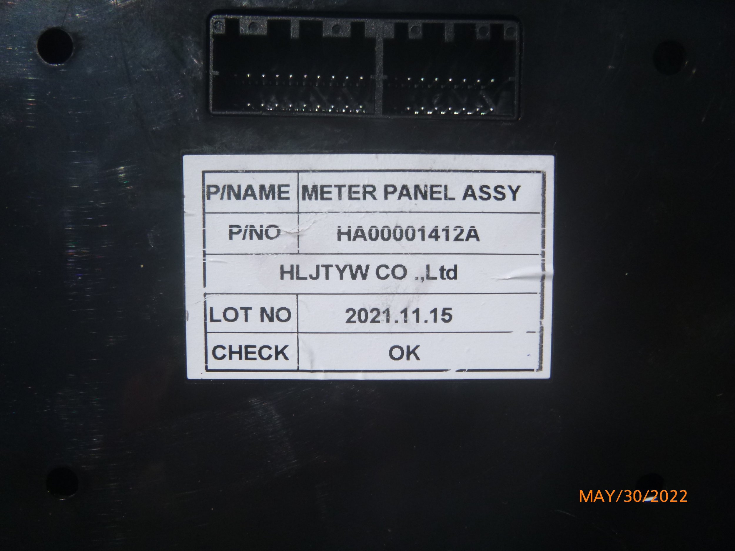

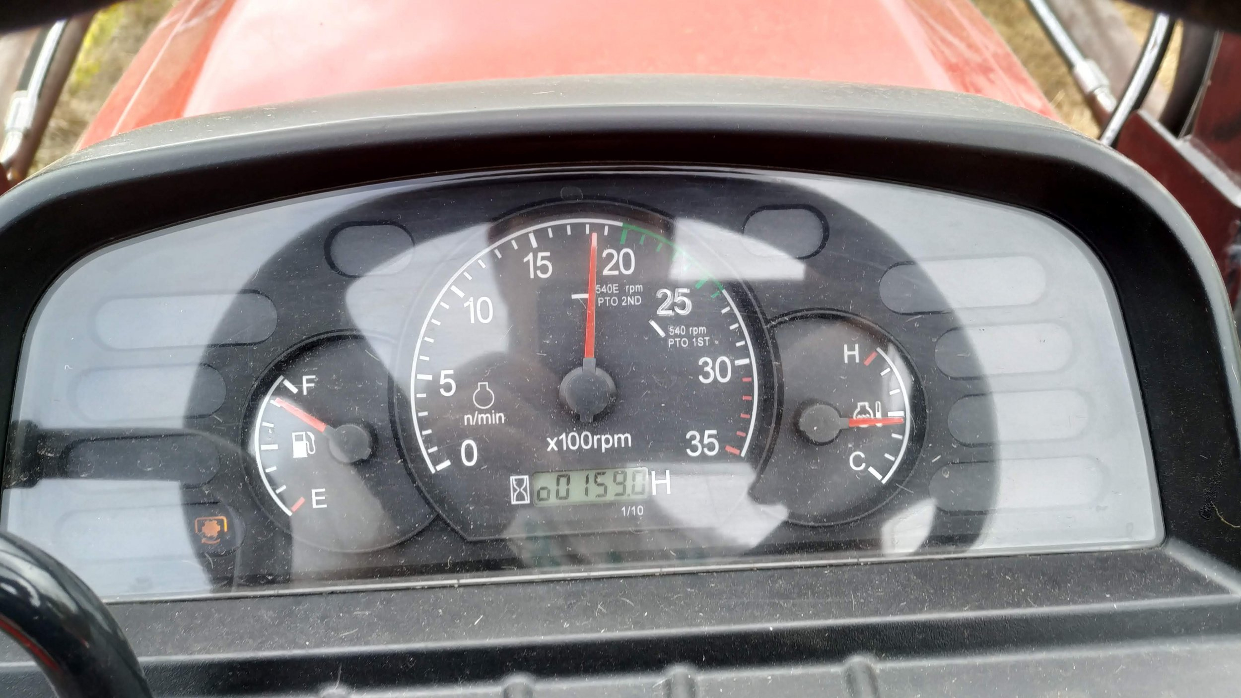

Here is a picture of the gauge set (Meter Panel Assembly) showing the indicator lights working when the key is turned to the on position.

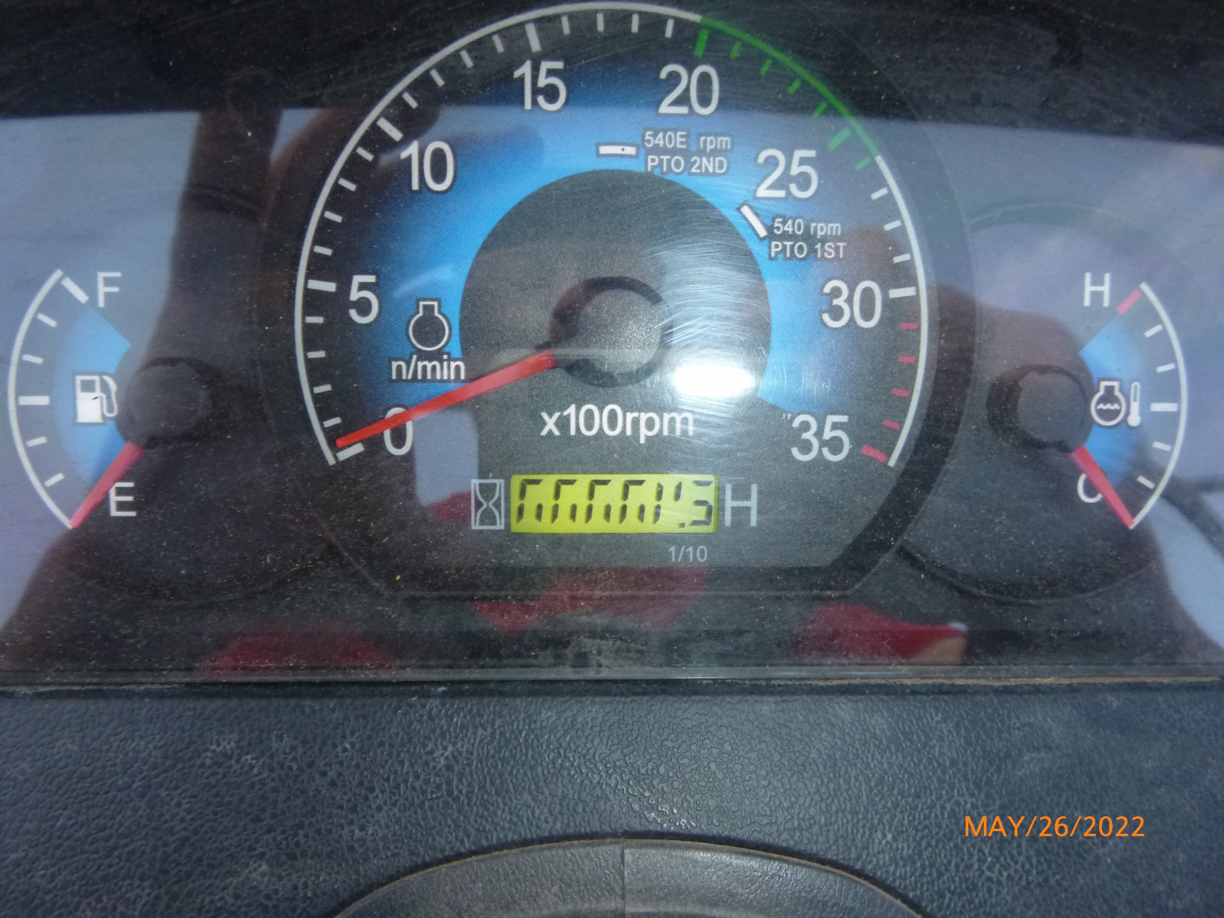

Here is the gauge set with the engine running. Notice the engine clock.
Anyone else have issues with the gauges?

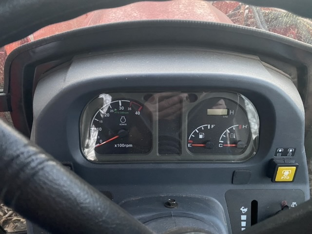

I have not heard of a problem with them other than some of the new 15 series panels do not have the temp gauge at all.
That is unfortunate. That panel looks totally different than mine. I wonder if it is out of a TYM model? Maybe someone that has TYM equivalent could chime in.

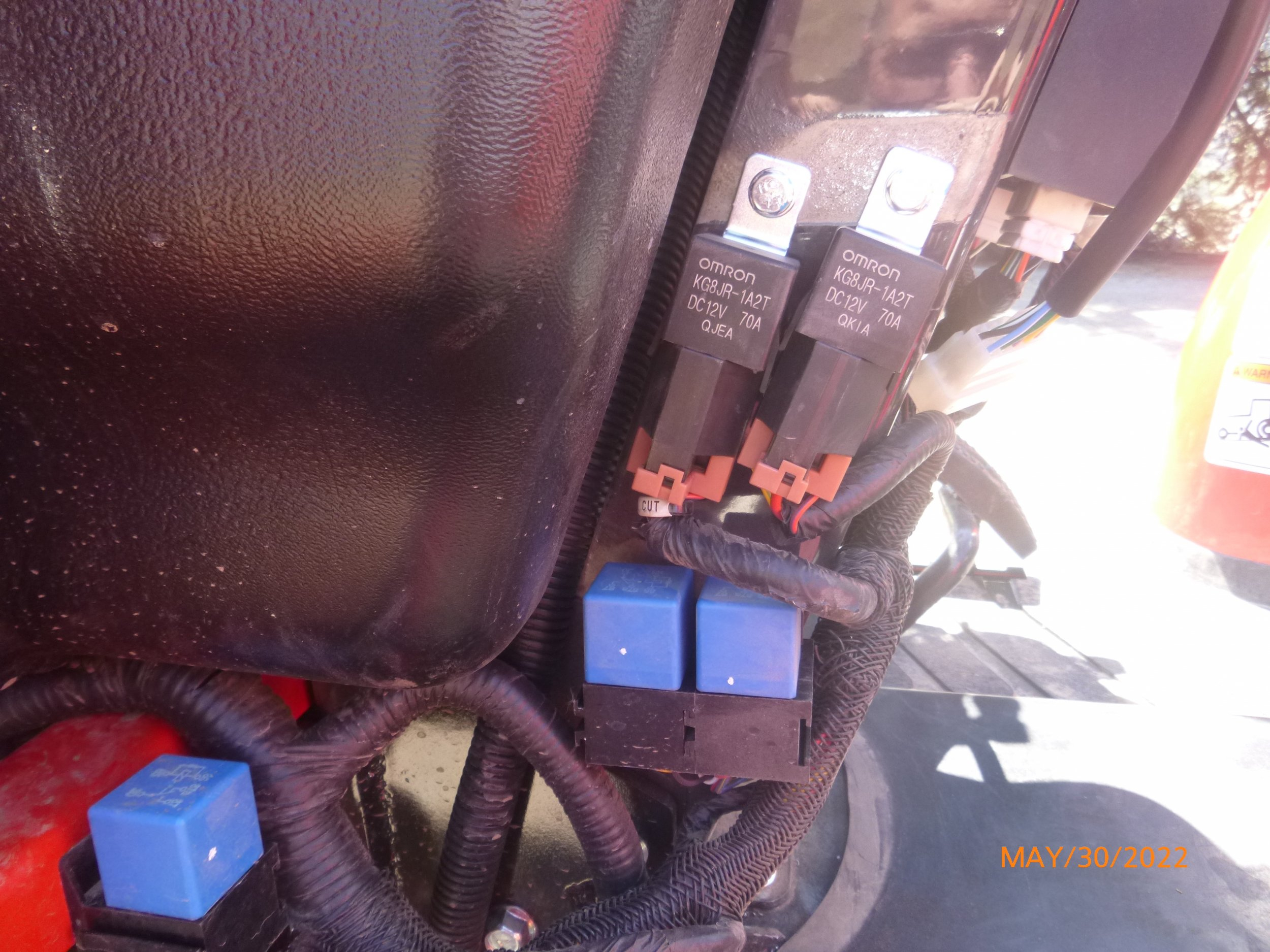

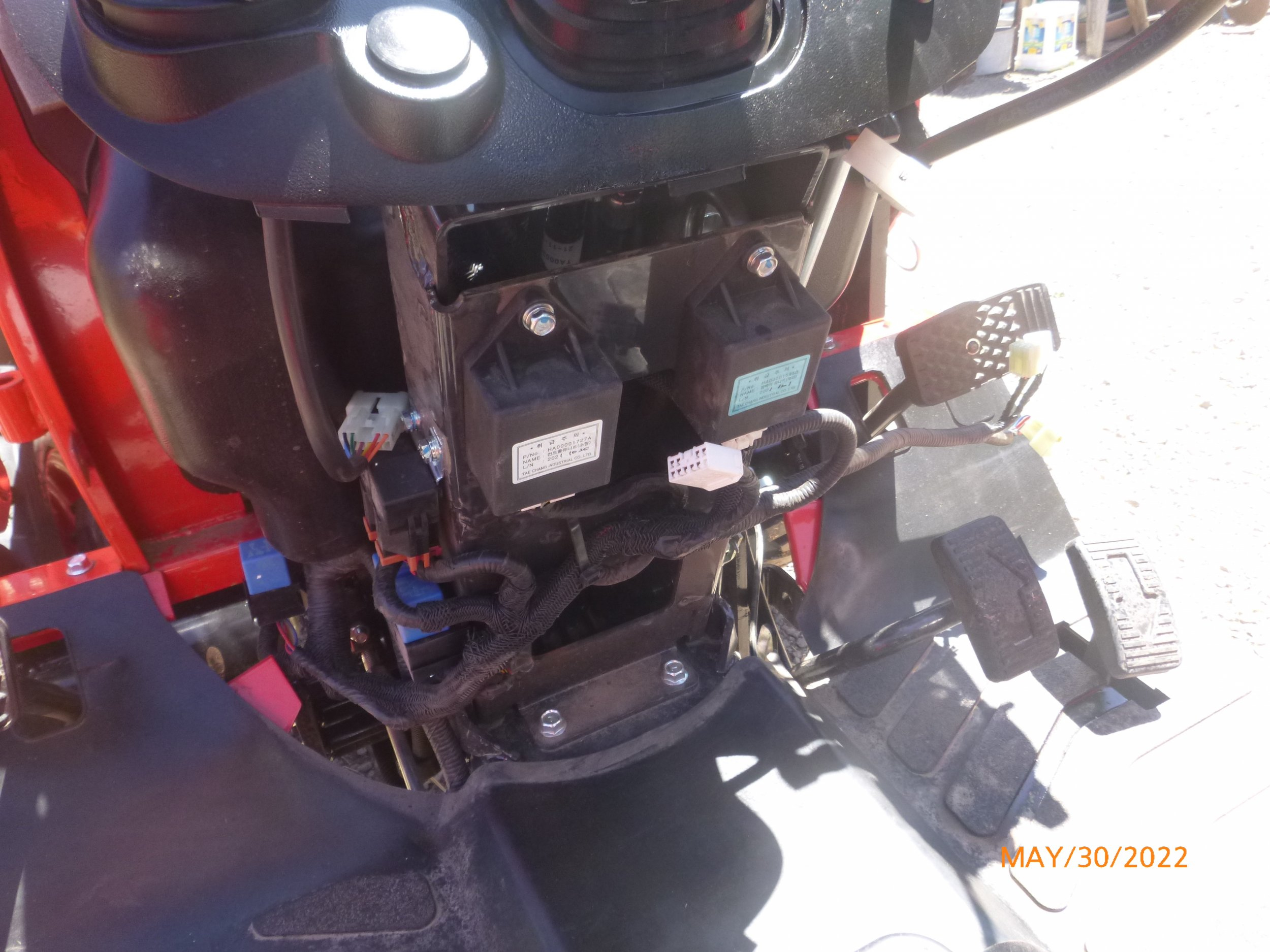

The 2610H electrical system seems to be a black-box mystery. I cannot find any wiring diagrams online. There are two control modules and five relays under the dash panel. I've checked the fuses, they're good. Anyone know where I can find a wiring diagram?

My instrument panel is a version older than that. Doesn't have the blue accent. Other than that it's the same.
An older picture I had:
Anyways, good thing that you mentioned the random shutting of the engine. I think you have some electric issues going on that affects the fuel shut off solenoid and also may or may not kill the instrument panel.
One of the boxes is the glow plug control module and the other is the flasher module. Can't remember which one is what right now but those are the same as my tractor.

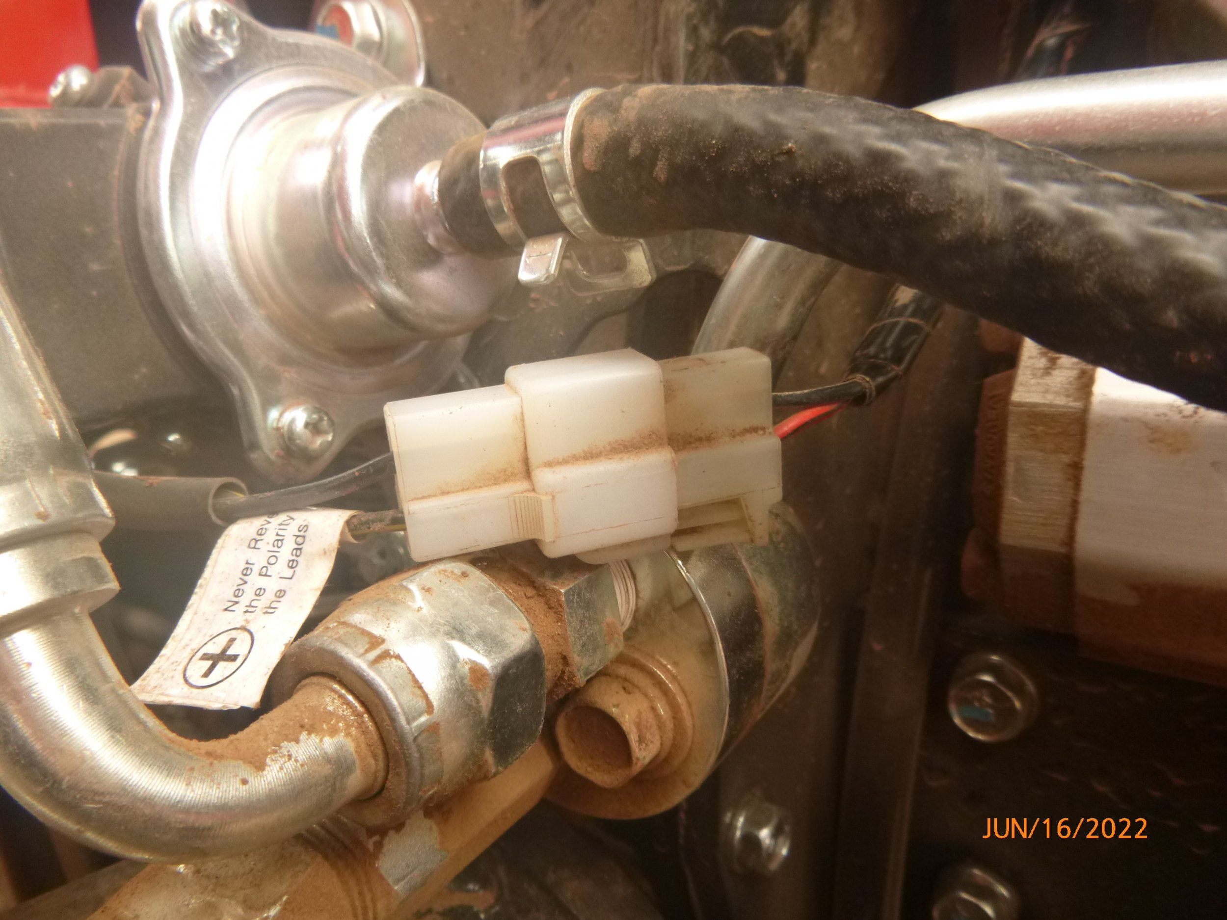

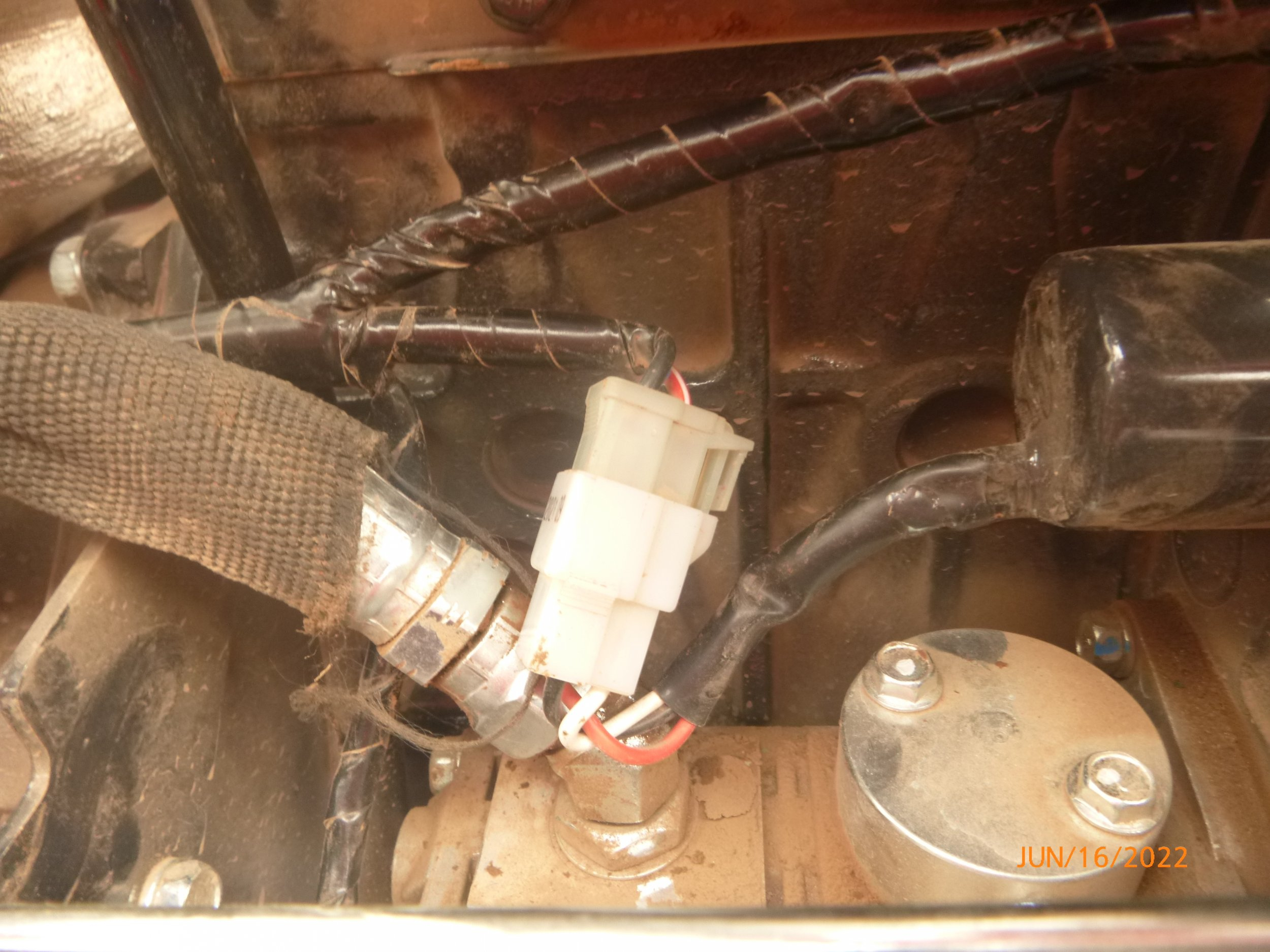

I was just checking the wires to the fuel shutoff, wiggling the wires and looking for a ground fault. Now the gauges are working. I tried wiggling the wires while the engine was running but couldn't make it shut off or cause the gauges to fail. I'll try reenforcing and insulating that section of wire harness with spiral wrap. Here are pictures of the wiring to the fuel shutoff and fuel pump.

As you can see from the picture of the back side of the panel, it is hard to determine which is the ground connection (or any connection). With the wire harness exposed, I have tried to cause the panel to fail by force. I can't replicate the issue. Without a wiring diagram it is hard to guess. Perhaps the panel is powered through one of the relays. There is a panel fuse, but it only affects the lights for the battery, oil, glow-plug, and break indicators. Why are there three wires to the fuel solenoid? I could try pulling the relays one at a time to figure out what they control.

The three wires going to fuel solenoid are ground, one for main start pull-in power and 3rd wire is lower voltage- amperage hold or run circuit. This reduces the temperature rise in the solenoid and reduces premature failure.
Without studying wiring diagram not sure why have both fuel shut off relay engine shut off relay. Possibly a fail safe where two components must fail to prevent engine shutdown

Thanks @oldnslo, The service manual (with wiring diagrams) that @Asteral provided helped me to figure some things out, like the difference between the Pull and Hold circuits to the fuel solenoid. So, the engine stall issue could be caused by the engine stop relay as suggested by @Number15. I'm still unsure of what causes the gauge panel to fail periodically. The indicator lights are controlled through the Control unit, but the gauges and engine clock are controlled by a microprocessor in the gauge assembly. Any interruption of ground or Vcc to the microprocessor could cause the gauges to fail. Time to check all the ground points as @Asteral suggested.
