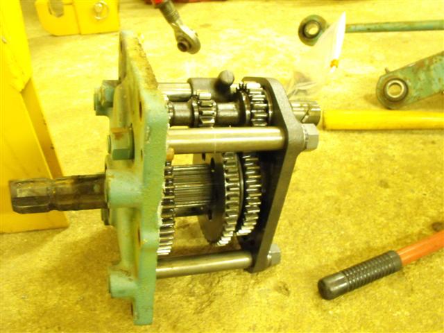

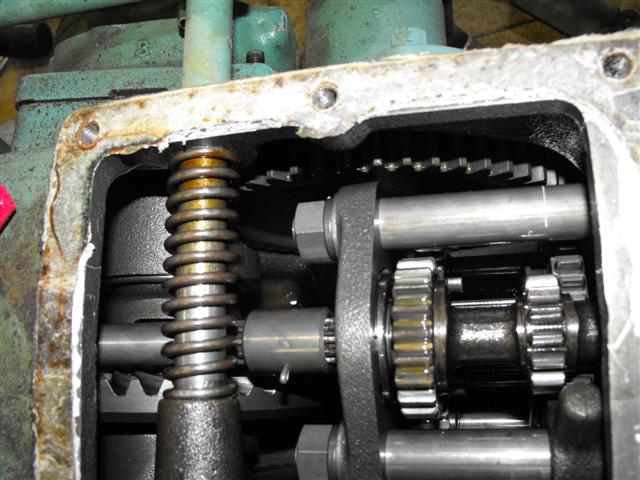

Took the 3pt housing off and the problem became clear. The entire PTO and rear axle has to come out before I can remove the brake drum housing. The PTO assembly has to come out to get to the axle drive gear snap ring. The main axle drive gear (big one) sits half way inside the brake housing.
Not what I was hoping for and not very clear in the service manual.:(

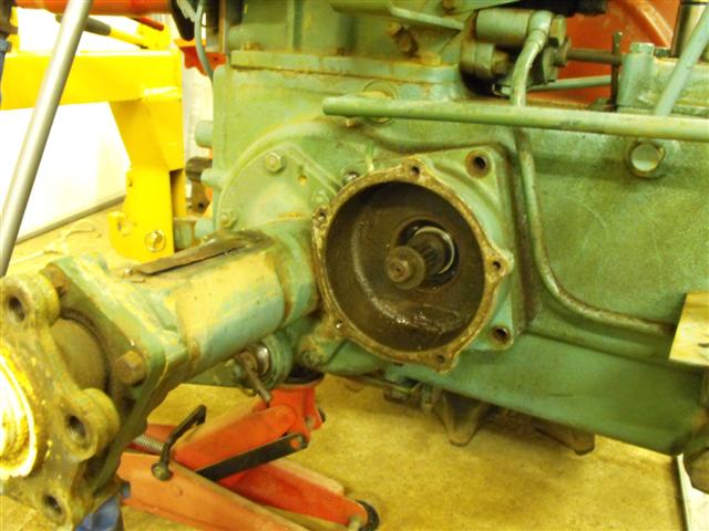

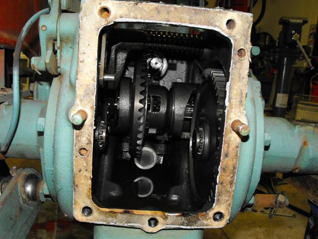

This brake job is turning into an all out disassembly effort on the rear end. All I wanted to do was replace a bearing and a seal. Somehow the service manual didn't think it was important enough to include the steps. Oh well, at least I've found a few things that need attention. (a frozen axle hub on the axle and the 3pt lever bushings are dry).
I do like how the entire PTO unit comes out as one piece and exposes the entire differential. If I'd know that, I wouldn't have taken the 3pt off.

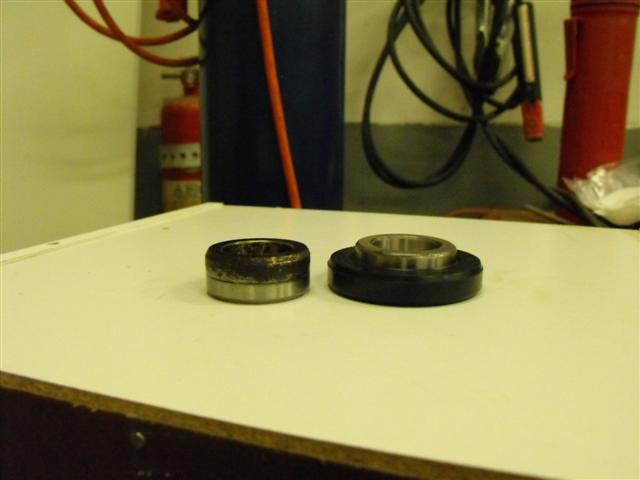

Success! Finally got the brake housing out (and most of the differential too). Found the cause of the oil leak. The seal collar was slowly corroding until if finally got to the seal surface and cut the seal. It wasn't leaking until I overfilled the tranny and then I guess it couldn't handle being submerged in the oil and started acting like a pump when the shaft was turning.
The little black line on the old collar is part of the seal surface ground away. Now I just got to get the old bearing out and the new seals and o-rings installed and hope I can remember where all of the parts go back.
Oh yea, still got to deal with the stuck axle hub too:confused2:
