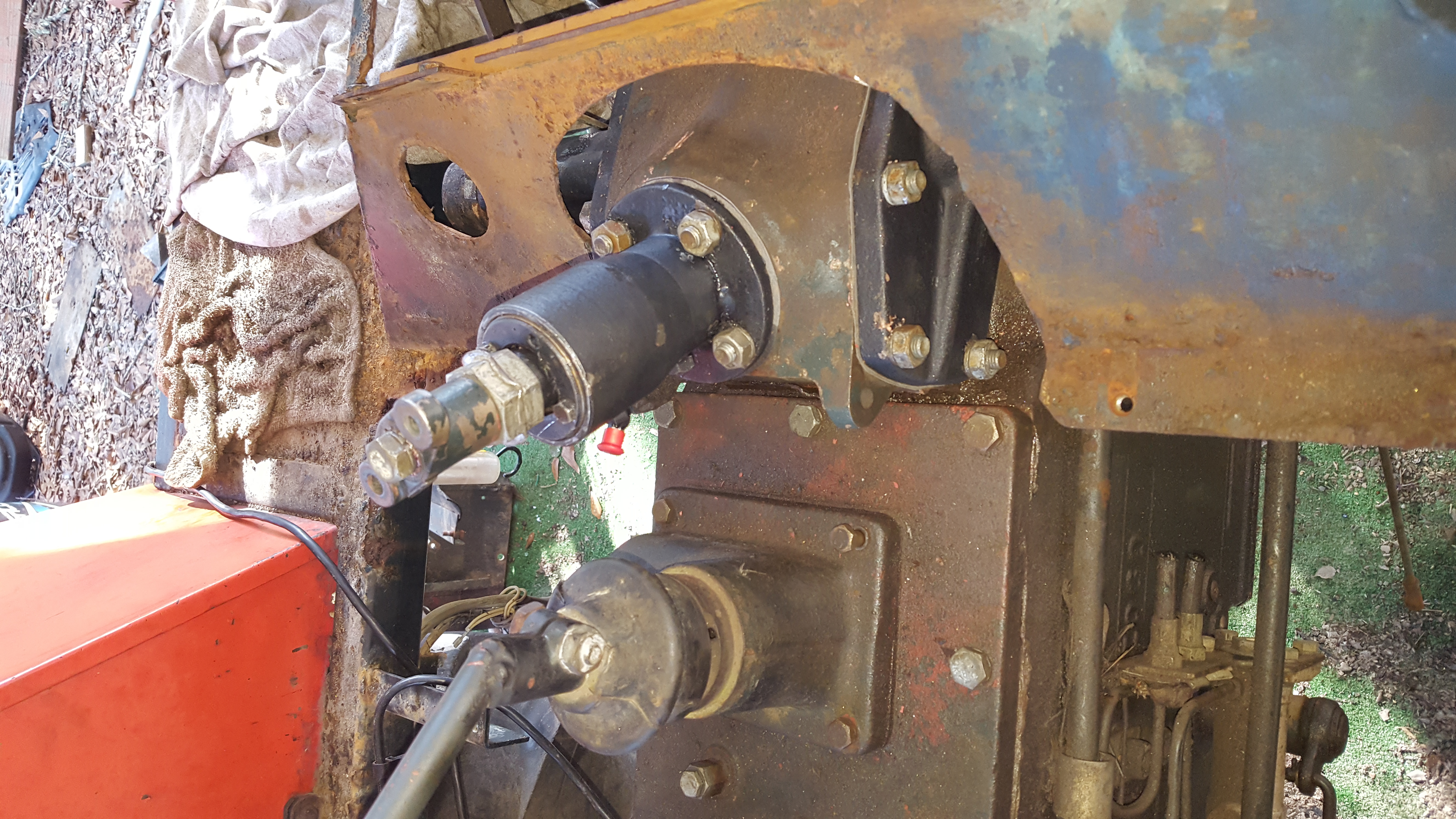

also drain and refill the steering box while its down.

Hi Mike, can you elaborate on draining the steering box for me, I am not sure what you mean. I am very proactive at preventative maintenance and look for any oppty to avoid issues and prevent wear and tear and this 5211 is new to me.

dont have a pic of the drain and fill points, but do have a pic of the strg box, its an integral part of the upper trans housing, 90 weight hear oil is
whats needed, if it gets water in it often then the input shaft seal is leaking, old timers would fill it with grease using a grease gun [ band aid repair ],
i rebuilt mine and filled with 90w.
the crossover tubes in the box are NLA.

the above pic is the right side, the drain and refill points is on the left side, the correct pic is below.
