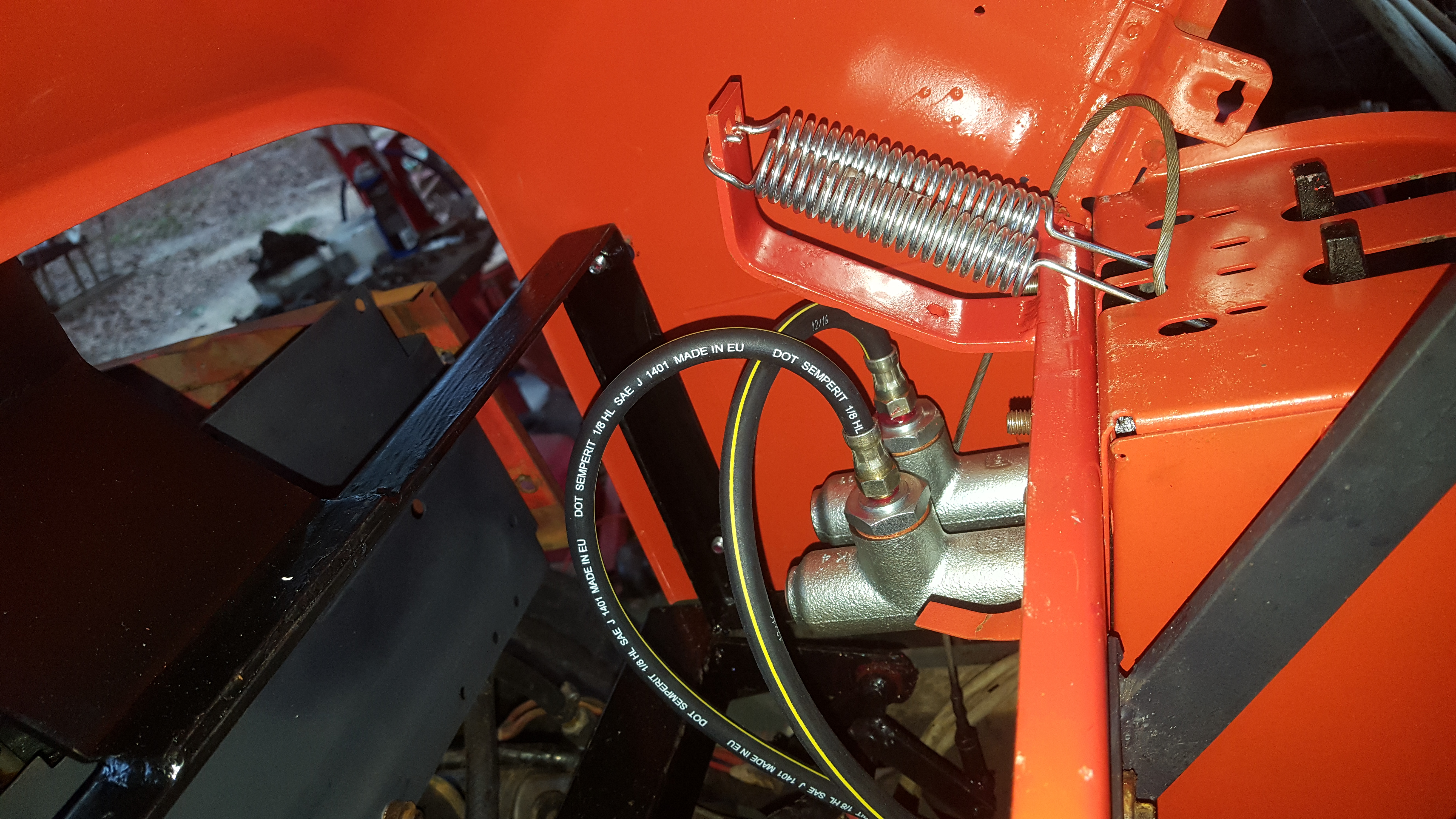

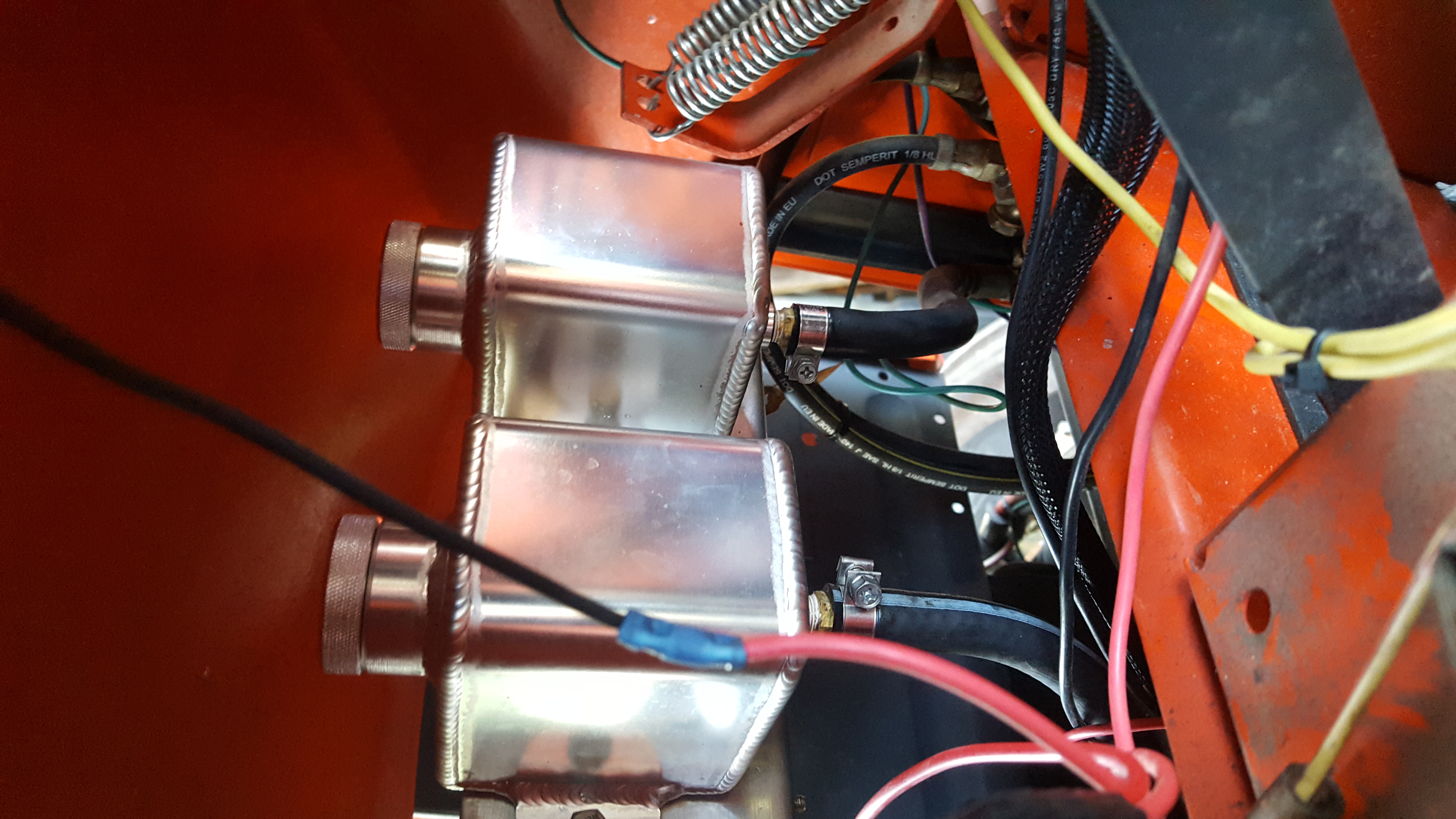

/ Brake master cylinder 1 or 2? #5
i have been improving mine through the time i have owned it, here u can see i separated the reservoirs for the brake and clutch cyls.
Good idea to help determine where the source of a problem might be coming from. Nice little reservoirs you have there.

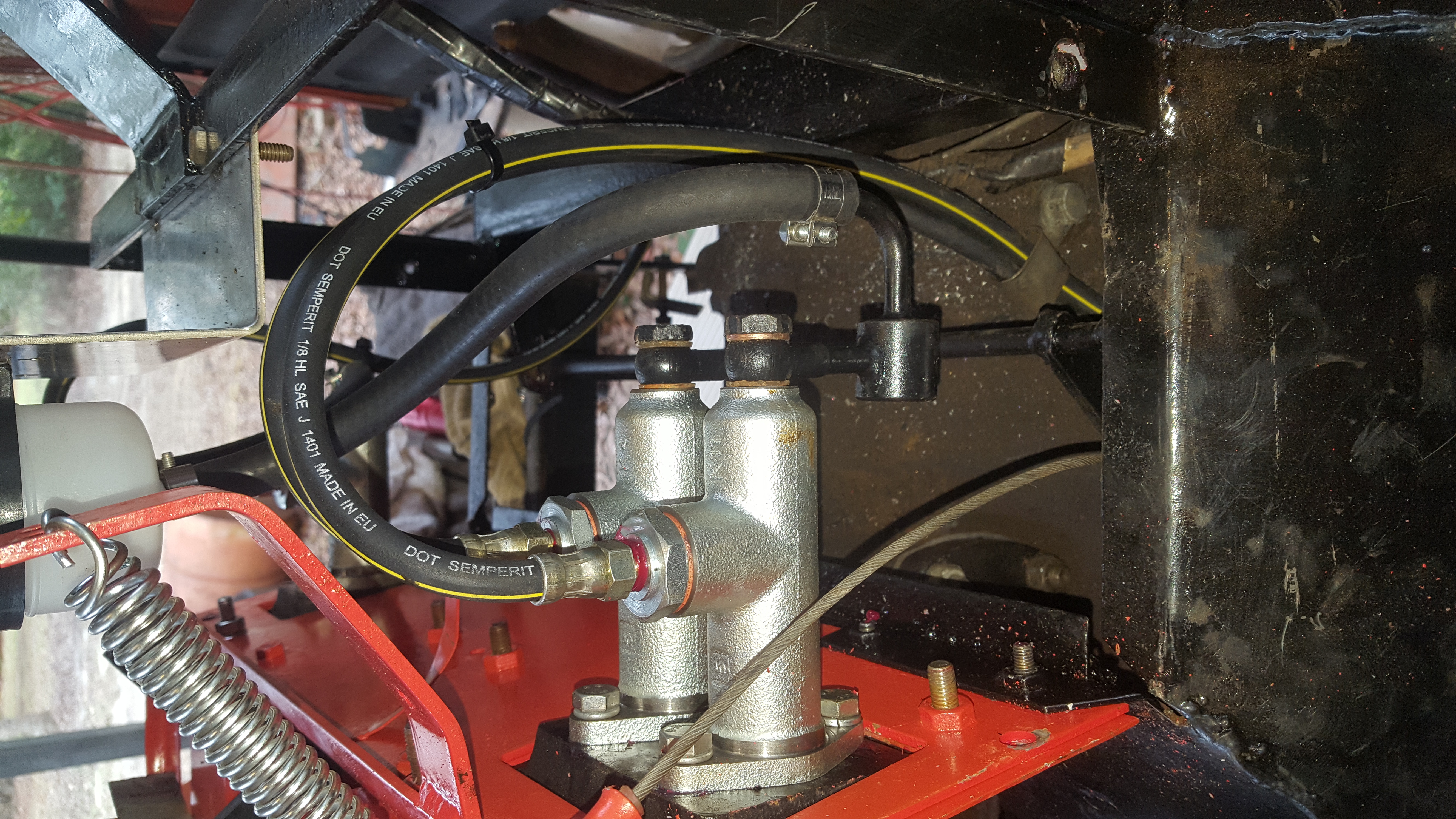

/ Brake master cylinder 1 or 2? #10
the parts manual has the pics, u must have a fel mounted to ur 5211, here is a couple pic that may help.
#11
Thanks Mike the pics are a big help. I see the cover I am in the process of removing is already off in your pics.
Appreciate the info.
Neil
