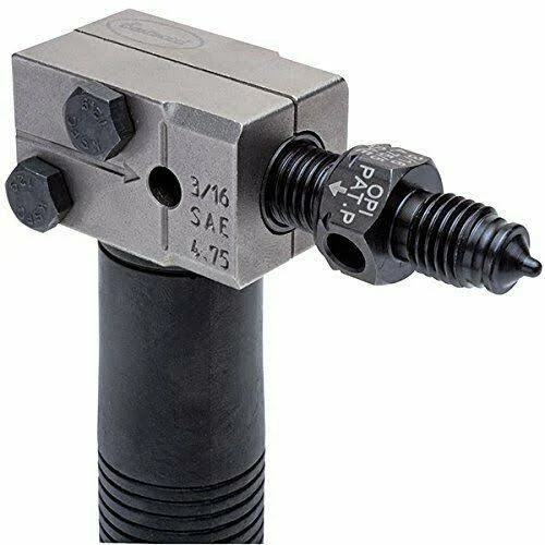

You would not get those results with the Eastwood on-vehicle tool.
Is this the Eastwood on-vehicle tool your mentioning?

It looks like it.
Yeah, that's the exact tool I bought and used for this job, except it's re-branded as the Titan 51535.
So yes, I did get those results using the eastwood on-vehicle tool... I'm thinking it was the Ni-Cop and not so much the actual tool though since it worked perfectly on steel line every time I used it
I have never used "Ni-cop" for anything, so can't comment on experience, always steel or CuNi. My limited knowledge of metallurgy tells me that nickel as the main alloy is going to make the tubing less malleable.

Yeah I might go that route if this ends up not working...
I bought a prefabbed line from O'Reilly's (BH2201317A) but the thread on one of the ends of the line is incorrect even though the O'Reilly's website says it fit's a 2012 Ram 2500 4x4. Went to put it on yesterday and only 1 fitting was correct, so I figured I'd cut it off, put the old fitting on the new line and re-flare it... which didn't work out due to the el cheapo flare tool (which is being returned today)
I wouldn't mind having extra line and a good working flare tool in the shop so next time anything like this happens I can fix it and not have to make a run to the store or wait for parts to come in

Inline flaring tool is the answer , I recently purchased one , I have 3 old style flare tools , want to buy one ?
Another tip , only use NICOP tubing and never look back . E careful on imposters , magnet will not stick to NICOP , it will stick to copper coated line .
