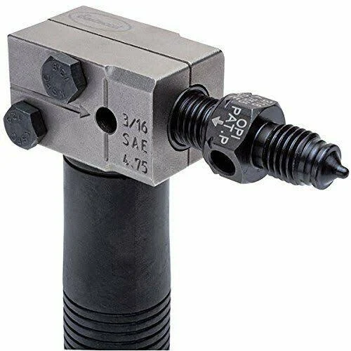

I'd had a few but have been happiest with my Eastwood On Car Flaring Tool for 3/16 Tubing

I will say that none of the other flaring tools can consistently make perfect double or bubble flares every time like this one. I have it, and haven't used the other ones since I bought it several years ago.
Cheaper non-Eastwood version for 45 degree flares only.
