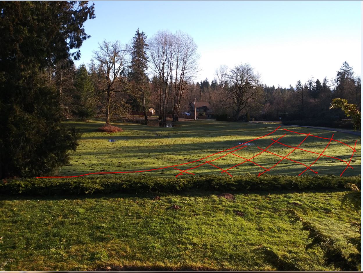

I am buying 1025R JD next Saturday. With mower and front loader.
I have VERY uneven property. It was never properly graded and is what is called "natural grade". Equals to basically waves on lake during mild storm type of surface. Bumps, valleys, puddles of sitting water, runts from rain. It is absolutely torturous to mow, it's so bumpy.
Unfortunately, lower, worse tier, is "face of the house" 3 acre, so I am trying to upkeep it well.
Now that I am getting into tractor business, I am all for slowly regrading it.
I know that I can do some with front loader bucket.
My questions is:
for grass, clay type topsoil, to level all those humps, do I better off with grading blade or scraper box?
Here's pic of what I am talking about. It is not serving well as very detailed description yet, you can still see humps and valleys. Puddles are abundant but it all dries out a bit towards mid May.Upper tier is dry and a bit more level, but still quite uneven.
20181224_094140_HDR.jpg - Google Drive
Plus, I have in mind some upper tier re-grading, to change shape of current layout. We have some useless level transitions running across the entire property upper tier, I want to make it more appealing. So, that type of grading will be involved.

You may end needing both.
The grader blade is more versatile in doing assorted dirt cutting, moving, etc. A box blade is less versatile in overall dirt work, but, IMO, is superior at leveling, breaking up ground (think rippers), moving material, and finishing.
The box blade is, IME, a slow attachment that requires patience to learn best fore/aft pitch to get it to cut, spread, and finish well. It requires patience.
Reality is, the grader blade requires patience to learn and use correctly as well, but is not as big of a learning curve as the BB.

That will be a lot of work, turn everything under then buy a laser and start moving dirt, buy soil scoop for rear that way you move two loads at once. More of job for a bigger machine. I hired some guys that do parking lots but you will have turn it under a month before they come in. They were fast and got flatness and pitch perfect, they has laser sensor on the dozer.
/ Box scraper vs grading blade #4
How about adding a couple of removable skids to scraper and it can function as both box blade (skids attached) or scraper with skids removed.... IF you don't need ripper teeth you can probably get by with scraper with skids...

Pretty place. You also have option of bringing in dirt to fill the low spots and which will be less mess and easier I think. I agree big job and bigger equipment will provider better leveling. A tiller might be good to loosen dirt to level it. If you have "friends" with equipment you may want to have yard leveling day.

I am in no rush. Small steps are fine by me. Basically, I need to take tops off and fill low areas.
there is a caveat to this. If you look at the pic and draw roughly a diagonal left to right corner, left being upper corner, what will be left on the left (Left again?) hand side is wetland. Where the tree and "pond" are. They are really not allowed to be disturbed. I have worked hard to get good standing with neighbors, so it's more one of those "do quiet yourself" jobs.
Land plane is awful expensive to buy, though it does make sense - for the job. But even manufacturer says that it is rather a narrow task tool that is useless for anything else. $1200 for one time job is a bit much, unless to sell after done.
I think, I'll loan tiller for the upper, more level tier. It should do the job "as is", as it's not really that hillocky, as the lower tier, more of various low bumps. It should take me a day to simply till it all and just let be.
Lower though.... I'm afraid, it's box scraper slow "topping", with dragging soil into low areas. As I said, I am in no rush. Weekend here and there. I have about a dozen of major "hills" that need to be taken down and dirt filled into the low spots. Thereafter, it becomes tolerable, considering that my JD will have mower.
I had a guy hired with JD tractor and tow behind mower, looked like 54 inch deck. He did entire low tier in about an hour. My Hustler with 60 inch deck takes 2.5, if not more, hrs, as I have to move it very slowly over the runts and hills. It may turn out ot be quite ok, if I simply shave the hills and move that dirt into the low spots. Even as is, it's the best looking lawn in the area.
Outside of doing a project like this, is there any other use for BB? I have asphalted driveway and no real gravel work else...

That is going to be a heck of a project for such a small tractor over such a large area. The fact that there is already turf makes it a much harder project. Normally a box blade is better for grading as it accumulates material and can move material from high spots to low spots. But that won't work on turf -- will need to all be stripped off first, then if you're lucky the soil will dry out in a few days/weeks and be workable.
Some people might go at it with a tiller, but then you'll have chunks of turf mixed in with the soil and you can't grade that very well at all.

That looks like the low spot of the area when, it rains is that the last place that dry's up? That would explain its rolling nature. It has the makings of a bog. Which means you've got to find some place to send the water too, because if it holds water it will end up being rolly again.
If you have no place to send the water to then you need to turn it into thicket with tall grass and not try to make a lawn of it. So if you want a dry lot you need a lot of fill.

Land plane does not have to be expensive, just make one.. Couple of side rails to float on ground with "blade" suspended between...
I use a 4-5 foot section of railroad track to tow behind tractor to "level" gopher mounds and smooth out area where I have worked ground to death with tractor and its rough and uneven.....
If you gently scalp top of bumps and let it go into hollows and do little bits at a time eventually will have contour you want...
Try looking at GOOGLE Images for "homemade land plane" for inspiration...

If the area doesn't flood that will work, but if it holds water it won't last. Because that's how it got that way.

picture large rolling fields you'll find areas the farmers never clear and never try and plant in, the bogs. Unless you can drain the bog you leave it alone. Or call it nature's retention pond. In Florida now they are declared wet lands and are protected because of all critters that need the water. Our pine tree stands are littered with small bogs that have ponds that come and go. Get plat map of area and check the elevation of that piece.

WoW - that's a beautiful pasture. If it were me, I'd be very happy and just leave it alone. You will be a long time attempting to level/flatten with your new tractor. It's going to take a large piece of equipment to do that job.
Even my Kubota M6040 @ 10,100 pounds and my 1100 pound Rhino rear blade would have trouble with that land- because of the sod.
That pasture will have sod as the top layer. Anywhere from 4" to 8" thick. It will not respond well to any type of leveling activities. You will end up with ginormous rolls, wads and clumps of sod. If you were to bring in topsoil and fill the depressions, that would be the easy way.
If your plan is for one big smooth continuous pasture. Better find somebody with the equipment to chop, pulverize the sod and then start the task of regrading the entire area.

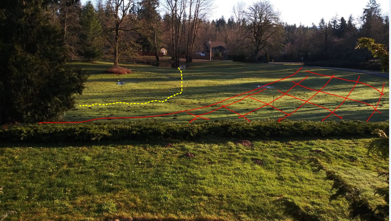

I'd be happy to leave it alone myself - except that it looks like crap if not mowed and is VERY hard to mow thereafter. We just closed on 3 years in the property and year one, it took me 3 month to get through it all. Including weed whacking and scythe use. grass will get regular riding mower engine cover height. plus, most of it is some sort of very thick blade clumped grass that likes wet areas, it's basically mowing 1/8th thick tubes, clumped into 6-7 inch thick wands.
Pretty it is but killing to maintain.
Also, you are allowed to bring only 500 yrds of topsoil - once - in but you have to buy permit to do so. Then you get under county radar.

That's all I can legally grade, or fix to reasonable condition, in that beautiful meadow. See attached. I think, slowly but steadily, taking hill tops off one at a time, will do the job. Like I said, I am in no rush.

So be it known, I actually listened.
I decided to go with 30hp tractor. I am assured it will handle 48 BB just fine. Now working out who to go through. SO far, JD has 31hp with mid mount mower and others don't.

corrected.JPGFrom the last pic looks to me like that meadow is drainage area and from your description of what is growing there you should not be mowing it. That thick grass's job is to evaporate water and survive when covered with water, grass can't do that. I say that hill you want to flatten was put there as a boundary. So don't know if you have lived there long enough to know how wet that field stays on a rainy year. I bet after a heavy rain that field stays wet much longer than elsewhere, that because the high lots are draining there through the topsoil.

I understand trying not to raise red flag with the government but think you need to find someone who knows the rules as it would apply to your land. We were told there is some filling of wetlands on a home site by the county itself. Now I know there is limits to what can be done on a house site with the wet lands.
I have read each post since my first one and think each one is correct in their concern about you grading with sod establish on it. If you are going to do it with your tractor spray with round up (or generic) at least two months in advance of working an area so it dies and is rotting before you hit it your equipment. Also if you decide land plan is way to go or any other piece of equipment buying used is often a smart idea. If you buy a used land plane or other grading equipment right then you should be able to sell it near what you paid for it when done.
When you were talking about another person cutting it with tractor and rear mower...if that suits you when not buy a rear mower (rough cut or finishing mower which suits what you are mowing) and use it over a true mower. Larger wheels on tractor will handle rough or ruts much better than smaller tires of a lawn mower.
