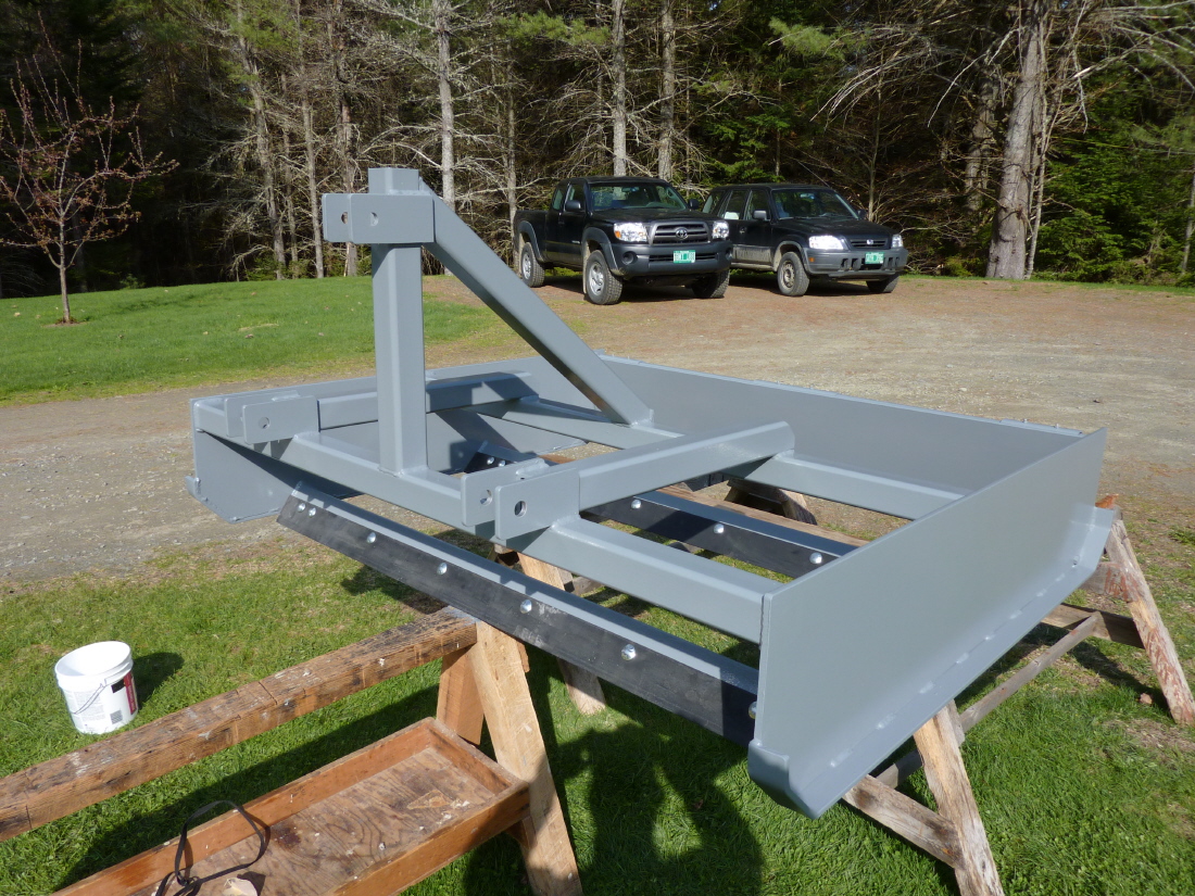

Thanks for all your help, guys. Much appreciate your pictures and advice, i tried searching nz trading site for 'box blade' and all you get are boxes of blades! Got a cheap grader blade though and got the crown back, now time to get welding. Hopefully the OP learned as much as I did about roading DIY.

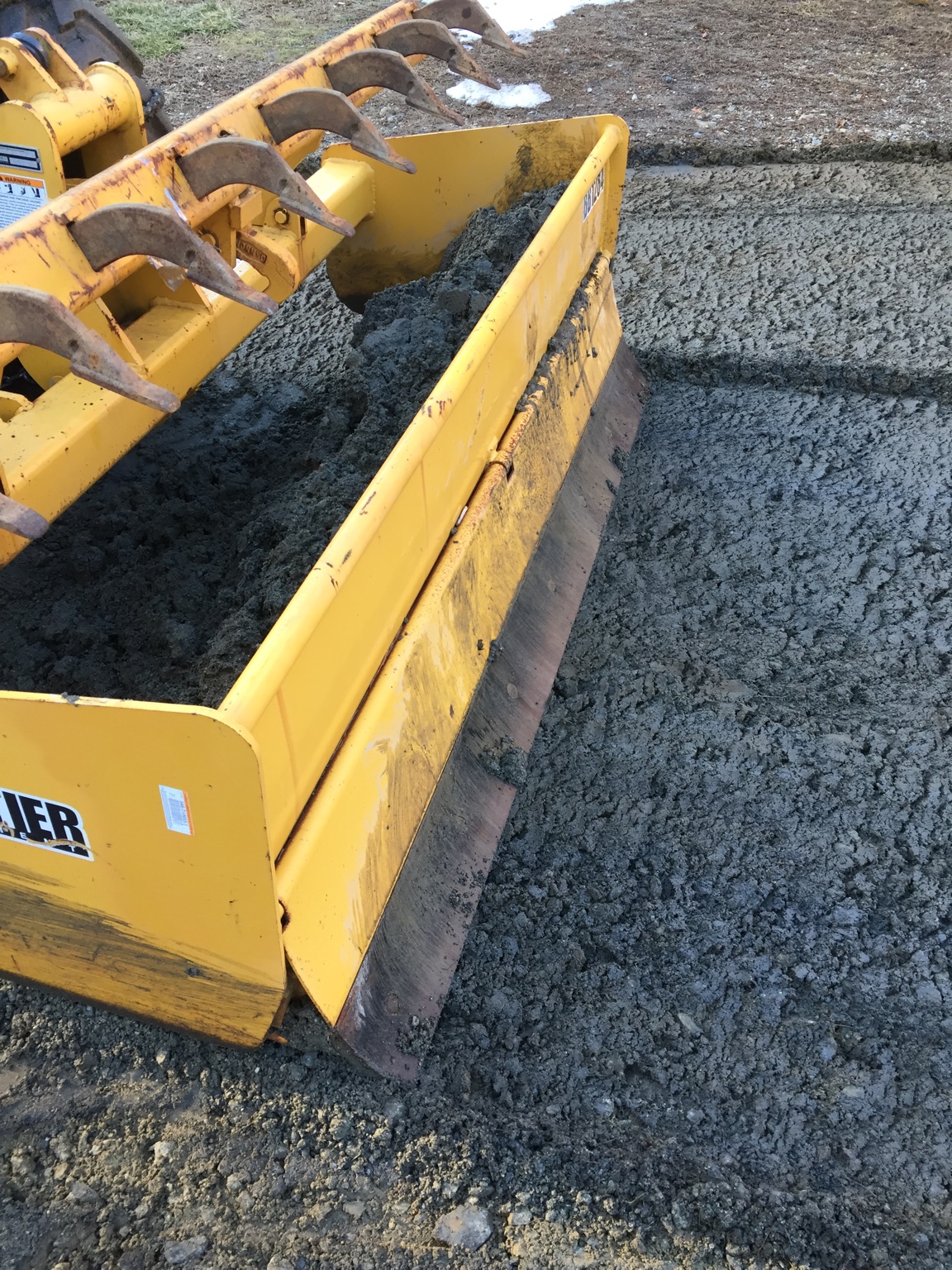

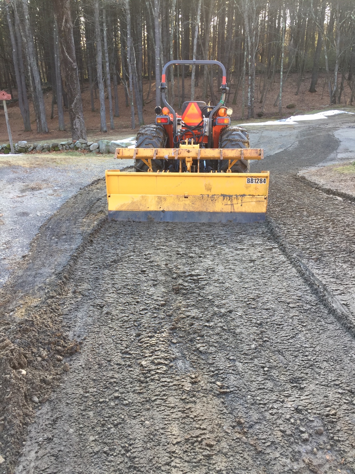

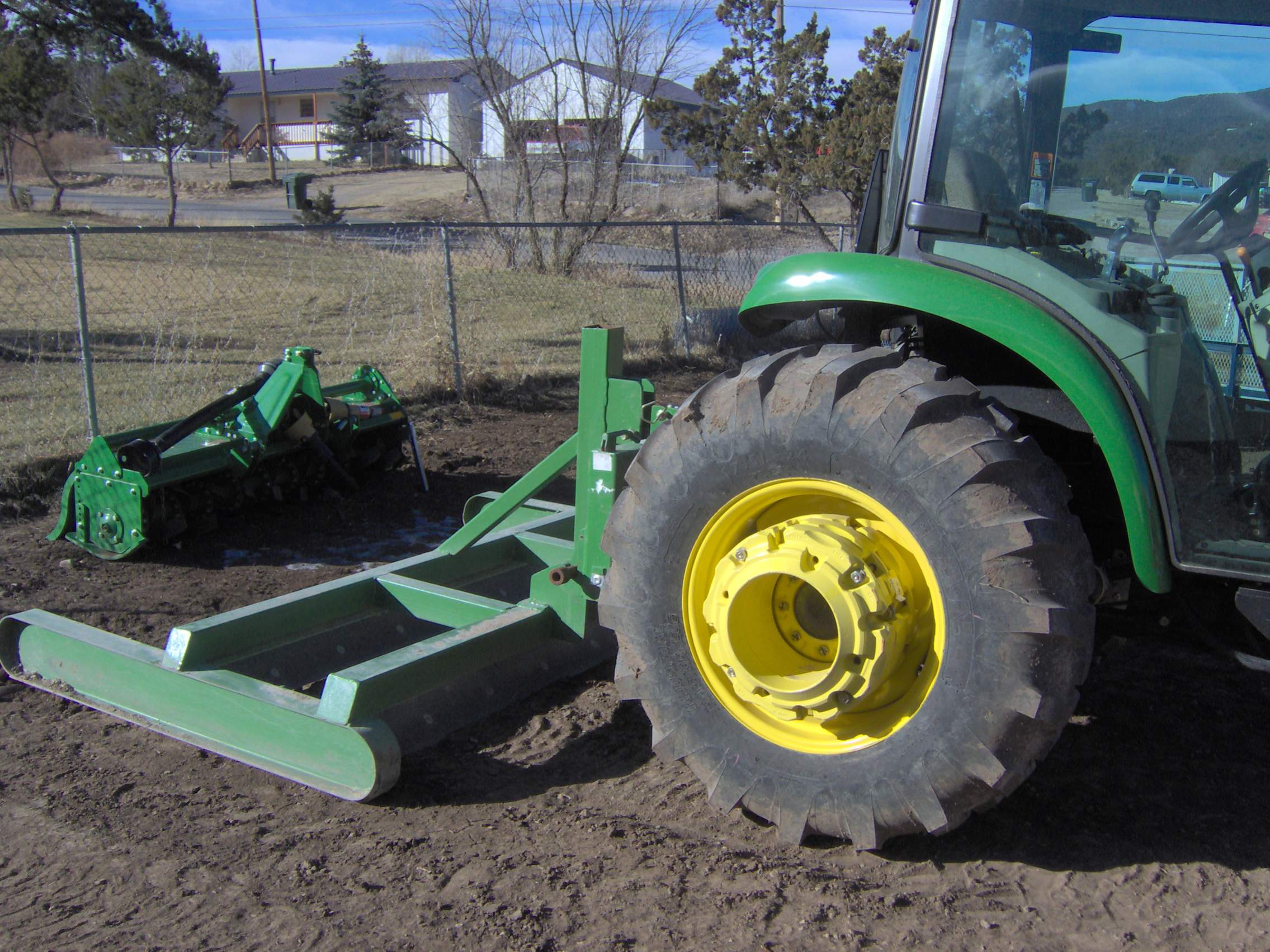

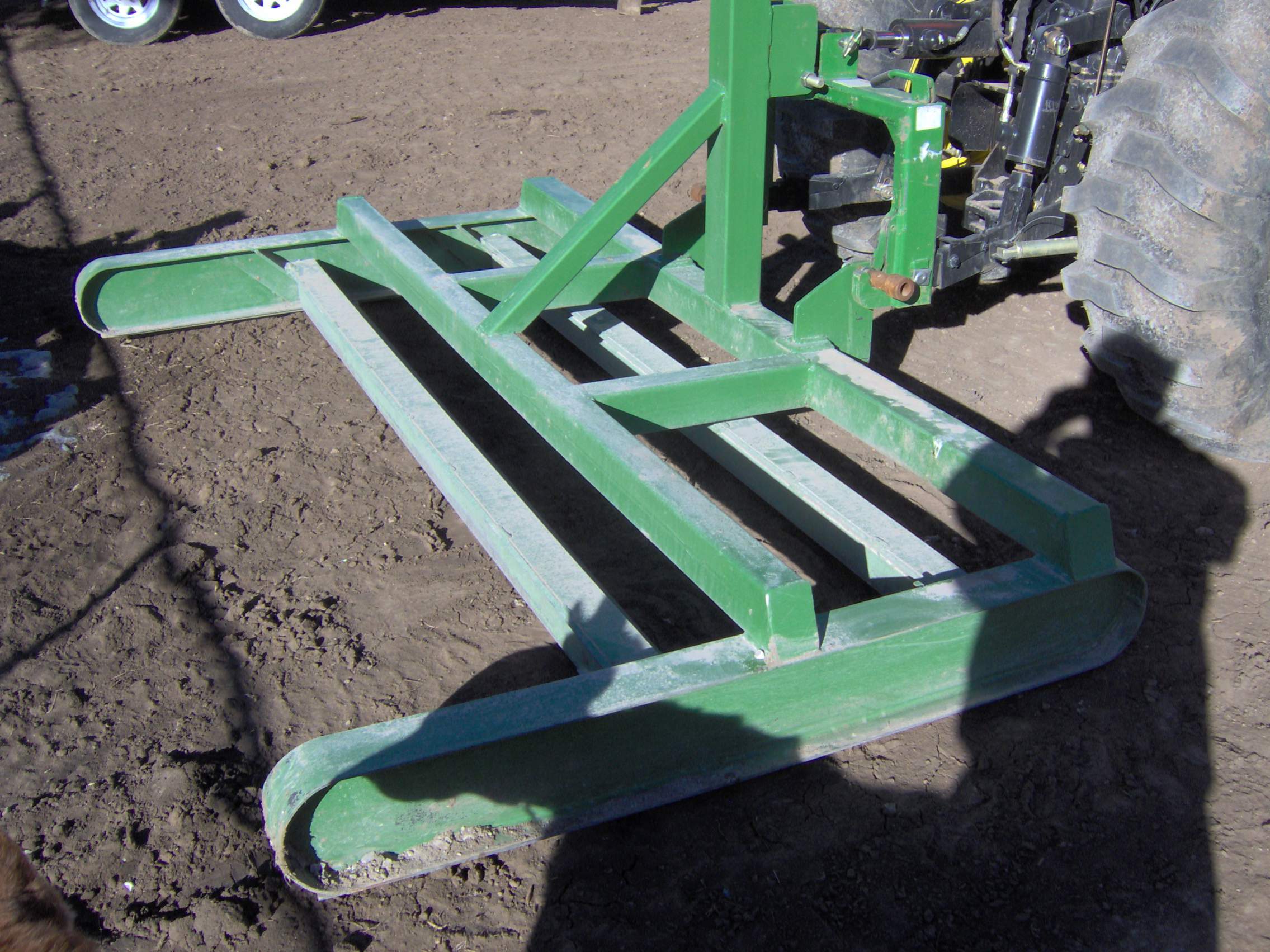

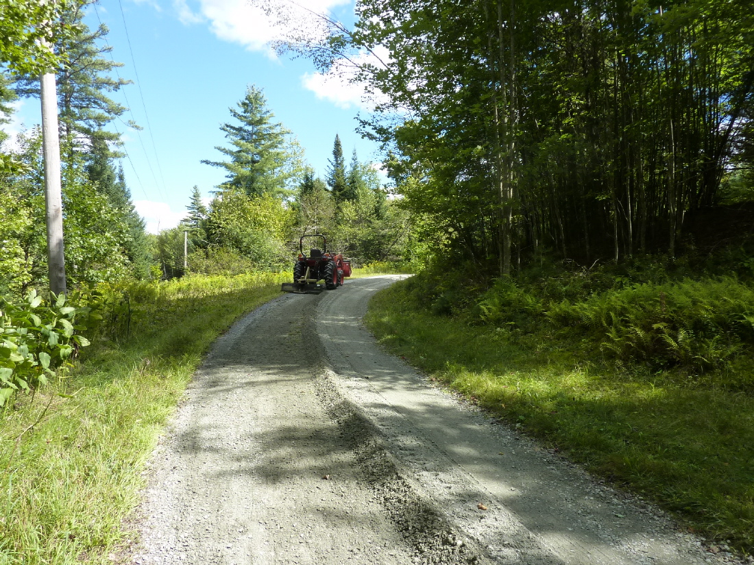

I have quite a lot of road to maintain. Up here we have frost that goes down 4 feet, sometimes five feet. So in the spring the entire ground gets saturated with water. It has no where to go with all the frost below. So spring time roads get holes and ruts. Just can't be avoided. I divide maintenance into two general types; contour maintenance and surface maintenance. Contour maintenance is the main water control features of the road, things like setting the crown, making a flat pitch, constructing a wide base dip, or repairing a wash out. I use a rear blade for this work. Many prefer a box blade. Surface maintenance is just what it says - keeping a smooth surface that doesn't collect or pool water and is pleasant to drive on. A land plane excels at this job. But you can do it with a rear blade or box blade too, It just takes more skill and is much slower. A land plane will not remove the crown from a road unless you want it to or it is to wide for the road. It should be less than 1/2 the width of the road. Mine is 5' wide and my roads average about 12' with some wider sections. Once the surface is smooth it should be packed. I use a one ton, a p/u or car will work also. This is so you can see what you really have. Some areas may compress more than others when packed. Places where the lose material is deeper like holes and ruts. After it is packed if there are any surface imperfections it should be regraded and repacked until it is right if you expect it to be a long lasting job. If you just smooth and don't pack then as the traffic packs it for you all the holes and ruts may just reform which is a common problem.
Setting contour with rear blade.
Then perfecting surface with land plane
Packing
gg

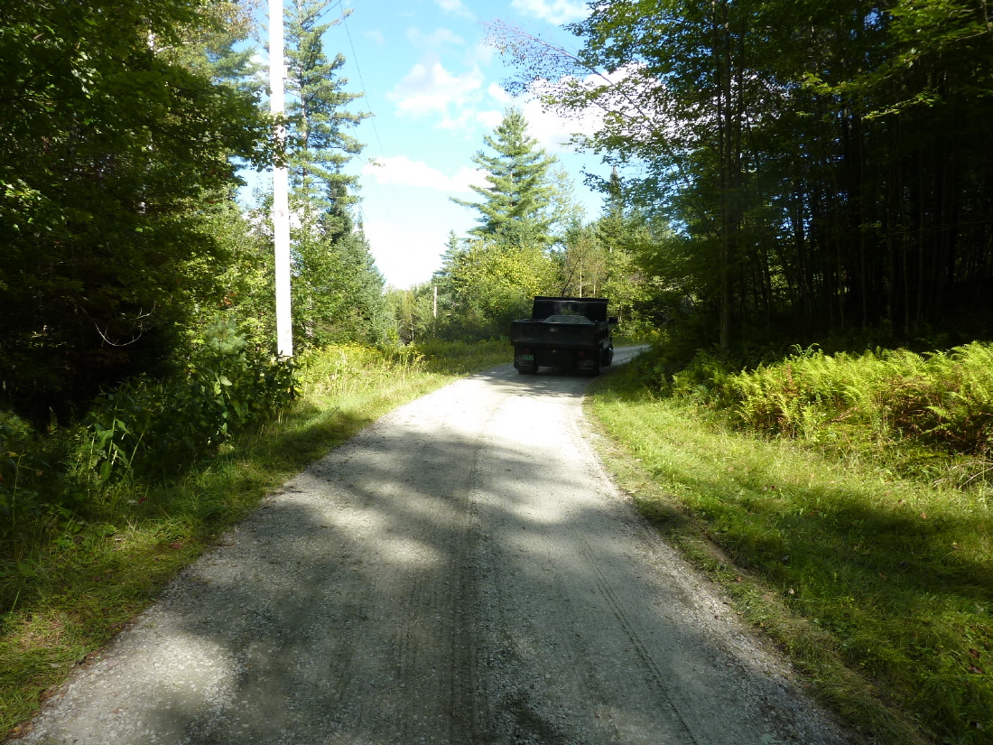

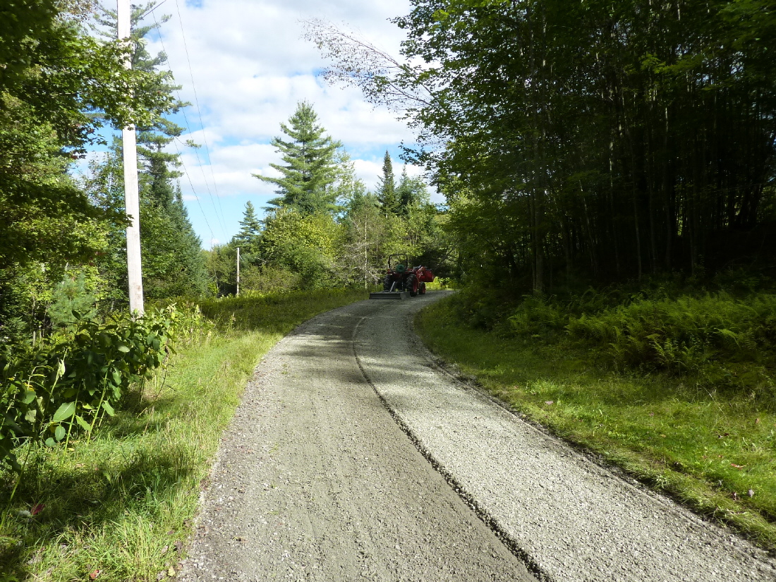

I could have written most of this paragraph in regards to maintaining public gravel roads. Problem with most of the public is they want to drive in exactly the same track every time. On heavily traffic roads during Contour Maintenance I may come back in a couple days and do it again. If it's in real bad shape I may be back a couple days later and do it the third time. By then I can usually get the holes filled well enough that traffic doesn't beat them back out. During this maintenance I work the material as wet as I can. Helps it to pack in the holes. On short stretches, mile or less, I've even driven back and forth several times with the road grader to start packing the material before high speed traffic gets on it.
Gordon, you certainly have a good mental grasp on what you are doing. You also have a deep understanding of your equipment at hand and the best way to utilize it.
Thanks for sharing your tips. And especially for the excellent pictures. If I can't understand after all this, I'm just not paying attention. :)

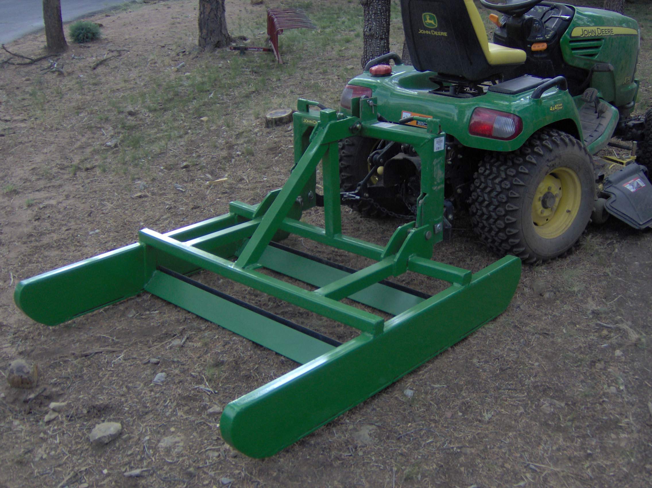

I've been thinking of making skids for my BB to make it behave more like an LP. We're building a house and really don't have the budget right now for more implements. Anyone tried that?
/ Box scraper for hard pack dirt/gravel road #51
There is one on YouTube,, so it has been done
