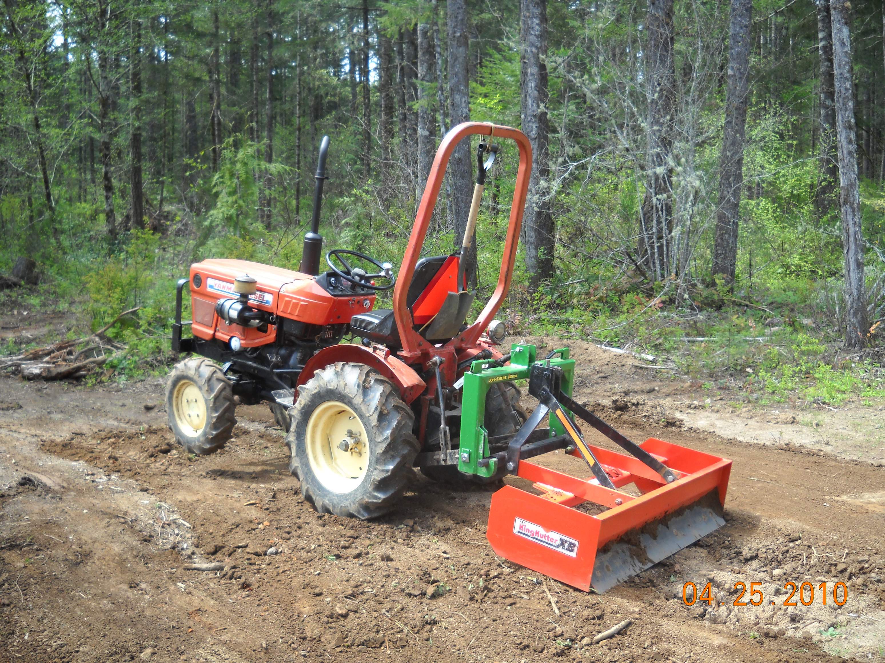

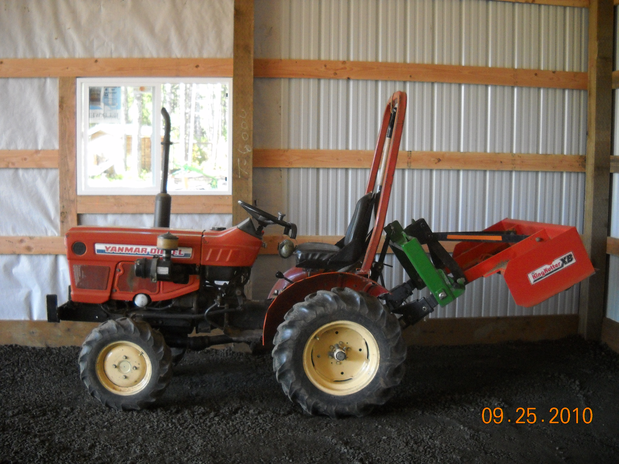

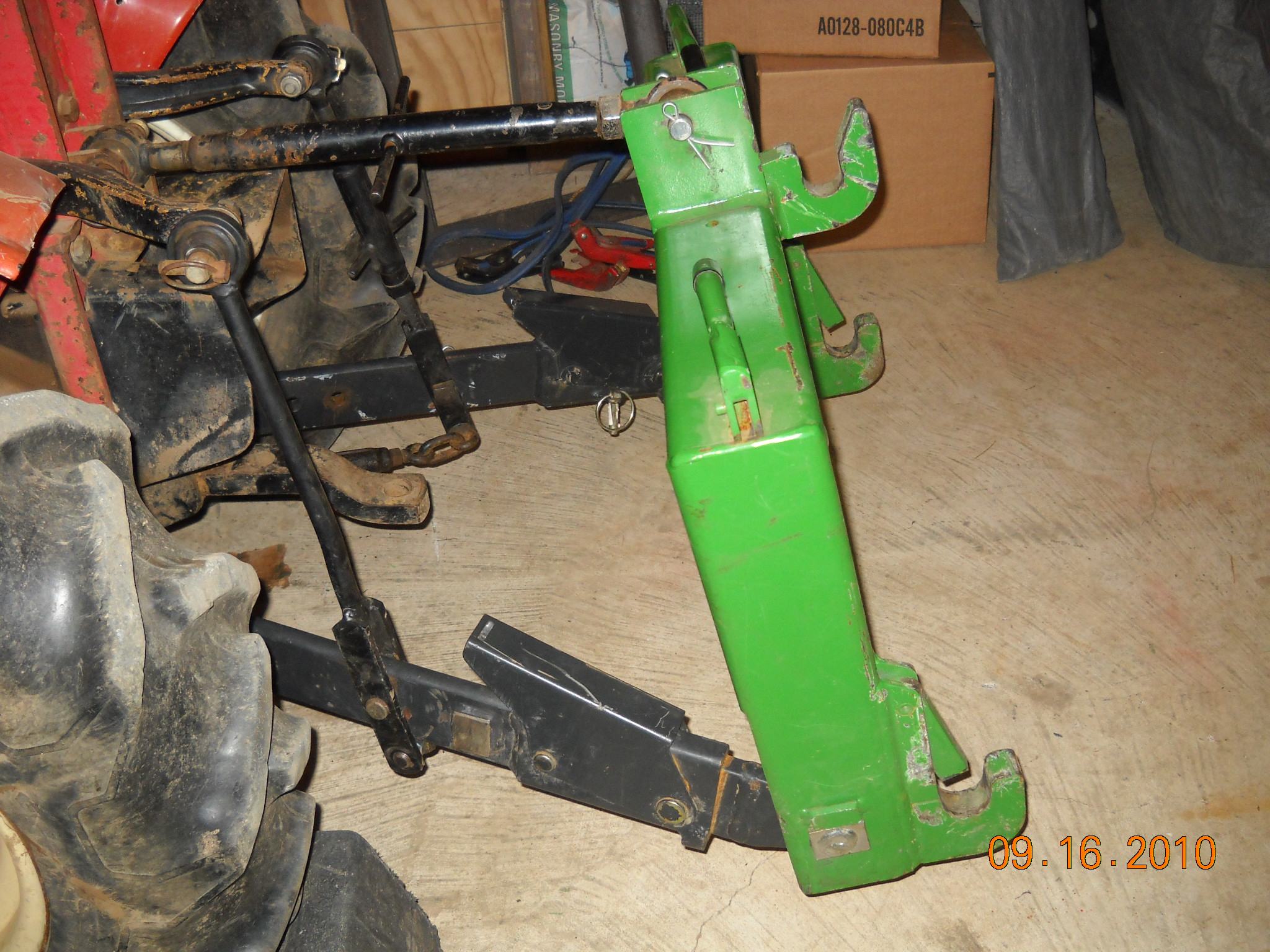

Lets see, I have a small fleet of implements but cant remember one that worked in the mud well. I have a box blade on my yanmar which pulls it easily in 2wd but I have R1 tires which are both loaded. I have 4wd as well which definitely noticeable when you fill up the box. My Yanmar is 19 hp. in your case, the box blade will work, but I would wait for a good dry spell and not use the scarifier shanks to reduce wheel spin. I also would tilt your box blade where the blade is about 2-3" off the ground and is riding on the side wall. Basically, shorten your top link similar to the picture i have posted of my 3 point hitch. When using a box blade, I never let my hand off the 3 point lift control since you will gain more precise depth control and will reduce the chance of getting hung up on an underground root or stump. In my last picture it shows my tractor hung up on a stump which was buried when the property was cleared 5 years ago.
