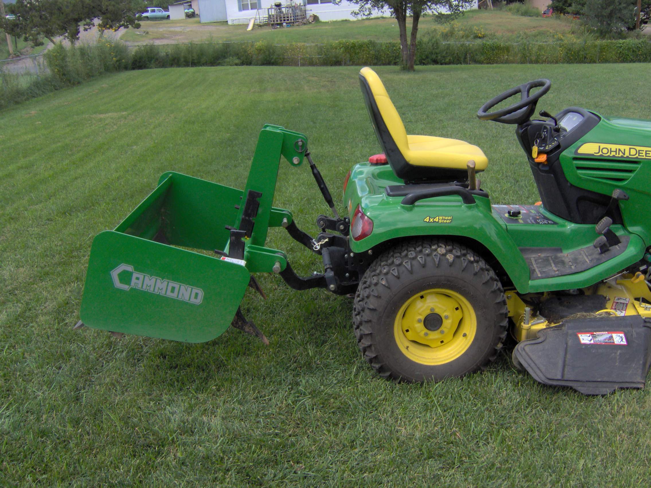

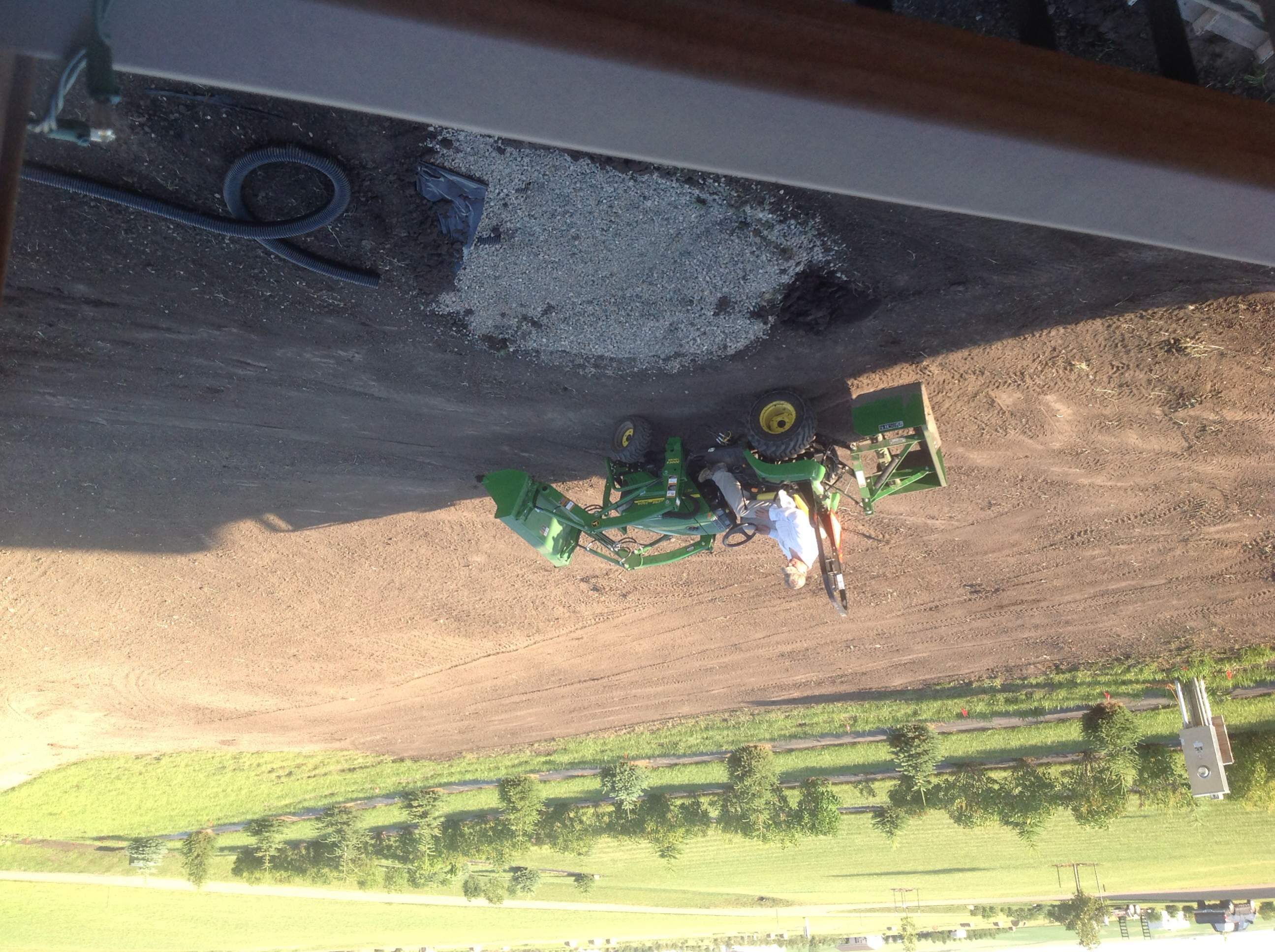

I typically use my fel to spread topsoil on a new lawn area, and back drag in float position to even the spread. I would recommend a 48" box blade or a maximum of 54". Might wan't to look at a Cammond pictured below on my mower.

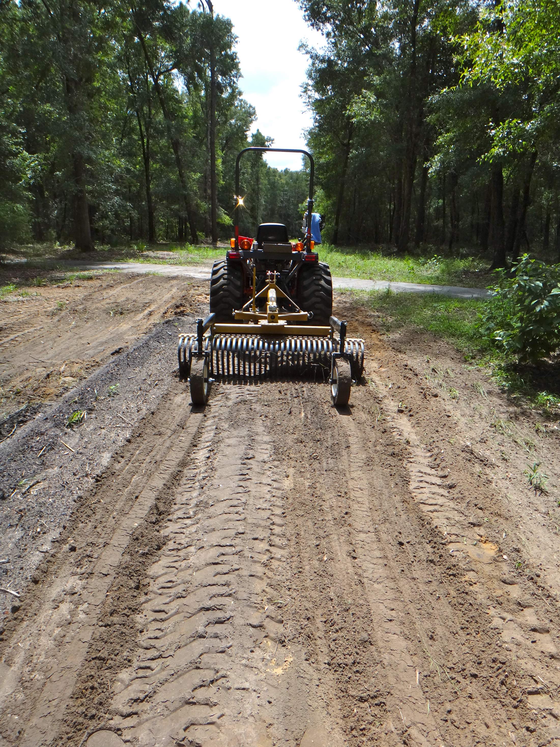

Pulling a Box Blade is high draft work. As you have Turf Tires, consider a Landscape Rake in lieu of a Box Blade. Landscape Rakes require less traction to pull. A Landscape Rake's spring tines are designed for spreading.
I have ETA's 72" Landscape Rake which I would highly recommend; not so keen on ETA's imported gauge wheels for the Landscape Rake. However gauge wheels, in the generic sense, are efficient for final smoothing without using a manual, long-handled rake in your hands.
You would want to buy a Landscape Rake twelve inches wider than your tractor tire width, as Landscape Rakes are most often used angled to some degree.
(I own both a Rollover Box Blade and the ETA Landscape Rake.)
