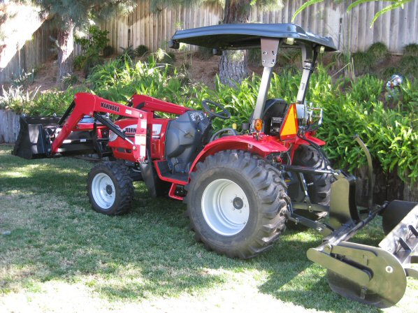

ROBB for sure, well doth that extra $500 IMO. Next best thing to the full hydraulic ripper box blade. When you add that 2nd rear remote, get the 3rd one also and get both of those with the float function.
What other implements will you be using? What types of work will you be doing with the machine?
I have ROBBs for both of my utility tractors, extremely happy with them. :thumbsup: :thumbsup:

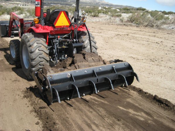

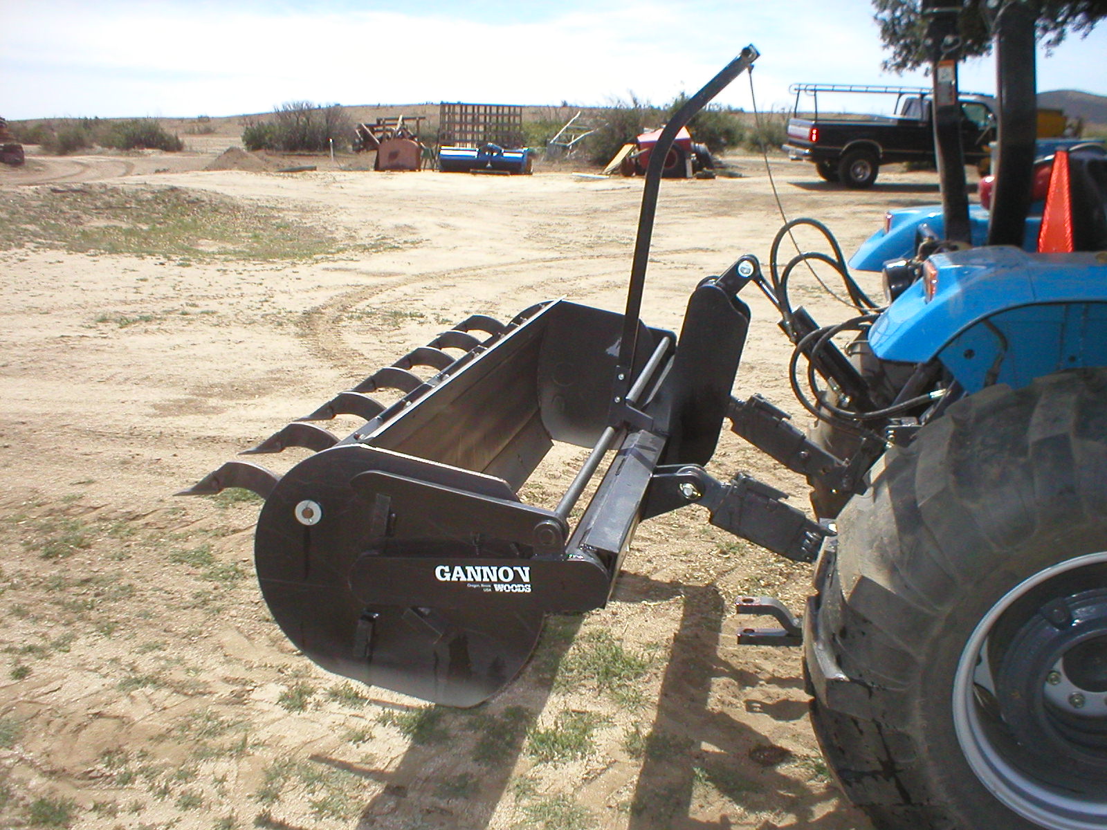

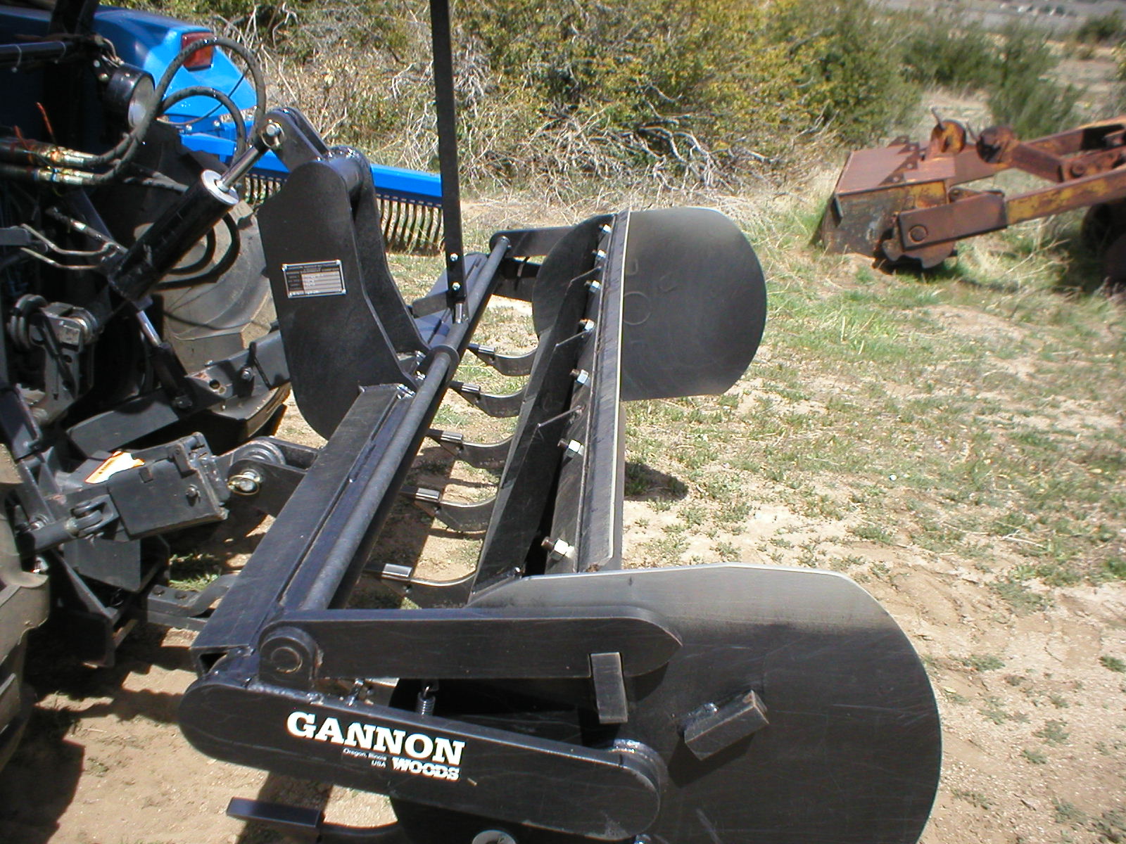

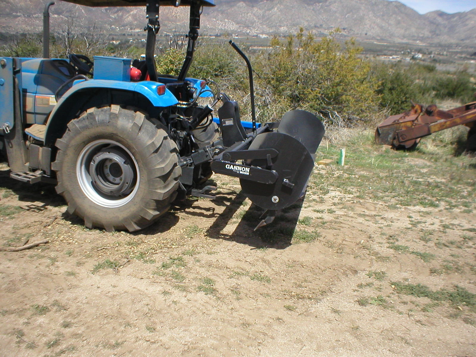

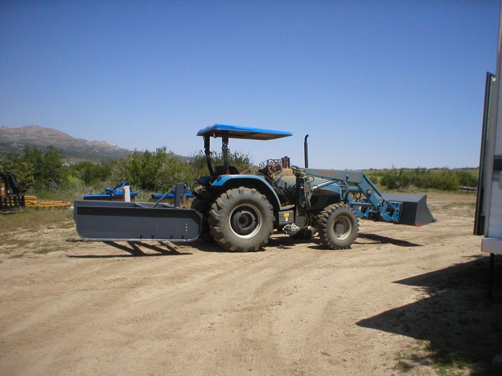

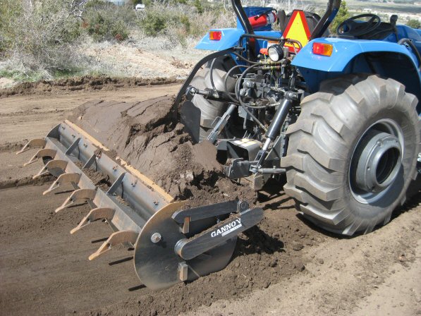

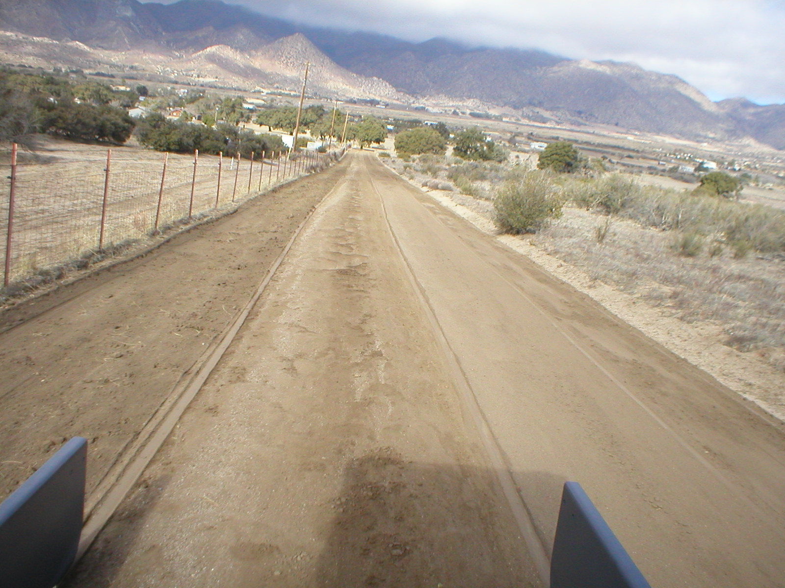

When you mention some road maintenance, just how much? You might want to get a LPGS for the road use, the only way to go when it comes to general road maintenance.;)

1/4-1/2 mile of road to maintain is nothing to sneeze at. If you want to keep it really nice and be able to do it fast, you really need to consider a LPGS. Again, just about the best implement to maintain most natural material roads IMO. ;)
