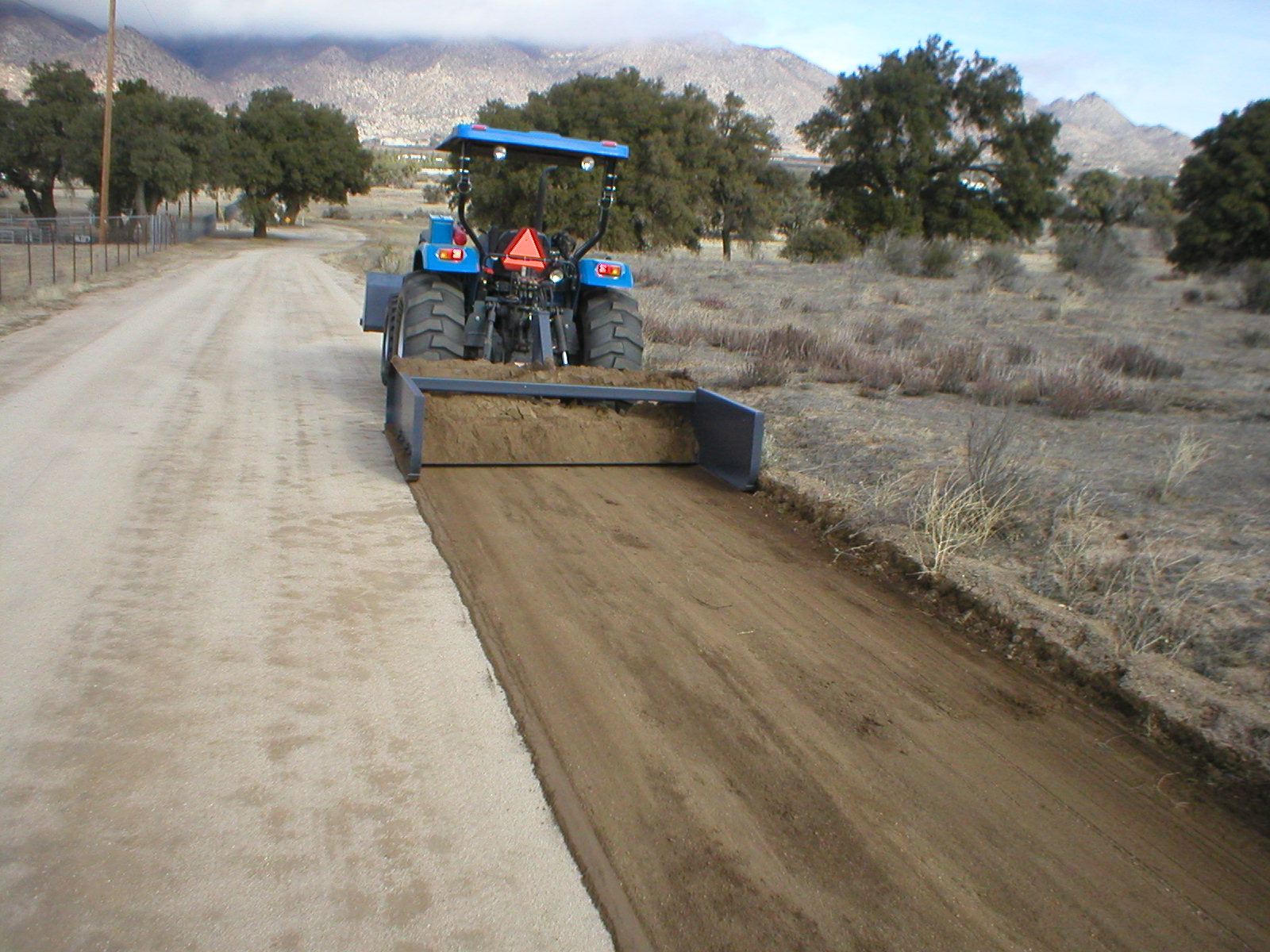

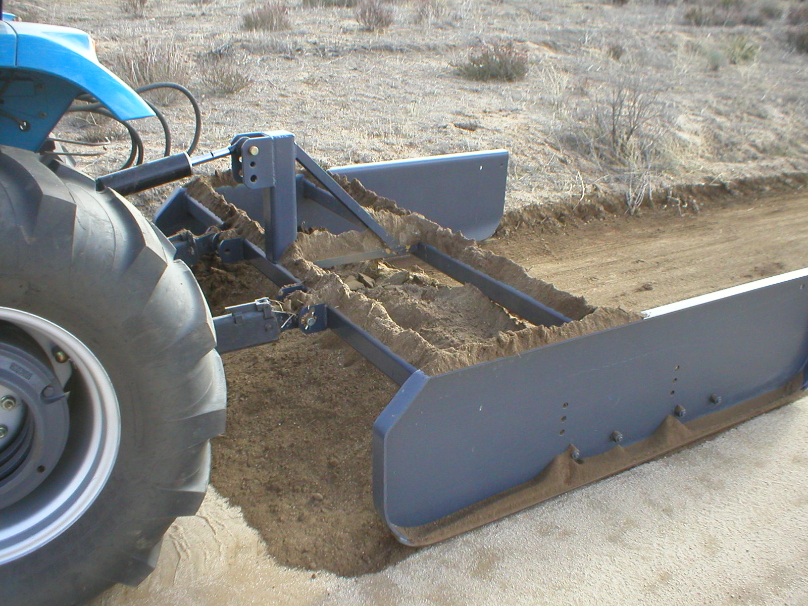

You simply can not beat a LPGS for removing wash boarding. If this is an ongoing task that will need to be done, a LPGS is the best way to deal with it IMO. :thumbsup:
Also depending on moisture content, but a LPGS can also be used to move dirt from point A to point B.
Just have to keep in mind that there is no single implement that does everything the best. ;)

So a LPGS is better than a BB & LR for removing the washboarding from my 1/2 mile long driveway? Will it work similar to a BB when trying to level high/low spots or no?
/ Box Blade #7
By far, not really ANY comparison in my opinion.:thumbsup: :thumbsup:
LPGSs work great for leveling things out. Now if you have a high spot to cut down and you want to fill in a low spot that is very far away, that might not be much fun. Remember that the LPGS is open in the back, so to actually say "I want to move this high mound of dirt to this low area 200 feet away" may not be as easy as it sounds. Now with just the right moisture content, no big deal. Otherwise probably better to use a box blade.
I have flattened out several areas that are fairly large using my LPGS. It will move over 3 times the material that my box blade does, but the dirt has to be just right as far as moisture content for it to be at efficient as possible with what I have and not making any modifications to anything. :thumbsup:

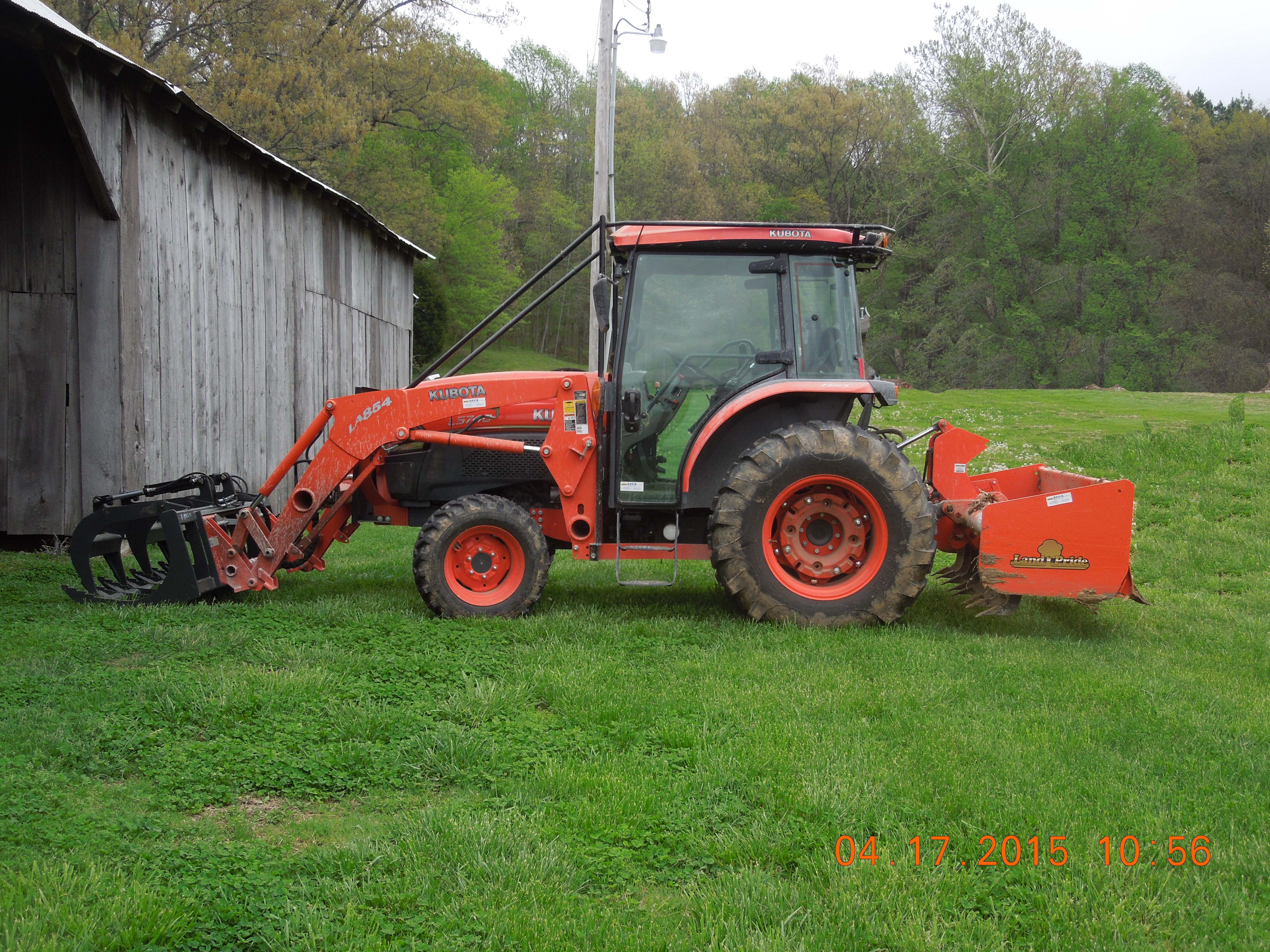

"Just have to keep in mind that there is no single implement that does everything the best."
Pretty much my experience as well, my tractor is pretty much the same size as the MX and I prefer a 7' box scraper. My HR3584 with TnT does a pretty good job, but if I could afford it, I would also own an LPGS. I've had good results with a 10' pull type scraper I've owned for years, but it has its limitations.
