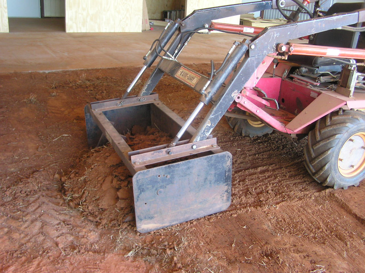

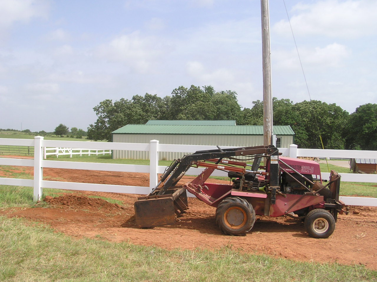

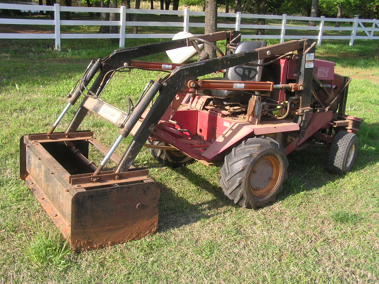

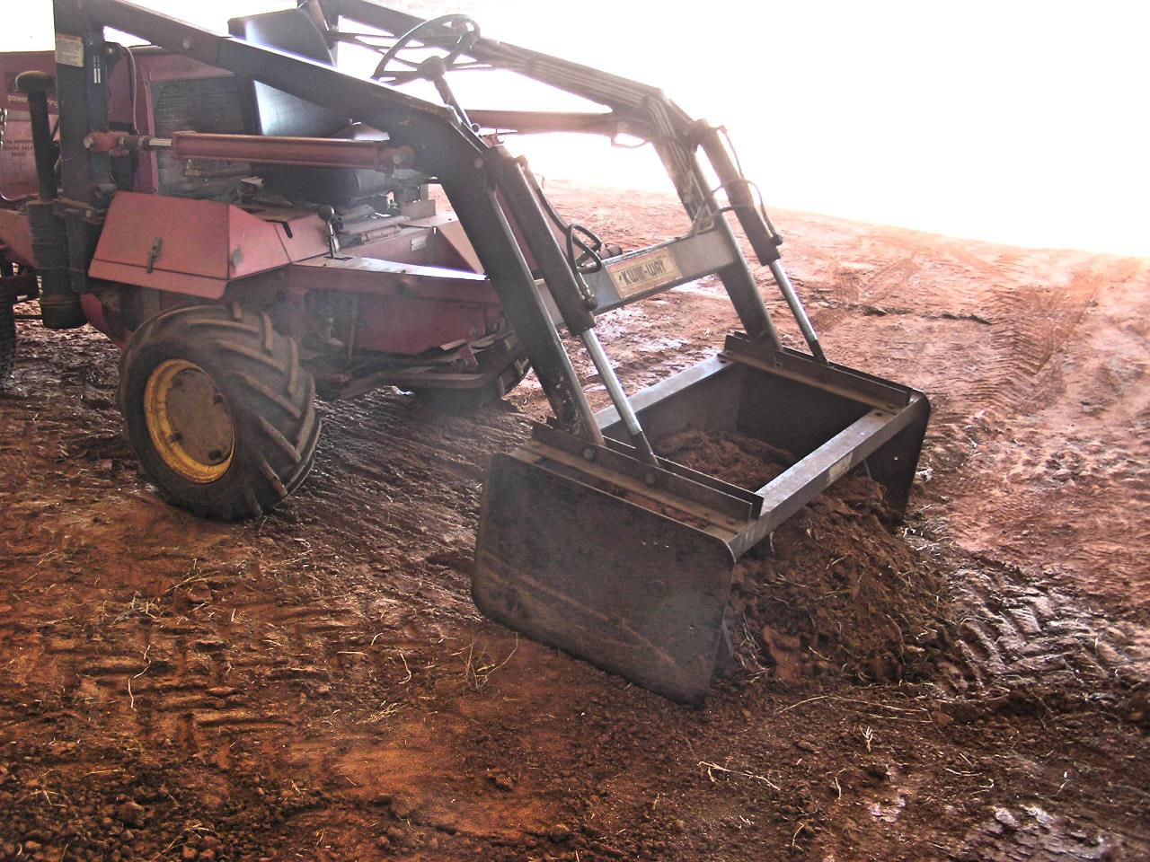

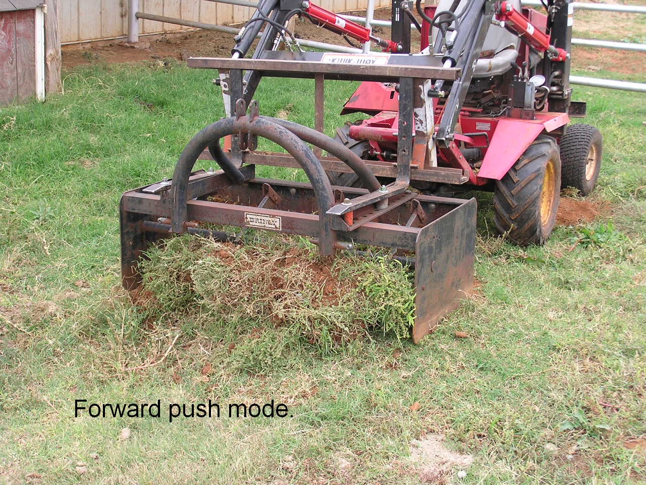

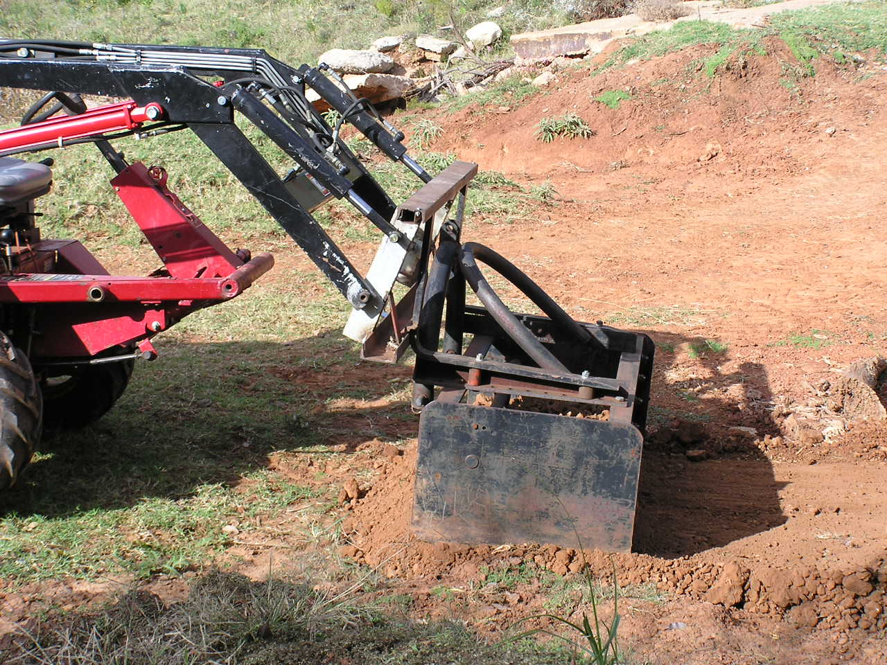

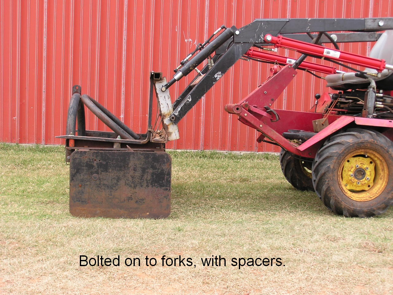

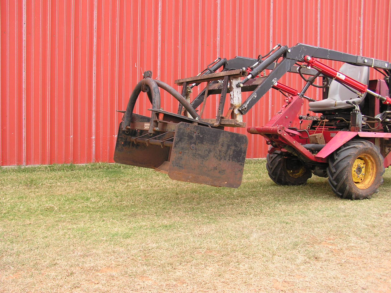

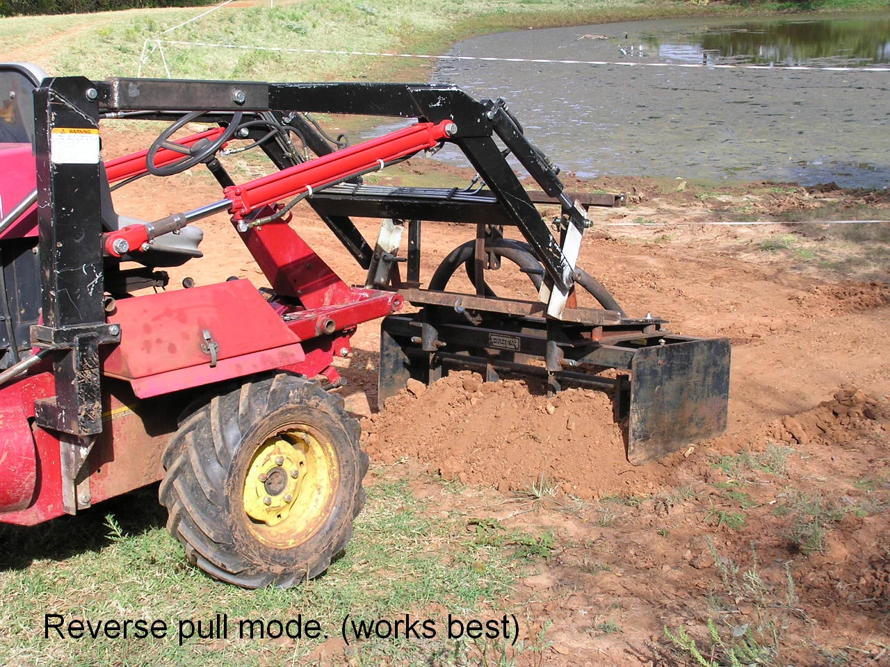

I will wind up with a quick attach for my pin on stuff from Tony at AI2. I have been mulling over the possibility of buying his blank plate, and seeing if I could weld the quick hitch from Harbor Freight to it to use 3ph stuff on the front.
That probably actually means I'll think about it but never try it 😊.
/ Box blade width? #23

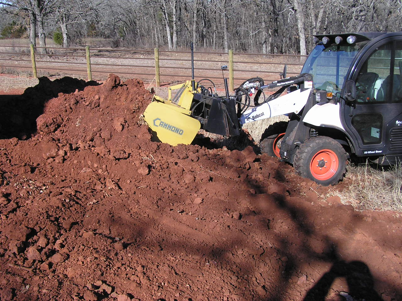

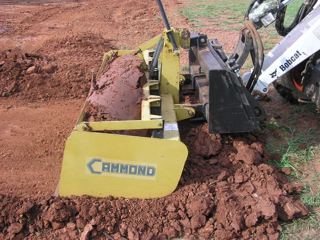

If you do, be sure to build in some extra rollback like this 3 point adapter has:
/ Box blade width? #24
I used my level indicator to help me figure out that angle. Removed my bucket. Parked on flat floor with bottom of FEL QA plate about 4" above floor. Rolled FEL until the level indicator showed the bucket would be sitting flat on the floor. Then used an angle finder to measure the angle of the QA plate.
If you don't do this in some manner your new attachment will be difficult to use.
