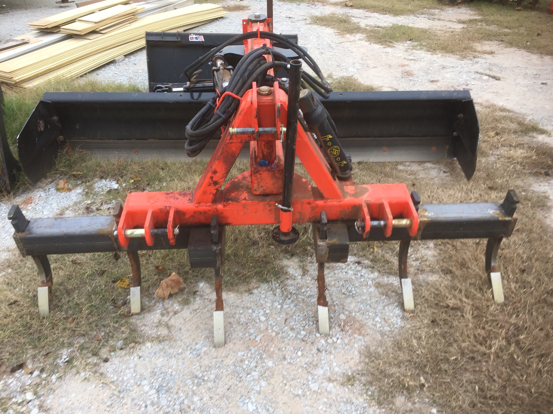

If you have a choice of one of the tools then the box blade is probably the best way to go. Having a GOOD box blade is even better. Good as in being heavy heavy heavy and as well made as you can afford. Rippers or teeth being needed as part of the box blade. If you get a chance to pick up a good deal on a scrapper blade at a later date you can always add it to your attachment list.
As said above a top cylinder and or a side cylinder (depending on your needs) is pretty darn nice to have with either of them and makes using attachments so much easier and precise.
Now this attachment pictured is probably not the cheapest or a normal set up but if you can modify a grader blade or have the resources to modify one then its a really nice tool to have and just about does the job of both with no issues. Rippers on the grader blade. Bolt on and removable wings or end caps on a grader blade. The rippers lets you loosen up the soil or gravel and the wings keep it boxed up to move around to where you need it. If you look closely you will notice the wings are teardrop shaped to allow the material to come out under the ends or keep it all in depending on how the top and tilt or the angle of the blade is set. Or you can just unbolt the wings.
I bought a piece of 4 inch tube with 1/4 inch walls for less than $50 to cut up and make this modification and used the teeth off my box blade. Might be something to do with a grader blade at a later date perhaps.
P.S. one down side is that it is longer than a box blade. On a drive its not a big deal. In a backyard in tight working quarters it can be a issue.
The hydraulics are not required by any means. They just make it easier.
View attachment 532035View attachment 532037

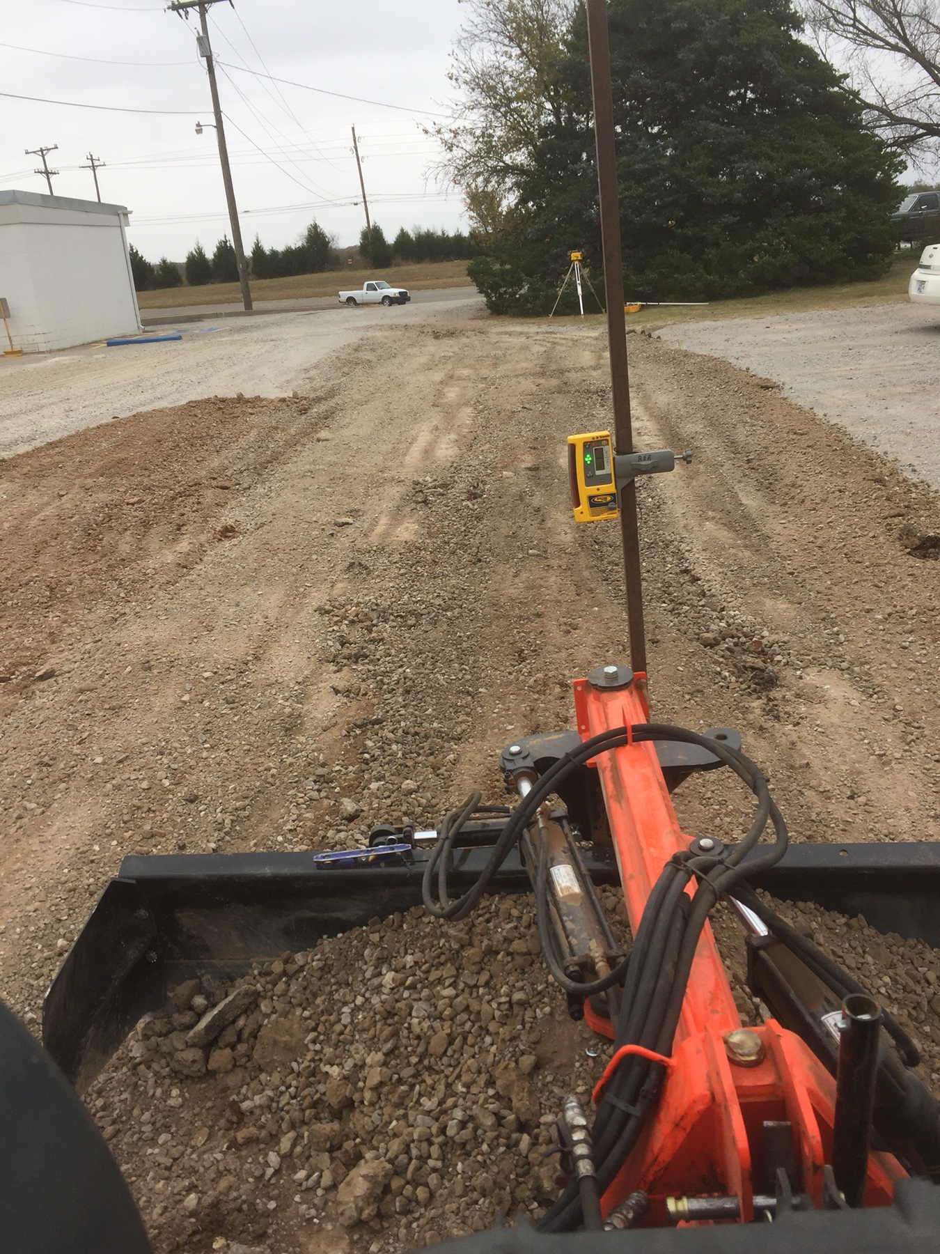

For almost 35 years now, I've been maintaining a 1.25 mile private road along with several 300+' driveways. Due to the slope involved, it is essential to maintain a good pitch to the 16' wide road in order to shed water. I've used both a 1000 lb box blade and an 800 lb rear blade but neither can compare to the work I can do with my 700 lb York rake. I have it fitted with a scarifier bar, grader blade, trolley wheels and a T&T kit from Fit Rite (Thanks Brian!).
The problem I have with the box blade is it won't move material from the ditches to the road center and it doesn't handle washboarding well. The rear blade is much better at these tasks but it is often difficult to smooth the resulting ridge in the road center. With the York rake, I can scarify the washboard, move material from the ditches, rake the center smooth with the tines and do all this without changing implements. I rarely have to get off the tractor to make adjustments thanks to the T&T.
Every situation is different though and what works well for one may not for another.

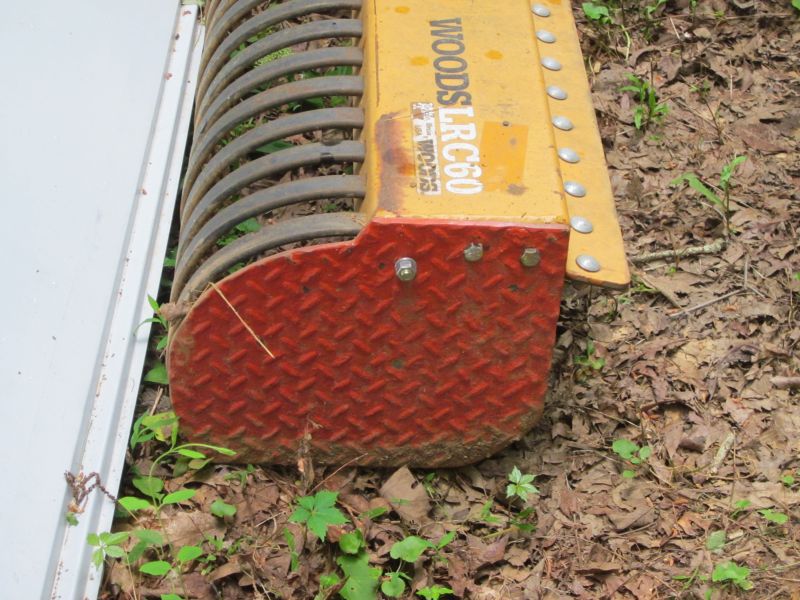

I was going to mention a rake...as the angling ability makes it also work well for dealing with washboards...
Mine is not near as sophisticated as the York model...but I do have some wheels that I rarely use with T&T...I did modify the ends to make it a "box-rake"...eliminates windrows etc...

Sorry for the diversion in this thread,:sorry: I just felt that some things needed to be clarified. If I were you and your road is the MAIN concern, I would be getting a land plane grading scraper. (LPGS) The absolute best implement to maintain a natural surface road IMO.
If other tasks are also a concern , then a box blade ends up being the best all around grading implement. Sort of the Swiss army knife of grading implements, can do a lot of different things, but the correct implement for a certain type of job is typically better.
