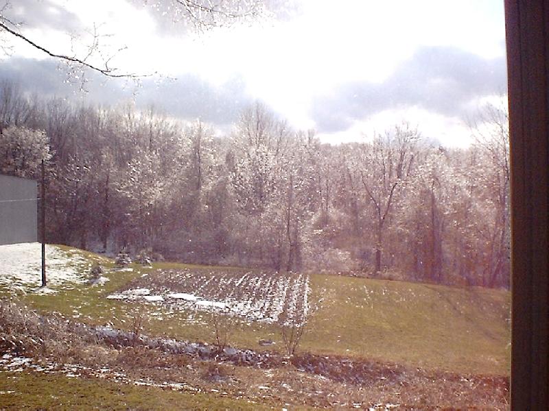

But I do have a digital camera! And if Harv looks at this post, the stuff is still out there (see attachment). Another problem, Glenn, is that I never could sell anything.
I'm beginning to favor starting with the tooth bar, especially since the ground will be frozen soon for the rest of the winter. I can start working on the vines and do some chain saw work. I expect the tooth bar might be helpful in loosening hard packed snow the town plows throw into my driveways, unless it gets in the way during heavy snow removal using the FEL.
When I brought up this subject originally I had no idea how far reaching this discussion would go. It looks like that's half the fun! /w3tcompact/icons/cool.gif

<font color=blue>if Harv looks at this post, the stuff is still out there</font color=blue>
And if I don't look, it will disappear? /w3tcompact/icons/laugh.gif
I see it, Duane. Just don't know what it is. /w3tcompact/icons/wink.gif
