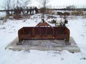

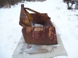

I have also been looking for a Box scraper. I have a Kubota L4300 DT, 43 Hp, The manual says it will handle a 5 ft box Scraper. I just came across an add for one "gill boxscraper for 3 pt. hitch 65" wide x 30" deep." What should I look for besides the scarifer teeth? How much is it worth? These are the only pictures I have right now.

That Gill looks to be about the same vintage as mine. I don't see any scarifiers. They will cost you about $27 a piece. My 6' has eight of them. Also, pay attention to how they are held in place. Some designs use proprietary spring clips that may be hard to find. Others use pins or sliding bars.
Other than that:
Check for broken welds
Check for any bent or broken places
reinforced corners are nice
thickness of side plates
wear on bottom edge of side plates (skid plates here are good)
cutting edge wear and whether it has been turned over or not
