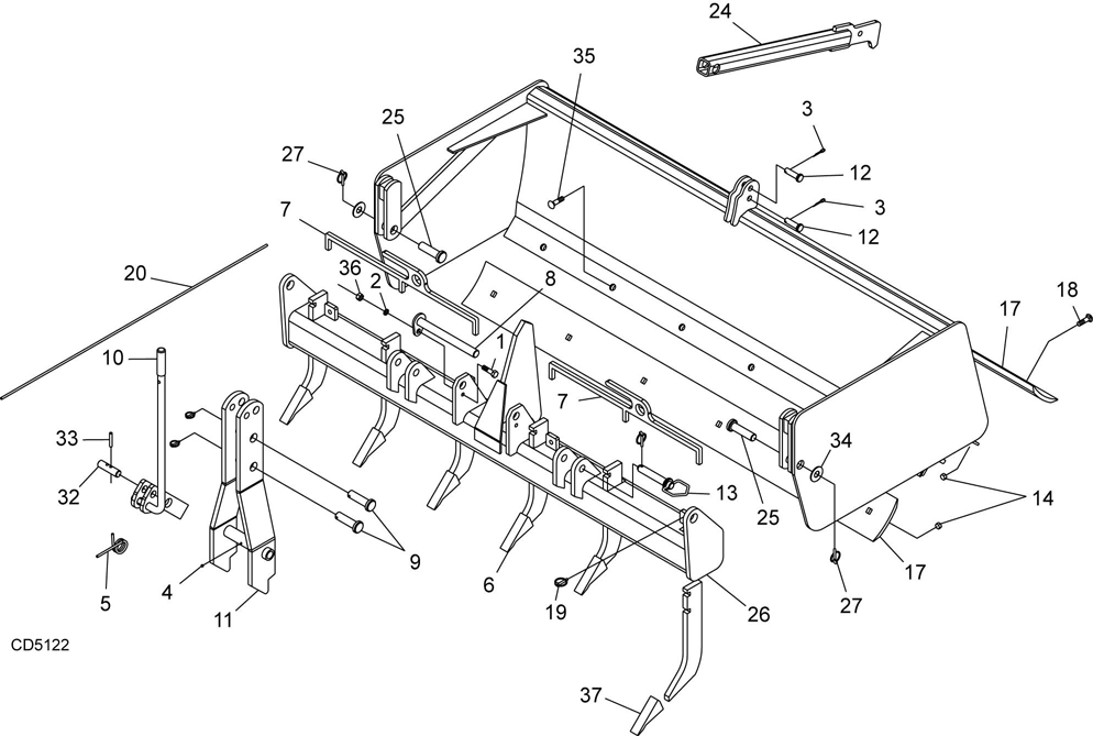

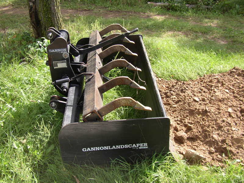

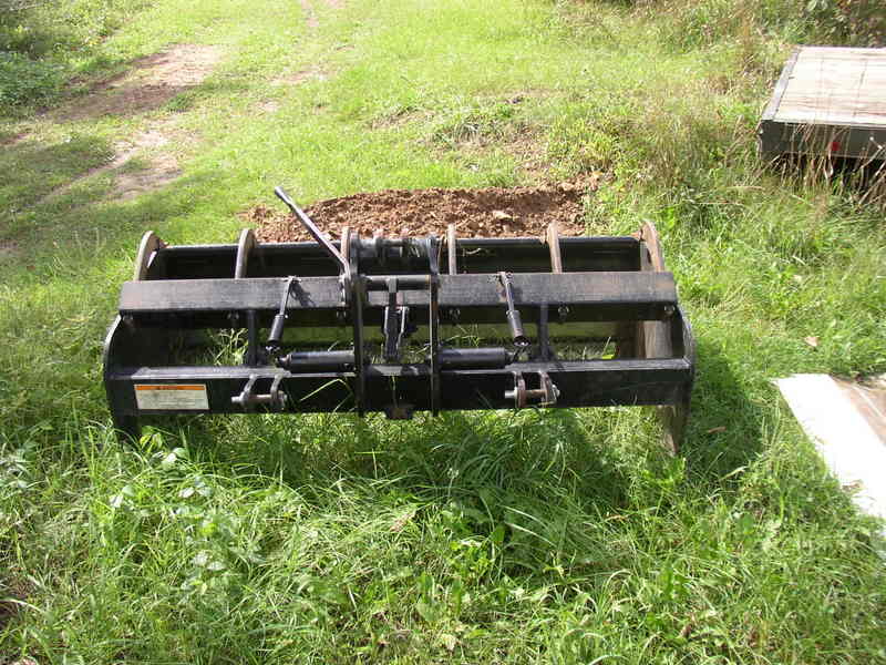

Gill was bought out by Woods Equipment and they still use the Gill name on some Heavy Duty Box Blades. They bought Gannon, Gill, and others, but it seems only the better names. They currently make a box that looks similar but it does not use cables or springs to operate the drop down scarifiers. If you could not figure out how to make the old system work, maybe you could convert it to the more modern system. The Gill blades are very heavy duty and will serve you well for many years to come. You probably can get a new cutting edge from Woods. I will post a parts drawing of the modern Woods. A users manual for the Gill, and a Gannon box with retractable scarifiers.

  • Gill box Blades.pdf

Thanks for info, Mike. Your blade is designed different from those in the diagram and manual. Your's is a little closer to what I have and might be easier to replicate. Some Questions about yours:
How is the bar locked in th down position?
What is in the cylinders (or what are they) attached to those tension springs.

I actually do not own this BB, I just happen to have pictures of it. I collect various pictures of implements that I might like to copy in the future. That is why I have a King Kutter Kopy Scoop, and an imitation Gannon roll over Box. I posted them so that you might get some ideas for modifying it so that it will work even if the original method is unrepairable. There seem to be plenty of designs that could be imitated.
How is the bar locked in the down position?
I believe that it is locked down simply by passing a bit over center. I have not seen one of these in real life therefore, I cannot say for sure.
I believe they are simply extensions sticking out as necessary to catch the bracket, there seems to be a way that you can adjust the tension on the spring--the spring bracket appears to be attached to a long bolt that could be loosened and then locked down to put the spring arm in a different position. but I cannot be positive. Sorry.
