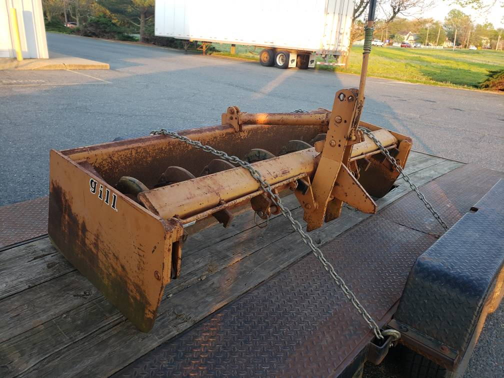

Well I was able to reach an agreement on price for the Woods/Gill SR25HD I was looking at and just got back from picking it up. Its not much to look at but is in decent condition and very hefty (around 1100lbs based on my research).
Now I just need to finish the rear remotes on the tractor so I can put the wheel back on and try it out!
Grabbed a quick pic while I was refueling.

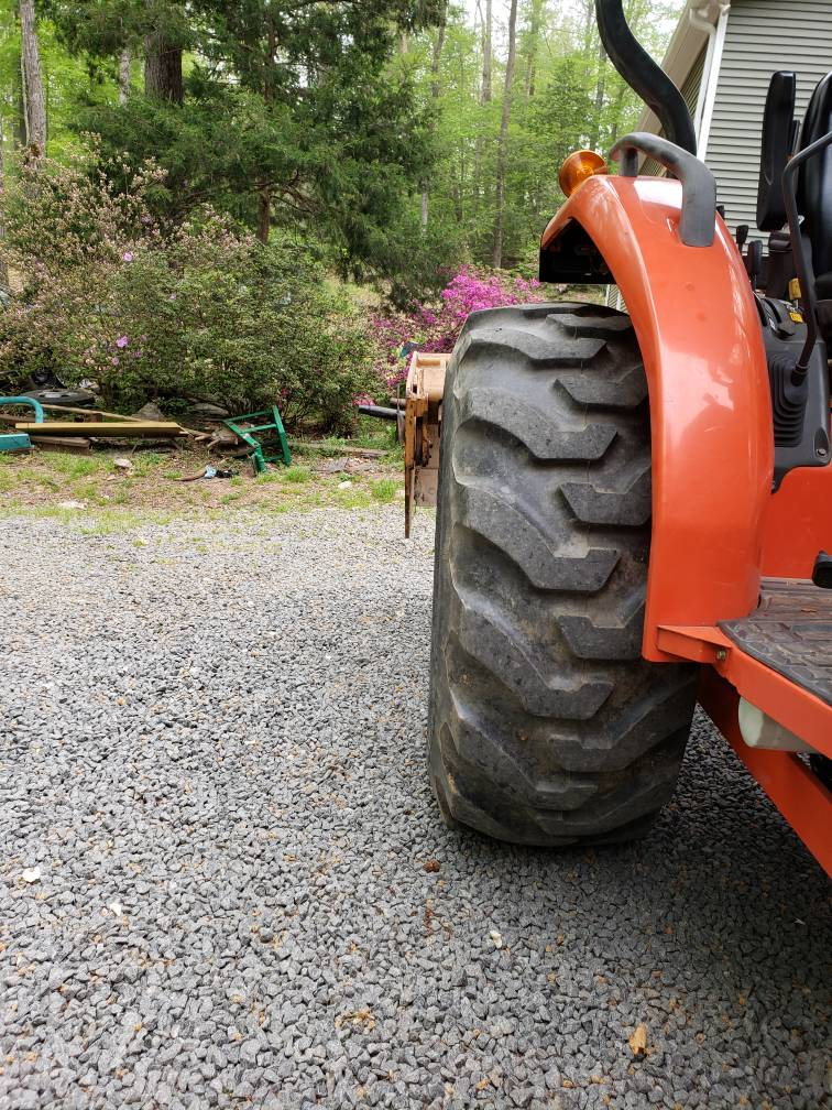

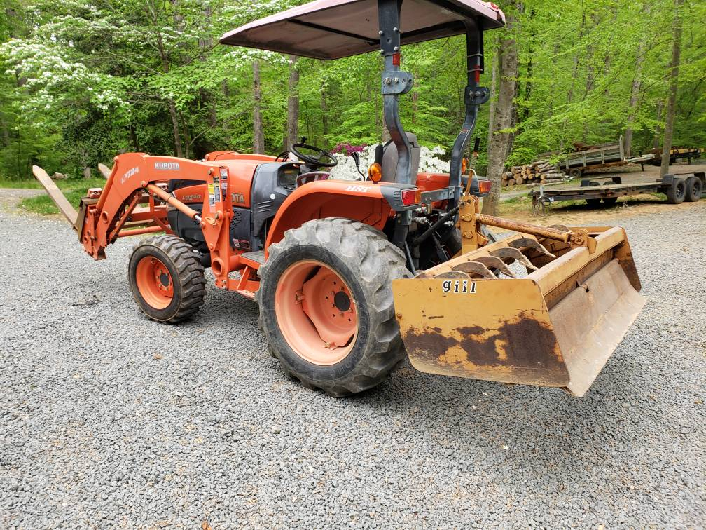

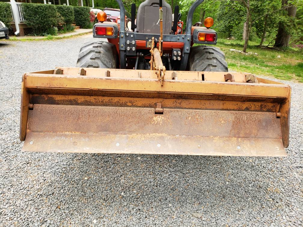

Finally got a chance to mount up the box blade, seems like a great match. The road was too dry to grade but I did pull some dirt around and had no problem, even with the loader off.
Width is just right also, I do have to remove my drawbar because the lock bar barely hits it with the rippers in the up position.
