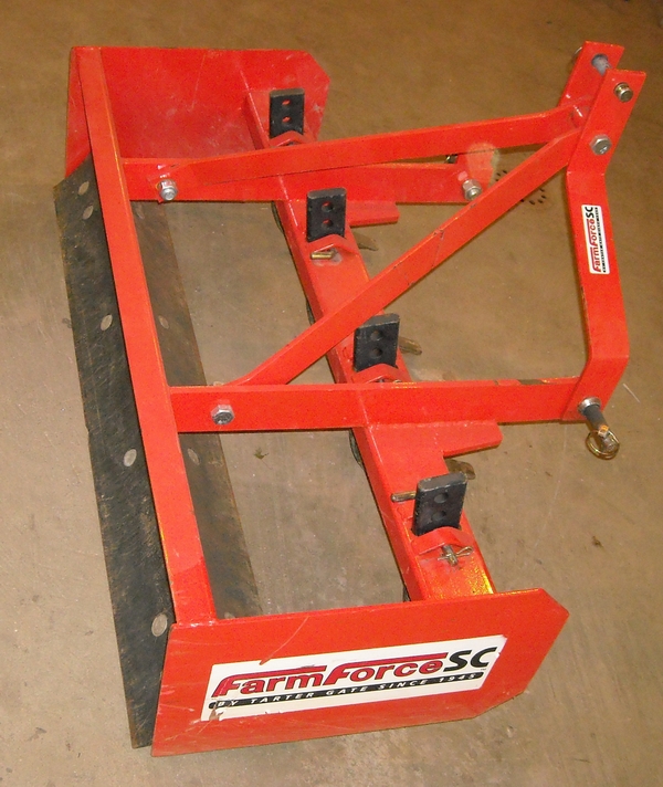

My 4 foot Farm Force by Tarter Gate sold by Tractor Supply has served me well on my tractor. I believe with state sales tax it was $425

I went to tractor supply today and they have a 4 foot one for like $450 or so, but they also had a 5 foot one for $390 or so, model BB-60-YK, how can I know if that will work with my bx1860? the people over there weren't very helpful.

Most people will say that a 5' BB is too big for a BX. I have no personal experience with this, and am only repeating what I've read here. My BX hasn't had any trouble with the 4' one, so it seems a 5' one might be fine, but I don't really work mine that hard either.
/ box blade for bx1860 #10
In your Kubota owners manual, there is recommended implement chart, specific to the machine. Have you taken note as to what Kubota recommends?

I had a five foot from another tractor and while the BX will pick it up and you "can" use it, mine handles the four foot much better.
As mentioned, there is a section on proper implement size in your manual that gives pretty good "guidelines". I must admit I exceeded mine by going with a slightly bigger rotary cutter.

BTW, Kubota recommends a 48" BB for the BX1860. Personally, I agree.
