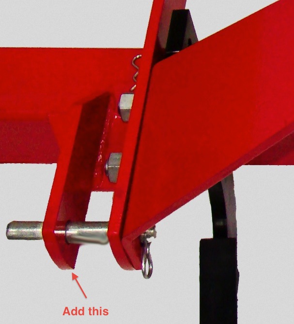

Hi I bought a box blade from tractor supply and used it twice and all bars where lift hooks up to just folded in, took it back twice and there no one to look at it so they had me send few pictures in and they come back saying customer misuse , has anyone had a problem like this with tra ctor supply right now iam out 550.00 dollars

If you or a friend don't weld, take it to a shop and add another plate to make a clevis-style hitch. This is an easy, much stronger system.

That's exactly what I did with mine. Having the pin captured at both sides of the hitch arm ball is critical in an implement with that much force exerted on it...this is doubly true of the lighter-duty models (now, something else will have to bend or break!).

Yes, and having a non-captured pin on one is a sure give-away that it's a light duty implement at best. I don't think you'll find any medium duty implements without a clevis-style hitch.

You have been offered some good advice as to how to fix this box blade. Adding some flat bar to make this a clevis hitch is a good idea and is a cheap fix. Just about any welder in your area can fix this in an hour or less.
Before responding I did go look at the TSC offerings at your locale Alexandria,La. store. Here is a link to clarify which box blade is in question, CountyLine Box Blade, 5 ft. Working Width - For Life Out Here
Looking at the box blade pictured above it is easy to see that two pieces of flat bar and new pins should solve your issues. A clevis style hitch is what the majority of the higher priced box blades use.

I damaged a medium duty box blade by using it like a dozer blade and then pulling at small stumps. the combination of push/pull damaged the lower link connections.
I added a piece of flat bar with a hole in it for a clevis pin and it has worked for years as hard as I want to work it.

I think his lower lift pins were loose. If they were loose, working that box blade would have bent the mounts. It happened to my 6 ft medium duty Howse box blade behind my NH TC 35, and I mistreat the fool out of it. To repair it, I chocked it to a tree, pulled the bent section back into place with a come along and sledge hammer, and tightened the pin up with red Loctite and the air hammer. Good as new!
