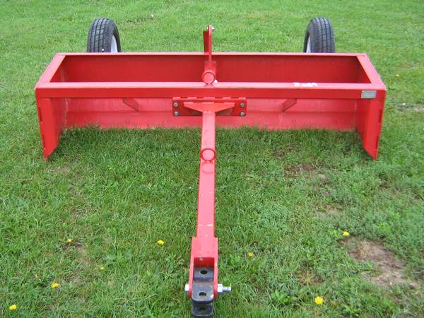

RandyinTN, have you considered their Dual Edge Grader? Titan 33 Series

No I haven't. What would be the advantages of this? My knowledge of anything like this is limited as I never owned a tractor before.
Thank you
/ Box blade decisions #23
It is designed for what you want to do. There have been many threads about them, commonly referred to as a LPGS (Land Plane Grading Scraper). Click this link for more info: Search Results - TractorByNet
You could also add a bolt on blade across the back to move dirt like a box blade.

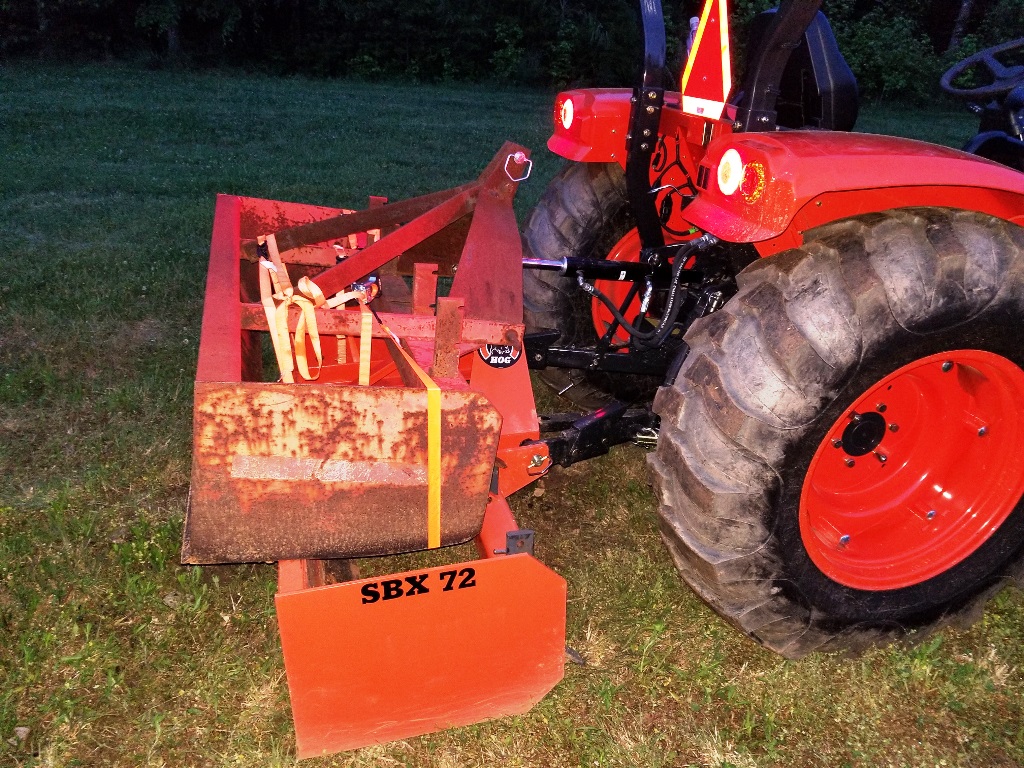

Kubota L4330, a ~40 hp class tractor with +1150 lbs of LMC HD BB, railroad rail and 510 lb weight block:
530 lbs on a 45 hp tractor? Probably won't even notice it.
Are you using your ratchet rake for ballast or is that where you store it? Mine stays on the bucket about 90% of the time
It's been stored there since I made that weight block 3 1/2 years ago.
