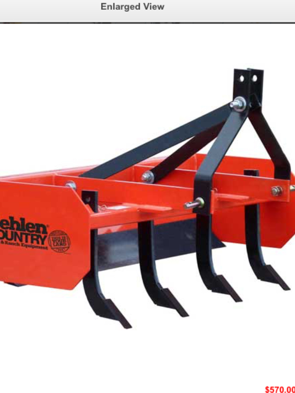

Can they handle a little abuse? Maybe behind a BX. A well ballasted 40 hp tractor will tear them up pretty quick. Don't get a BB with pins only supported on one side like this one.

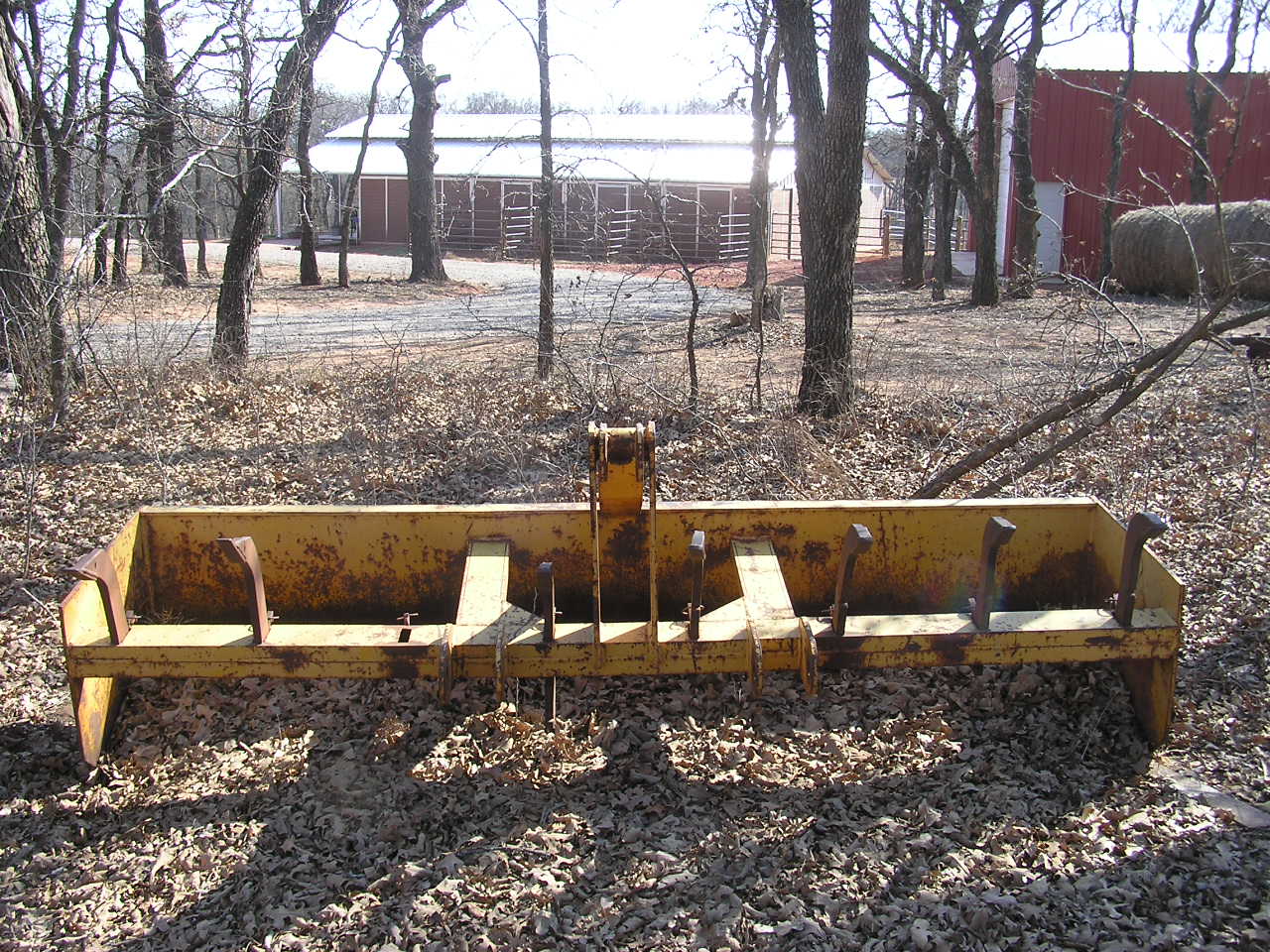

Luckily, there isn't much that can go wrong with a box blade. It's one of the best implements to buy used.
Basically just want something HEAVY! And if it's not all bent and mangled you should get years out of it.
If it IS all bent and mangled, then it's probably not HEaVY!

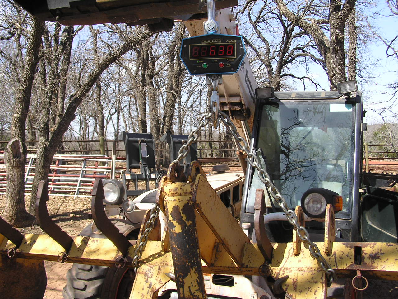

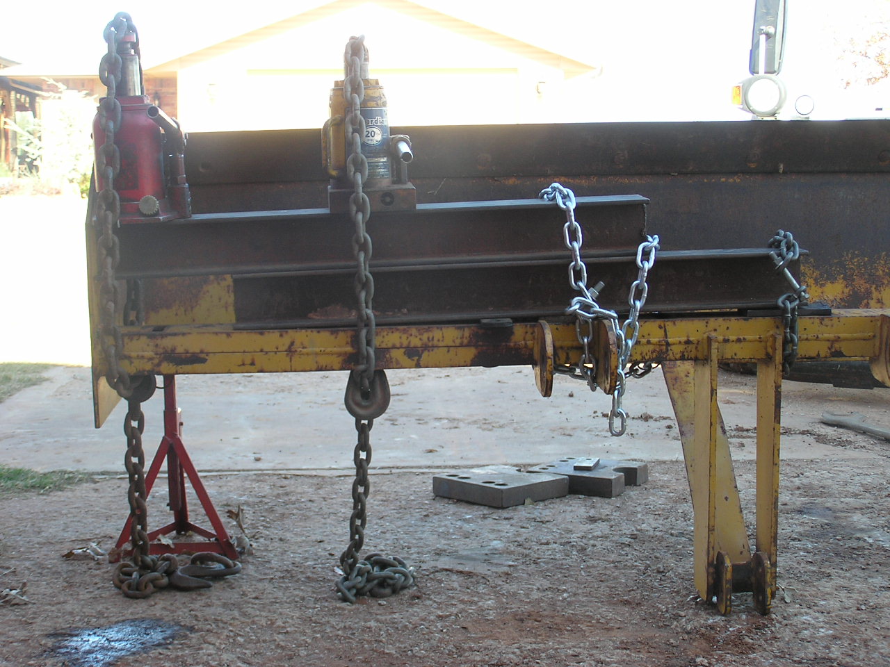

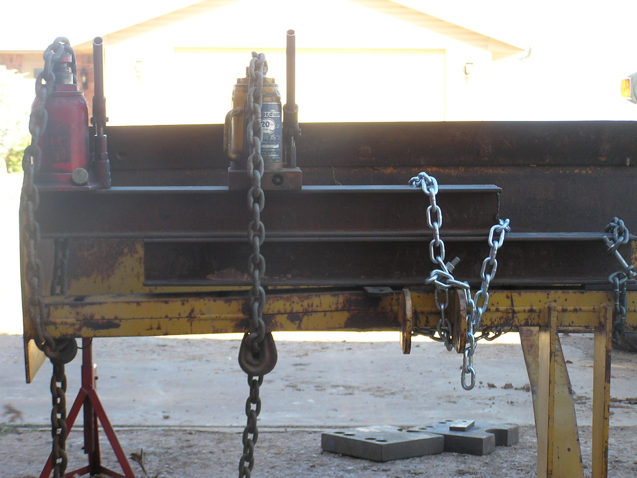

About six years ago I was looking for a lightweight box blade to level dirt that I was hauling in. Saw an eight footer on craigslist for $350, wondered what was wrong with it, besides missing one scarifer. Went to look at it and saw that it had snagged something immovable and bent the cross frame. Bought it, brought it home and straightened it. :thumbsup:
It only weighs 638 pounds.
