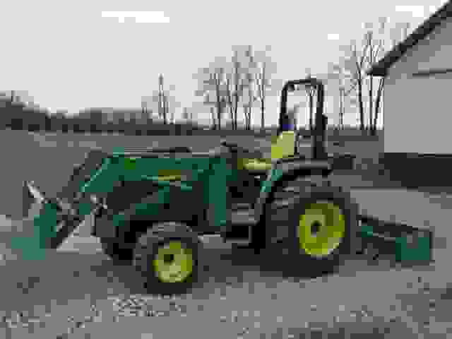

well guys, first off thanks for the advice. I happened to luck into a dealer you had a 7 footer in stock and was willing to deal. He said it had been setting outside for about a year so I expected it to be all sun faded and rusty but the price he quoted me on the phone made it worth it. I made a 2 hour drive south and once I got there I was suprised to see that the blade was still in the crate and looked like brand new (not my normal luck) so I give her a quick once over and we loaded it up. Now all I need is a good top and tilt kit......

Got a little seat time today and then figured out my camera...
here are a few pics of my new box /forums/images/graemlins/grin.gif

I have to say I am glad I took Indy's advice and went with the 7', the mass of this thing is incredible. It weighs 739lbs. The floating tailgate makes it really nice for finish grading, this was my first experience with the floating tailgate and I like it. I volunteered to help a neighbor cut down a 4' tall hump in his yard today not knowing really if my rig was up to it...WoW I was impressed. My little 4710 only stuggled with the heaviest cuts and then only ran short on traction, not power.. Excellent buy and am looking forward to working it some more...

Glad to be of service sir! /forums/images/graemlins/grin.gif That is identical to my Woods box, with the exception of color. Even has the "thermos bottle" owners manual holder. /forums/images/graemlins/crazy.gif
Weight is the key to a box blade's working well. /forums/images/graemlins/wink.gif
