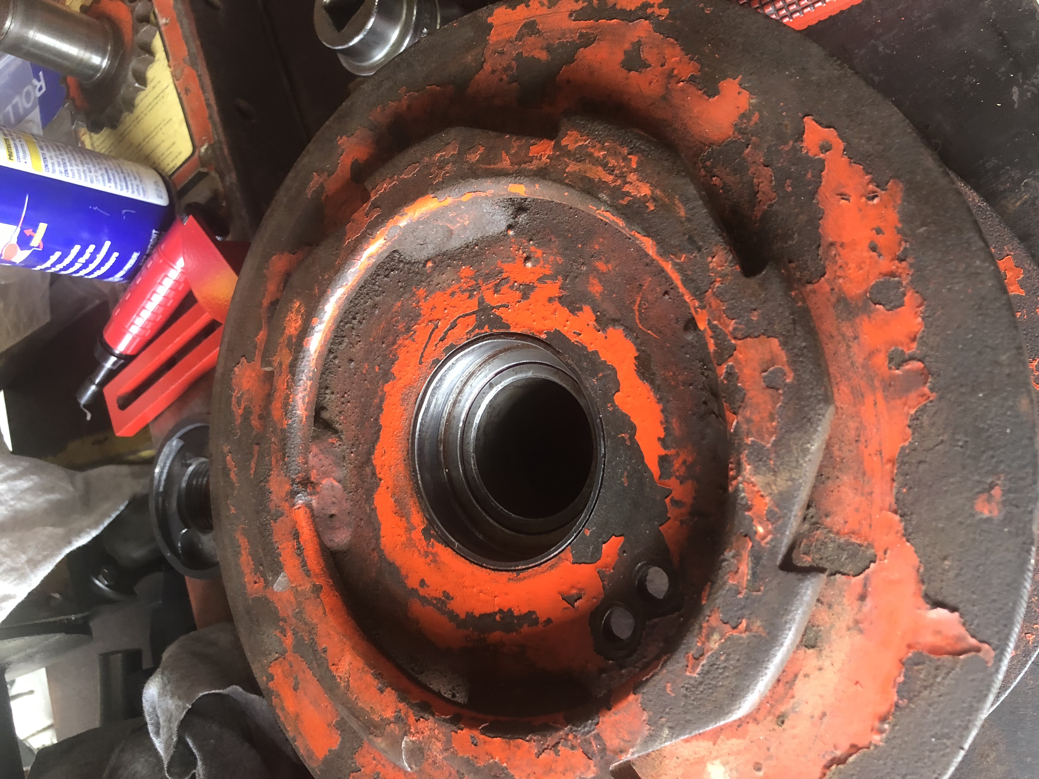

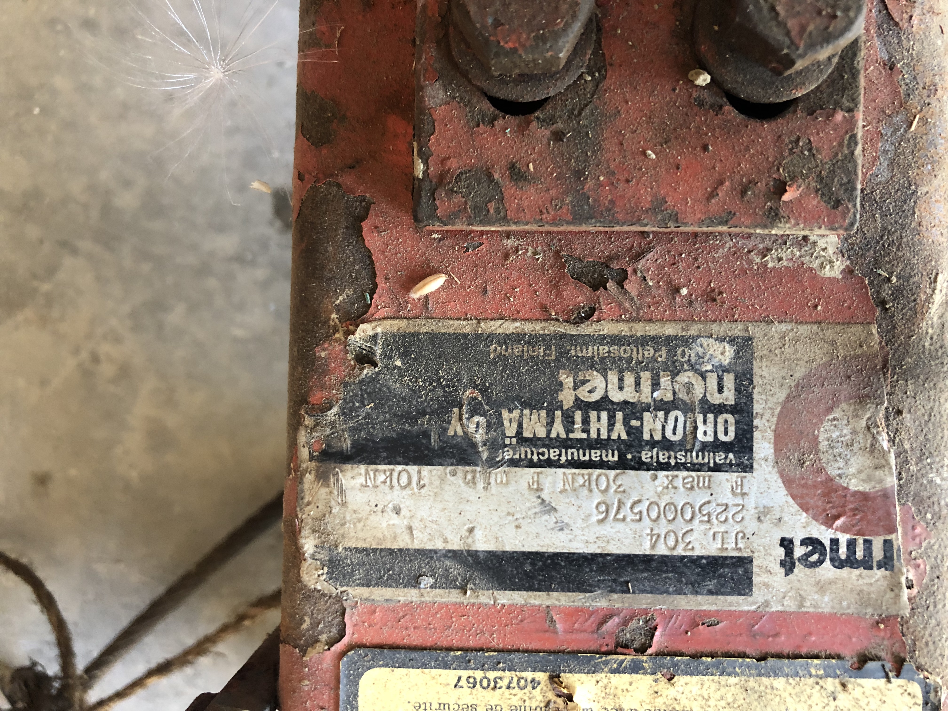

I picked up a old well used Farmi winch a couple weeks ago. I stripped it all down and have replaced all of the bearings and bushings. Got the bushings from Northeast Implements and the bearings through my local bearing supply house. Other than those things and cleaning up and addressing a few small things itç—´ in good mechanical shape for its age. Hopefully you guys can tell me if I got a good deal on it. I paid $400 for the winch and will have about $250 in parts. I think when itç—´ done it should last another 40 years. They are very simple and parts support is excellent so I would say if youæ±*e in the market for one don稚 be afraid to get an old one and put a little money and time into it to bring it back to top condition. 13CA305C-EBF4-45D5-BD59-ACBAE7E91D24.jpeg4AD27946-268D-4707-A0B4-C8DEA9324E27.jpegFAE9BD15-61B3-43A2-B6CA-7B3C63EDD8B6.jpeg

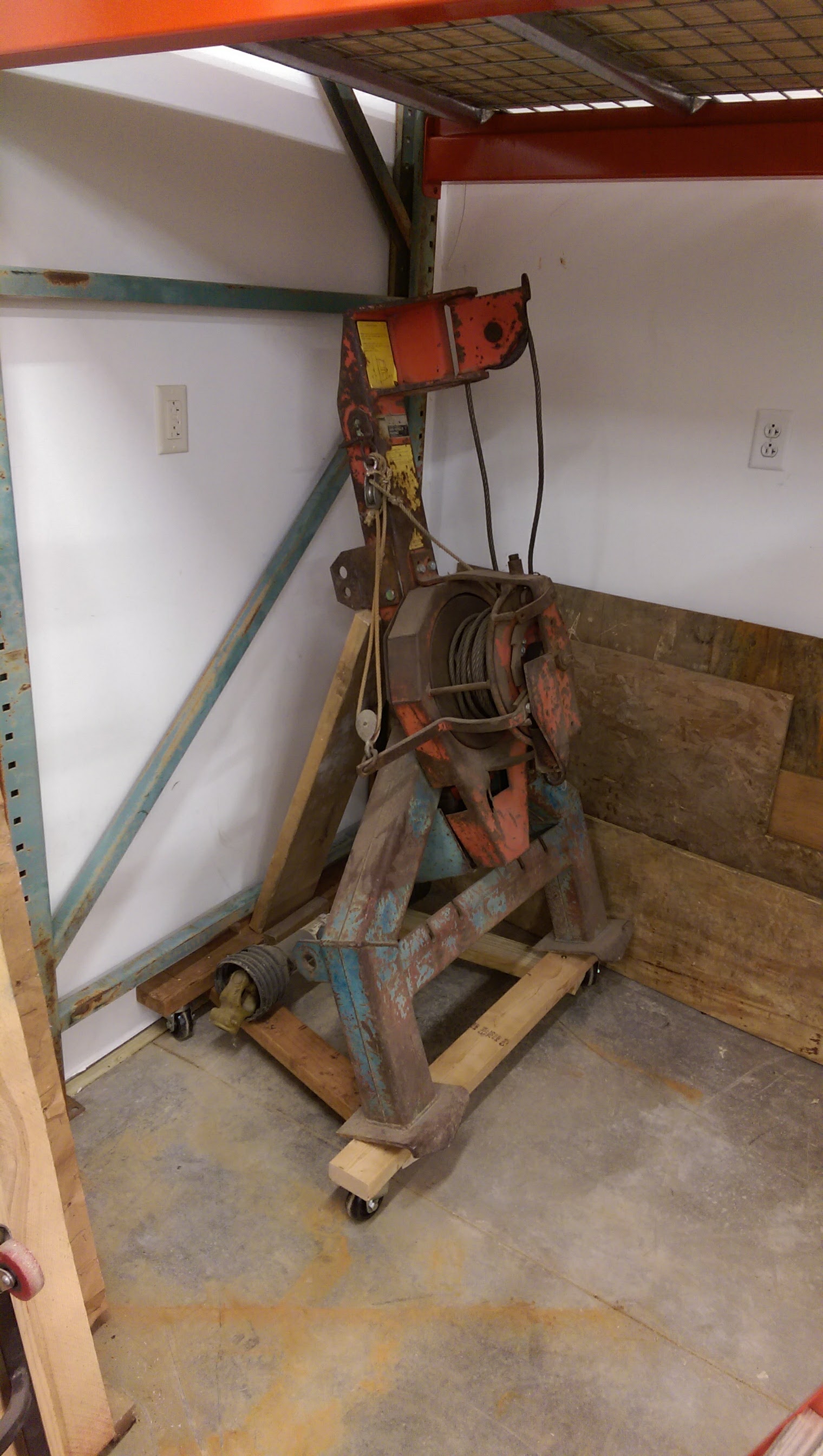

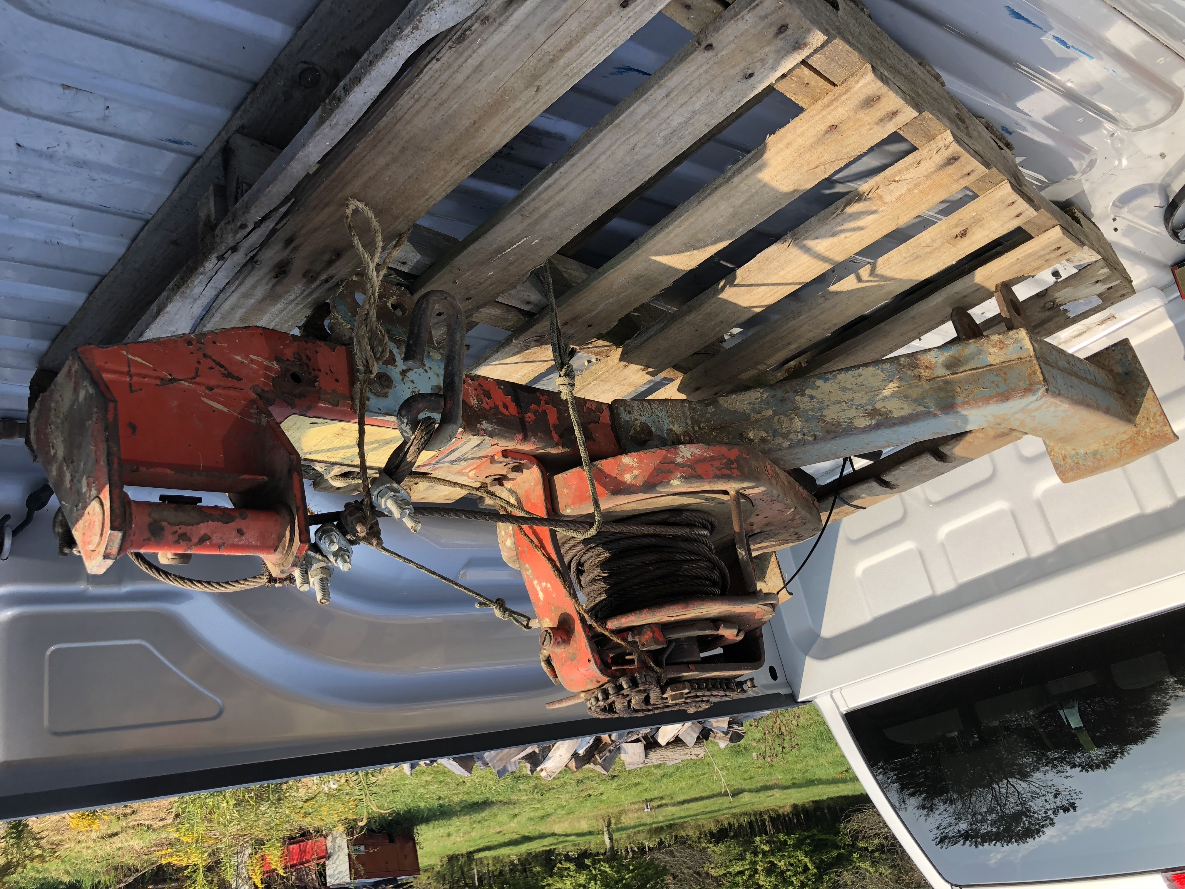

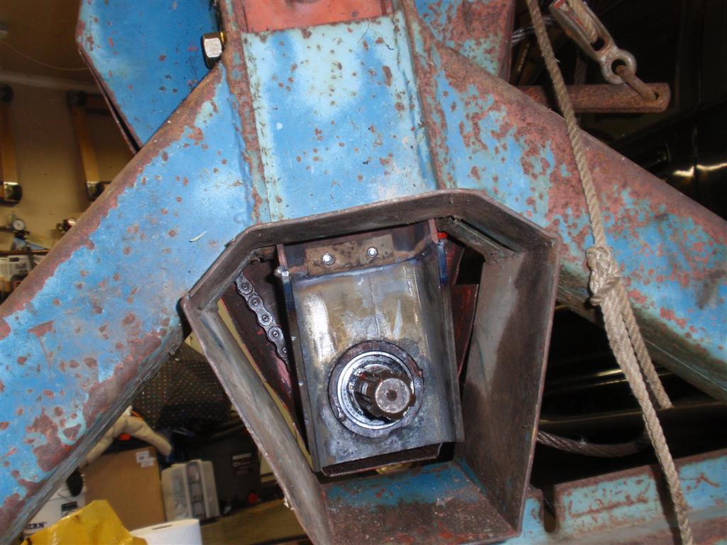

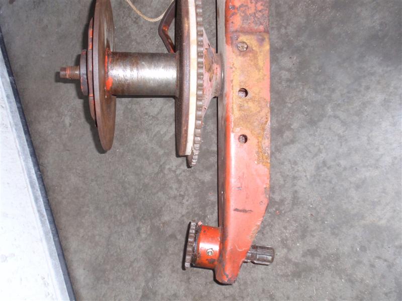

I have the exact same winch, but my price beat yours - free! :D But I still think you got a great deal. They are very handy! I got it from a friend that bought it back in the 70's for his firewood business when he was in high school and college. Someone had damaged it so the frame was bent. It was beyond my capabilities at the time to fix, but I found a local shop that cut off the bent piece and glued back on a new piece they made for not much cash. Then i put new bearings in and just cleaned it up - much like you did. I think I did have to replace a few other wear items too, and yes they still stock parts!
You can see the problem (bent) looking at the lower small gear.
This was how they fixed it
And finally the storage dolly I made for it.
You can see the problem (bent) looking at the lower small gear. This was how they fixed it
Cool! I am in the put it back together mode now. Nothing bent on mine but the small sprocket had some pretty good wear. So I cut the weld and removed it from the shaft. Bought a new 16 tooth sprocket and bored it out to be a press fit on the shaft and then TIG welded it on the shaft. Put it all back in with new FAG bearings. Painting it to match my Mahindra. I will share more pics when it is done.

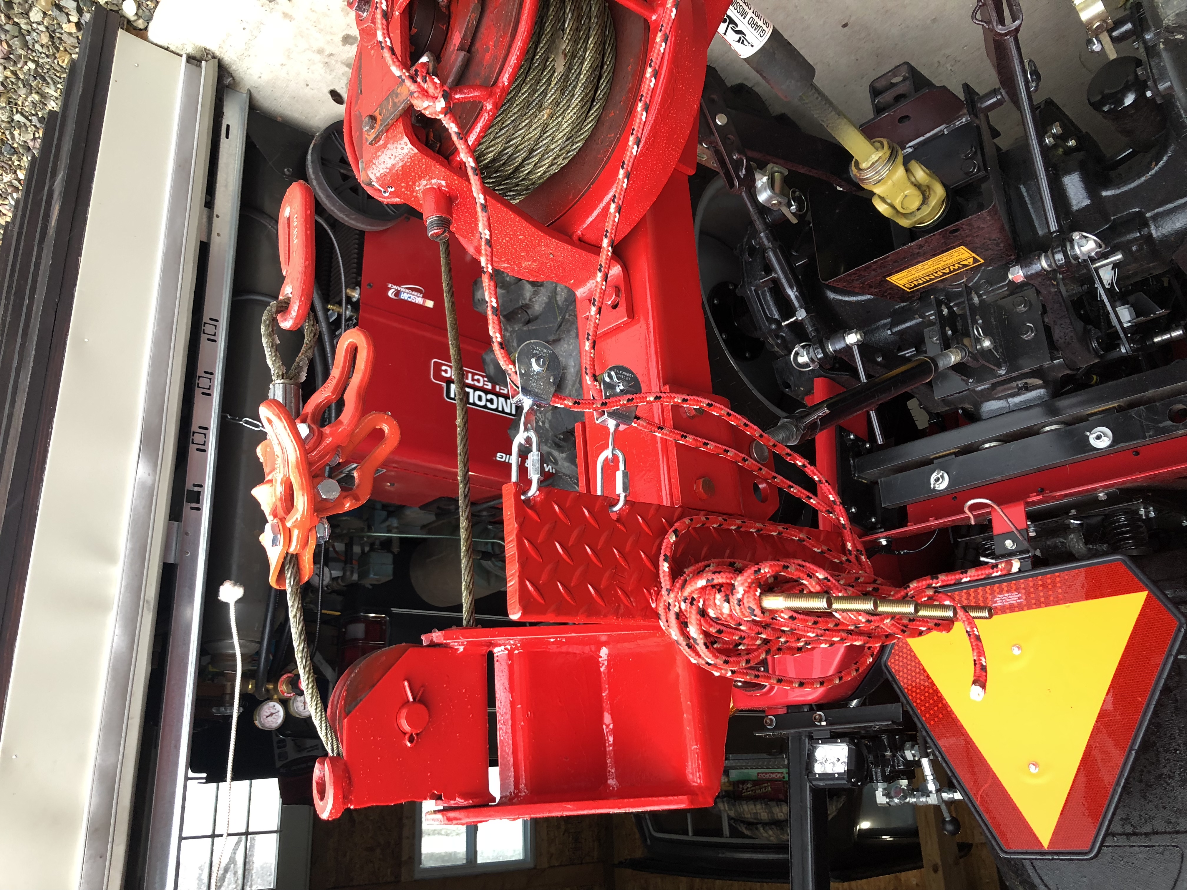

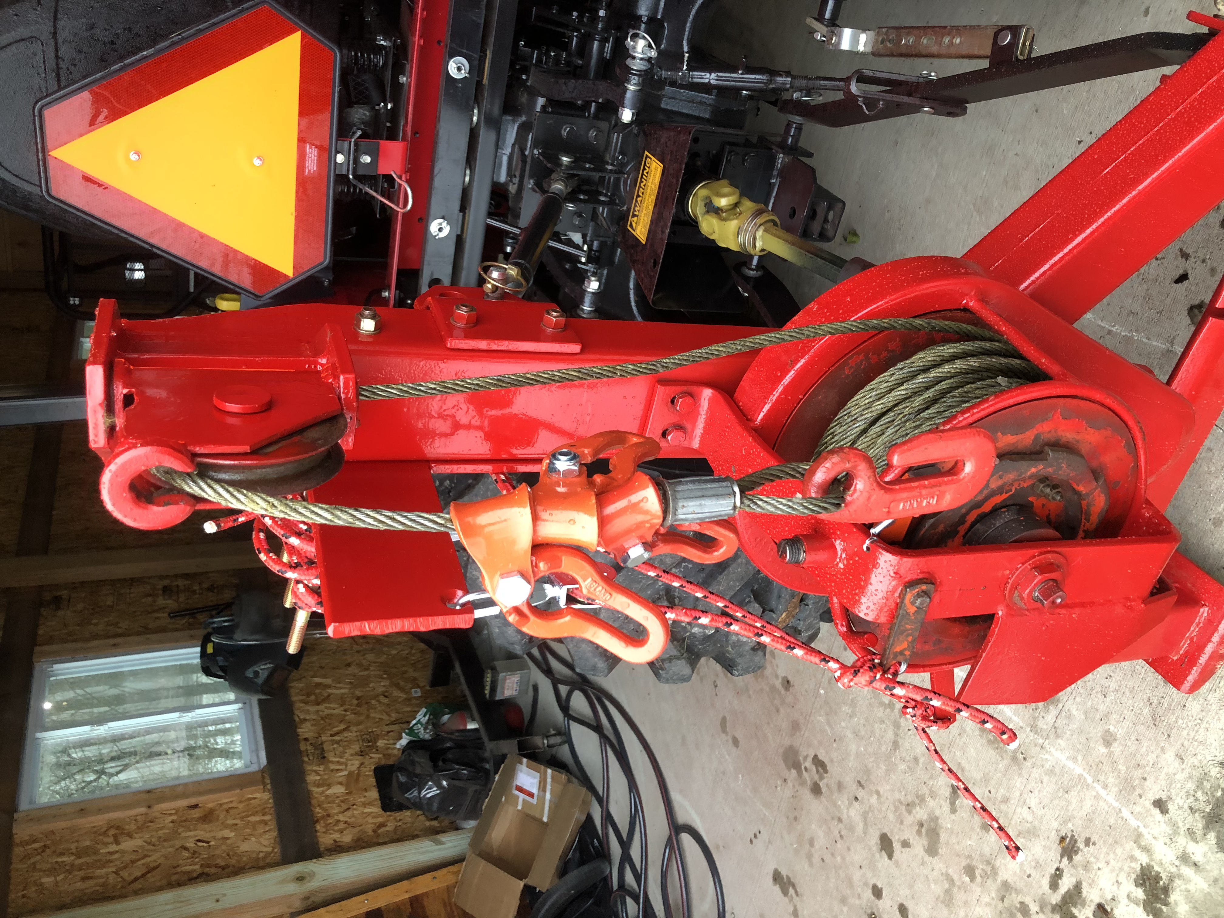

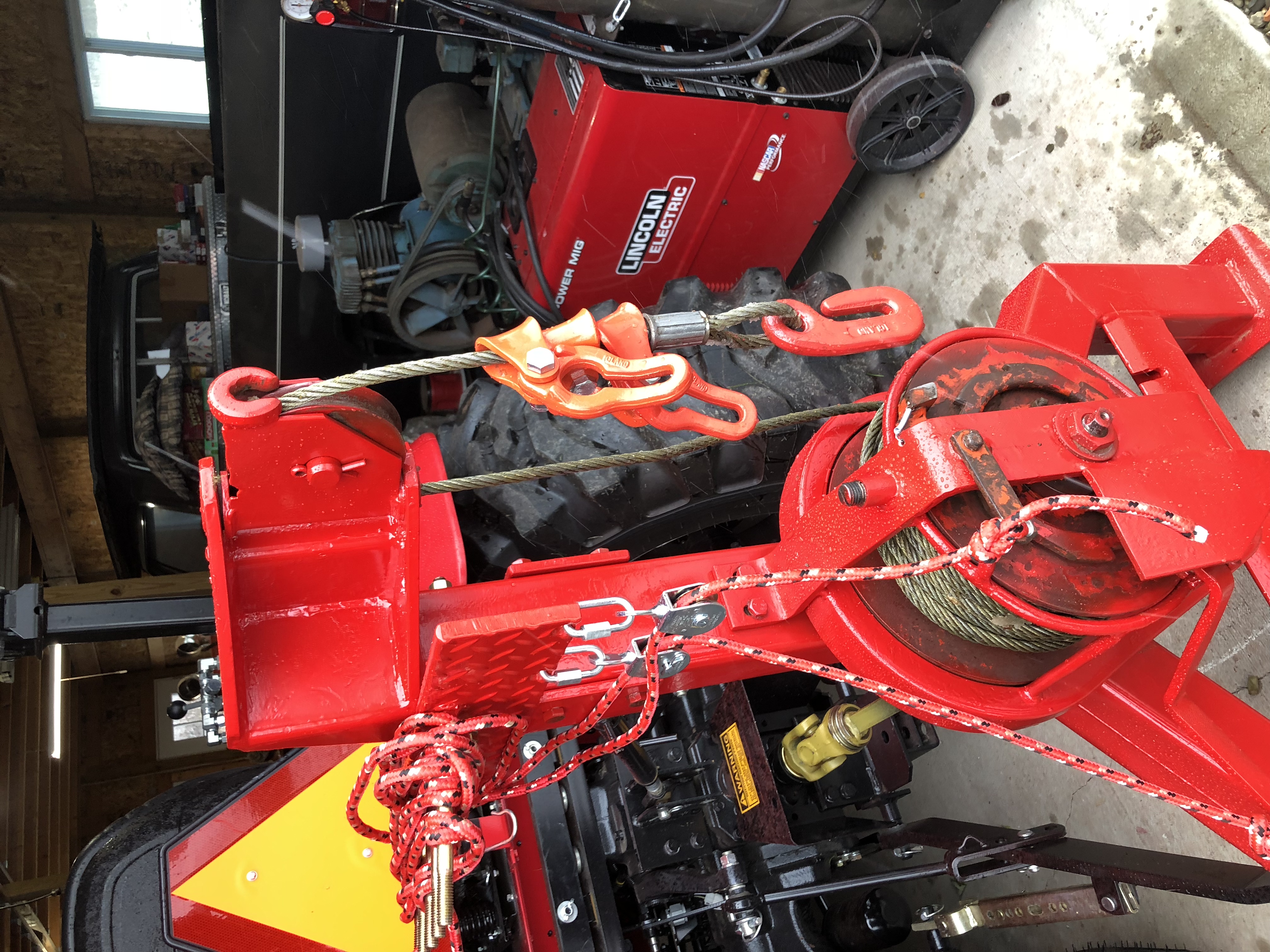

D02B41B6-67FD-4438-954F-0047CE10F155.jpeg69E8DCD7-CC37-4EA6-AB5C-9D36F53EB182.jpeg2CDC1399-E90E-45BB-B86E-9A63929C3195.jpegWell I finally got it done. Here痴 a few pics. Did a little light skidding with it to coil up the new cable. Seems to work Great.

I'd be REALLY careful with it !! Lots of spinning unbarred stuff . Good luck and happy pulling
