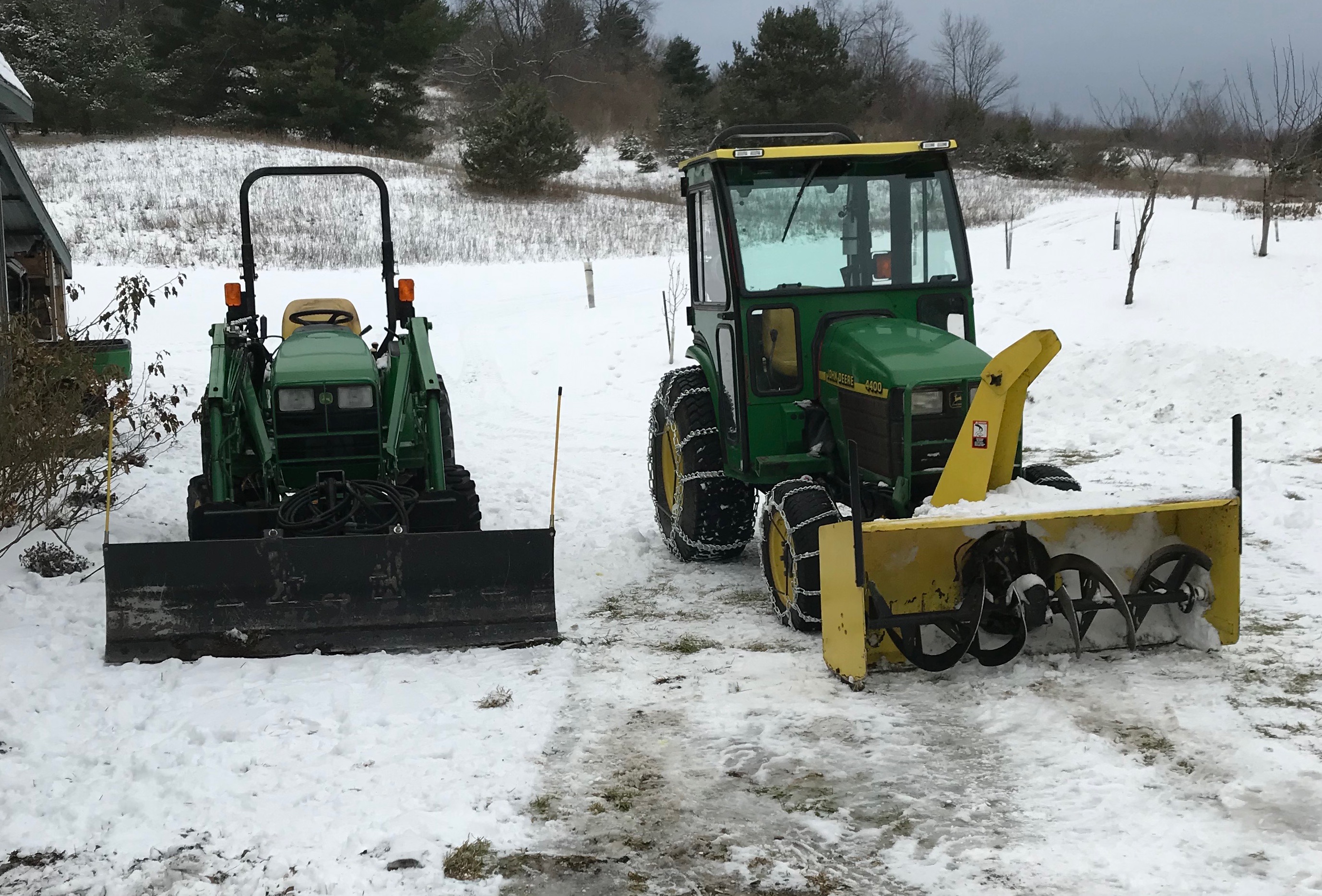

I have been real pleased with my 4310 e-pwr reverser. I've had it 4 years now and have had no serious issues with other then a neutral safety switch and the silly seat safety switch in cold weather. Thing has had zero issues handling 4x5 round bales with the 420 loader. I liked it so much that this fall I went and bought a 4400 hydro with cab for snow blowing.

I been very pleased with it so far. I originally was looking at a curtis hard cab for the one I had and then pricing out the cost of one and the fact that it would be extremely difficult to run the backhoe off it with a cab I opted for a similar model that I could swap attachments out back and forth. So I found this 4400 on tractor house with cab, loader, mower and plow at a price I could swing and jumped on it. It's got just over 3k hours on it but the hydro is strong, no blow-by or leaks and starts in 10 deg. weather with just 5 seconds using the pre-heater.

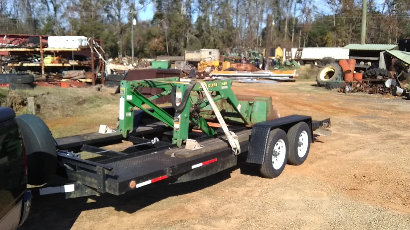

I picked up a 420 loader and all the brackets for it for $1200. The loader was missing the bucket cylinders. I am going to try and retrofit some 2" cylinders on the lift and bucket to increase the strength and height. Planning to do another thread on that.

remember, if you increase the cylinder size, you may exceed the strength of the loader, and it may fail catastrophically!.. larger cylinders will exert more force, at the expense of extend/contraction speed..
Only increasing the bore size a 1/4" over original. 430 loader comes with 2" bore cylinders and uses pretty much the same frame. I don't think it's an issue.
Just connected the loader this afternoon and it took less than a gallon to top the tractor back up.
Unfortunately the latch plate on this 420 loader won't connect to the front weight bracket on my 4310. Back to the junkyard in the morning.

Do you have a pic of the mismatch on the latch plate?
/ Bought a 4310
#40
No I didn't take any. Hoping the front plate on the 4300 the loader came off of will bolt on my 4310 and solve the problem.
Heading to the salvage yard I bought the loader from in the morning.
