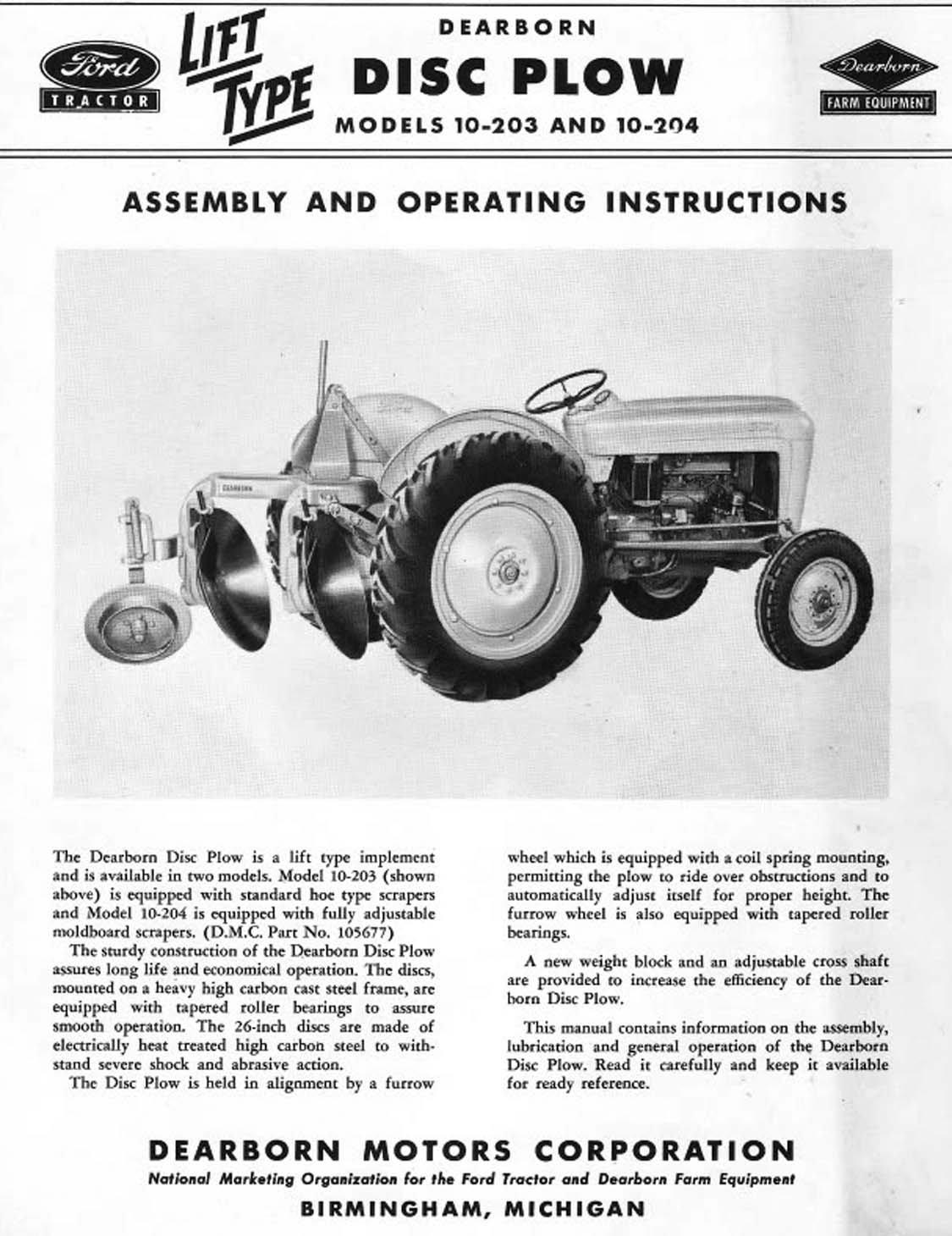

I like sixdogs tiller suggestion. I've tilled a few construction sites full of buried debris, slow, shallow and about one third throttle.
Also, if you have access to a disc-plow, that is pretty much what they were made for.
   / Bottom plow in rocky soil #16
