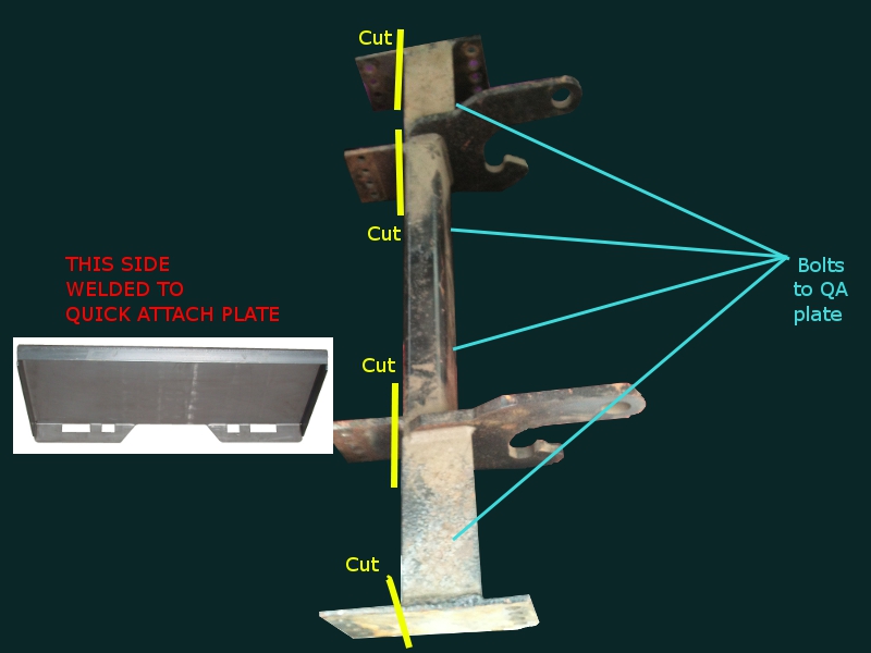

Has anyone mounted a Boss RT3 Push Beam to a skid-steer type quick-attach plate? This is what I'm planning to do to phase out my 93' GMC plow truck. I'd like to keep the plow stock as I bought it new and have kept it in excellent condition over last 8 years. I plan to use the Boss 12V pump and controls to operate the hydraulics, maybe mount a second battery to take the load off the Yanmar's battery.
Seems straight forward, some cutting, welding, and maybe put a few grade 8 bolts through the push beam for extra hold strength, and reinforce the plate with angle iron as necessary. I picked up a push beam yesterday that I can hack on while leaving the one on the plow truck intact. Just curious if there's any other setups like this out there, I've been through the entire snow weapons thread and didn't see anything like it.

Here's a quick diagram of the modifications I'm thinking of making to the Boss Rt3 Push Beam. Certainly I can post pics of my progress. :thumbsup:
I also plan to reinforce the plate that the bolts attach to with angle iron, and weld in a Reese trailer hitch receiver tube and D-ring to make the adapter a little more versatile.
/ Boss Plow Quick-Attach Adapter #4
Now I get it. Simple and clean design. I might suggest that you go with a nice thick QA plate to help spread the load for your tractor arms and I very much suggest a second battery. What size alt. does the tractor have? Keep me posted.

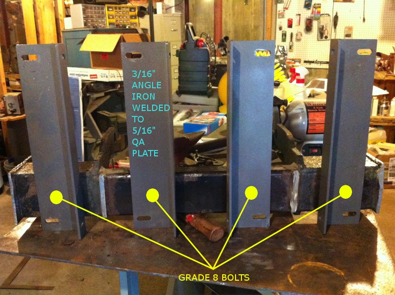

Yes, I think we're all in agreement the QA plate needs to be reinforced. I'm thinking angle-iron on the rear because I have a bunch of 3/16" scrap on hand. I imagine if I had square tubing lying around instead that I'd want to go that route.
Here's a pic of what I'm thinking with the angle iron, just imagine the QA plate is sandwiched between the Rt3 Push Beam and the Angle Iron. The QA plate I've ordered is 5/16" and the angle iron is 3/16", so the total thickness of the four reinforced areas would be 1/2 inch. For comparison, the two hooks being inserted into the plow frame are 1/2" thick.

Got a few more hours in this weekend until forward progress was stalled by a bent 3/4" drill bit. I cut the angle iron to size to make the ribs for the back of the plate, and drilled holes through the push beam. FYI, the push beam steel tube is 1/4" inch thick on each side. Add that to the 5/16" QA plate and 3/16" ribs, the 3/4" Grade 8 bolts will be fastening a full inch of steel, not including the washers.
The grade 3/4" grade 8 bolts have a shear strength of 40,000lbs each. I'm tempted to just bolt the push beam on, it would make it easier to paint and take off should I find another bolt-on use for the QA plate.
Not using any fancy tools to this point, a harbor freight 4.5" electric grinder with a cut-off wheel made easy work of slicing the 3/16" plate to size. A Skil tabletop drill press was used to drill the holes through the push beam tube.

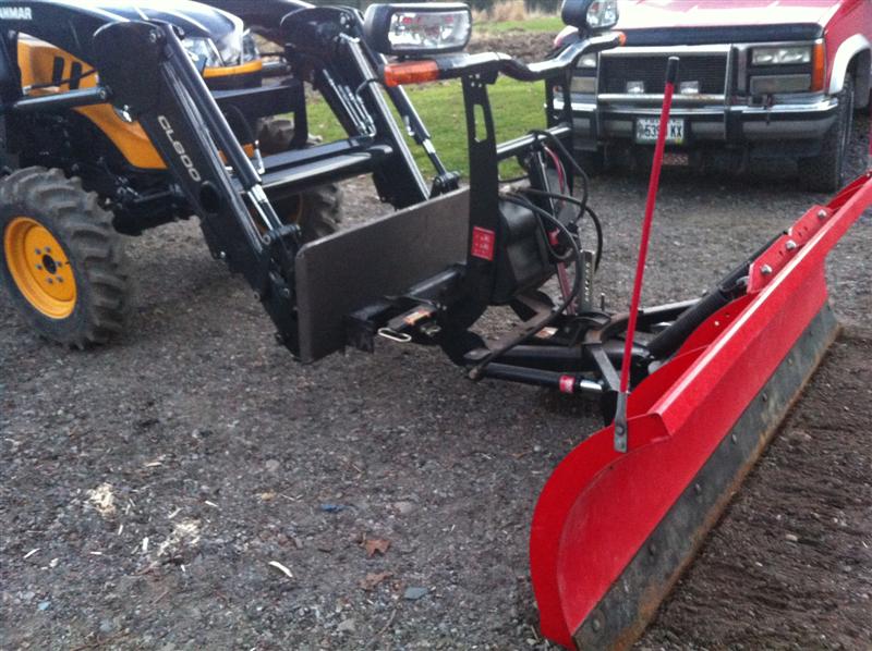

I finished up the welding and drilling today and mounted up the plow manually. By manually I mean I didn't use the electric switch on the plow that operates the lift cylinder to mount the plow onto the push beam, Boss plow owners will know what I'm talking about. The push bar is only bolted on in these pictures, I'm going to leave it like that for now.
It hitched up pretty easy once lined up. I had never hitched the Boss plow without using the electric switch before, but all you need to do is drive in, flip the on/off actuated pin levers, and push the light bar towards the tractor until the spring-loaded pins pop into place. The lift cylinder must always be in float mode when its not being used. Removing the plow from the mount manually was just as easy. It didn't take much effort to push on the light bar to actuate the pins. However, I imagine I can just leave the QA plate attached to the plow once I've retired the truck.
I drove the plow up and down my 400 foot driveway to see how it handled, I'd say it handles better than my half ton GMC, especially in two wheel drive. I did need to be gentle with the loader controls, the plow really sticks out there so you don't want it to shake while lifting and dropping.
Existing tractor lighting seems adequate.
For wiring I'm thinking now I'm just going to wire in the pump solenoid and controls to actuate the right/left cylinders. I don't think I'll add a second battery now, but I'll probably swap out the factory Yanmar battery for an Optima red top or similar.
Onwards to paint and wiring!
