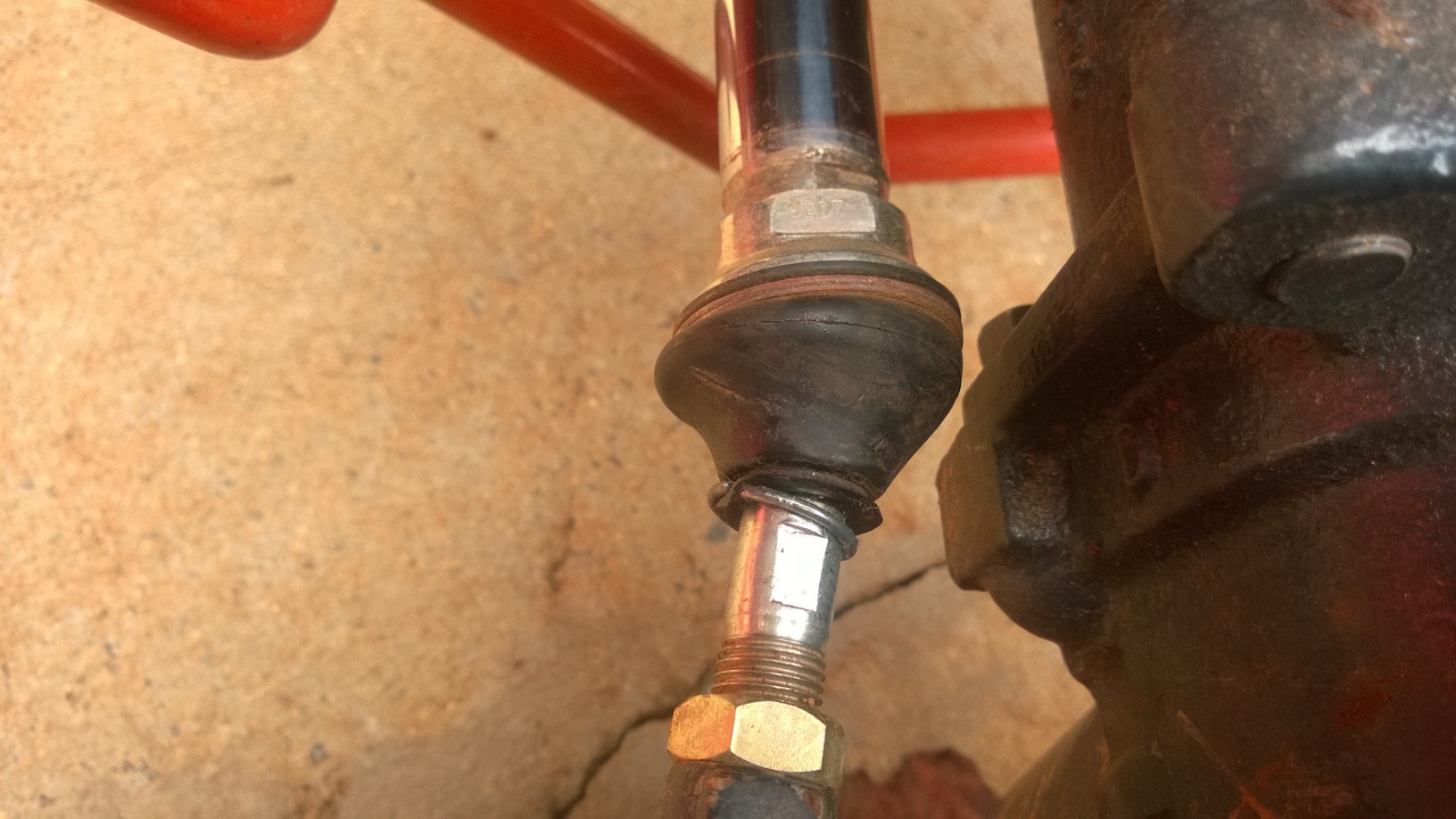

Found this yesterday. Anyone know a easy way to fix this? Does it require buying a new boot? I am certain it is not good and probably is a harbinger of a coming failure.
   / Boot retaining ring - broken? #2
Found this yesterday. Anyone know a easy way to fix this? Does it require buying a new boot? I am certain it is not good and probably is a harbinger of a coming failure. <img src="http://www.tractorbynet.com/forums/files/kubota-owning-operating/442880-boot-retaining-ring-broken-bkokenretainer-jpg"/>
. Think I paid $12 for the boot on my bx25. Pain to put the new metal ring on but not that bad. You can put that ring back on with out buying a new one as long as the boot isn't ripped.
