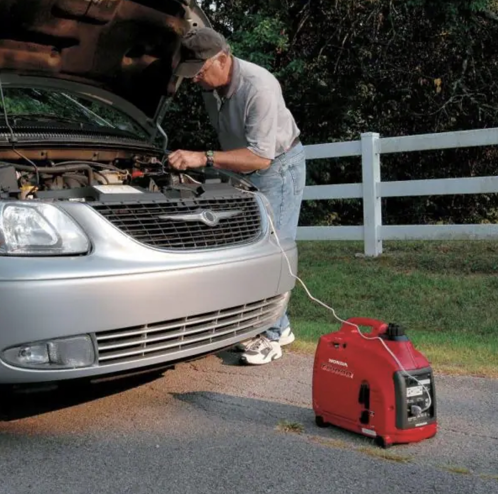

I use a portable Honda generator for this purpose. The charger weighs 29 pounds so it’s easy to take anywhere and it will run for hours on half a gallon of gas. Too pricy if that was my only use but I use it a lot, great for power anywhere you have a project away from the house/barn.
/ Booster Battery Packs That Last ??
I have that same Honda EU2200i generator. It can be used to power a battery charger and some models also have a 12V output but both take a long time to charge a battery.
/ Booster Battery Packs That Last ?? #5
Yep. I actually have the EU1000i, (great for tailgating and camping) but I find that 10 minutes charge time usually gets me from won’t-turn-over to will-turn-over. At that point the alternator or magneto will finish the job while I’m using the equipment.
I also have an EU3000is but it’s too heavy to move unless I really have to.
