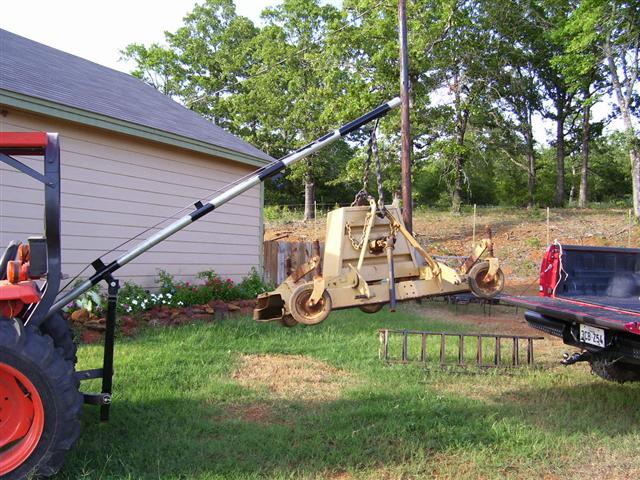

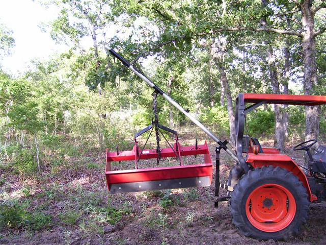

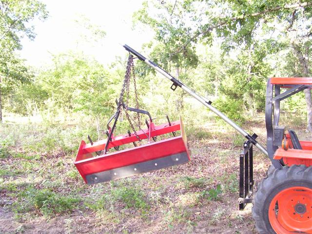

Got the boom pole built last week and tested this weekend. I went with the straight pole design, where the pole is the top link (IE no top link needed). Because of the materials I used I have to make a couple changes, I already cut off the part of the square frame below the pins (allow the 3pt to go all the way down, and will re drill the holes at the pivot...thus lowering the pole height at it's lowest position. But after getting into the office this morning I noticed I probably overloaded it. My 5' FM is heavier than I thought. 530#. Boy that truss strap was tight. Another reason I'm going to strengthen it as well. The box blade is much lighter, about 420#. The inner lifting eye also makes it easier to handle. With the FM on the back, I could just about tip the tractor over by hand!! But the idea is to just move in into the back of a pickup...and I can lift it and back the truck under it so the tractor doesn't have to move. This pole is easier to handle to.

Try a larger diameter pipe, I used a 3" schedule 40 and I am going to 4" schedule 40 with the three inside. how much do Case factory forks weigh at 10 feet out? We have simular ideas.

I almost got some 3" sch 40 they had at the steel yard, a lot heavier and I didn't think I needed it. This one is sch 40 2.5".
I ain't making another one....I promise!! :) Even though the boom part is the easiest.

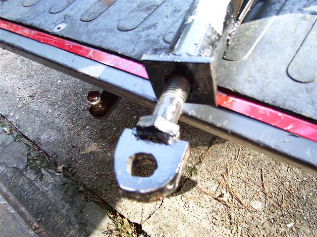

Got any pictures of the top link end? Did you just weld a heim joint into the pipe?

i'll shoot a pic tonight for you. But basically I took a piece of 1/4" plate to cover the end of the pipe, burned a hole in the plate large enough for a 1" bolt. Welded the 1" nut to the inside of the plate (end cover plate), then welded the plate to the pipe. So now the 1" bolt can be screwed into the end cap. Then I welded a piece of 1"x2" (I think, I changed this part once) solid bar (about 2-3" long) onto the head of the bolt. Then burned a 3/4" hole in it so I could attach it into the top link mount. I had a smaller/lighter design but decided to beef it up. It ain't pretty but it's holding.
Heim joint, something I learned new today. On my BIL humongus one I posted a picture of they welded this joint to the pipe. I only have one of these and it works, TSC didn't have just the joint on sale so what I did was cheaper and works just about as good.

Here is a pic of the top link joint. Sorry for the crappy pic (not happy with the new Kodak C340 and I'm a little to close). It's actually 2 3/8" plates welded together with the 1" bolt. As mentioned, it ain't pretty!!

Well just don't get under it when lifting... If you build another one, I would reccomend larger tube say 3" and increase the height of the topstrap where it passes over the structure going to the lift arms. Triangles are your friend. In this case a larger triangle would be better. The topstrap and the cantilever post form 2 back to back triangles that transfer a tension load up and over the cantilever post to the point where the strap attaches to the base of the boom. The larger that triangle(taller), the more force is transfered from the bending pole to tension on the topstrap. With the cantilever post short like you made it, the topstrap dosn't have as much mechanical advantage so it is under a lot of strain yet is not as effective at keeping the boom pole from bending as it could be. You could also pre-stress the whole assembly during construction by supporting the pole at the ends and putting enough weight in the middle to bend the pole slightly(very slightly, say 1/8") down in the middle, then weld on the topstrap. When you removed the bending force, The pole trying to return to straight would put the topstrap under tension or pre-load it removeing some of it's stretch before a load is applied to the boom. When you applied a load, the pole would have to bend past straight(it's strongest position) before it started bending down with the load.

Ron a lot of good stuff here and I could have used it. I just sort of copied some on the net. But I noticed the other night that the pole is slightly bend. I think the top strap I used stretched some (I didn't think the FM was over 500#). So since I went with a straight pole design (no top link), the pole is easy to redo. I think I will go back for the 3" pipe and a little taller top strap.
In the mean time I added a 1/2" square tubing on top of the top strap (welded along the lenght) to beef up the strap. I wanted solid but couldn't find any. Hey I'm not happy unless I build the same thing 2-3 times anyway.
Any thoughts on where/how my cantilever? In the middle of the pole, end like I have it. Severl I found on the net all seem to have the cantilever at the point of the bottom support.

The cantilever should be at the same point as the bottom support. It transfers a compressive force that offsets the tension in the topstrap. If this compressive force is at the point of the bottom support, it doesn't add any shear or bending stresses to the pole itself, but passes directly through the pole to the bottom support.
/ Boom Pole #11
Herringchoker is correct, you want the cantilever post at the point where the lower frame meets the boom(see pic). I like to break things down into lines of force. A weight applied to the end of the boom provides a downward force. This downward force is countered by the lift frame structure and the base of the boom attached to the tractor toplink fitting. Since these two points are not moveing, the boom tries to bend. the boom can't bend because the topstrap comes under tension preventing it. Since it can't bend, the boom pole is placed more under compression(stronger than shear or bending). The larger the diameter of the tube, the stiffer it is makeing it more resistant to bending under compression loads. The topstrap tension is transmitted back up over the cantilever to the base of the boom. This tension on the topstrap creates a downward compression force on the cantilever.
Because of this compression force on the cantilever, you want to have the cantilever larger at the base to distribute this force across the skin of the boom pole. If it is a small cantilever this concentrated force can distort/bend the boom pole. Better still would be a structure that surrounds the boom and instead of transfering this force to the boom, it transferes it around the boom and directly into the lift frame. The shape in the lower right of the pic shows what I mean, the hole represents where the boom would pass thru. The downward force of the cantilever would pass around the boom to the lift frame without damaging the tube.
