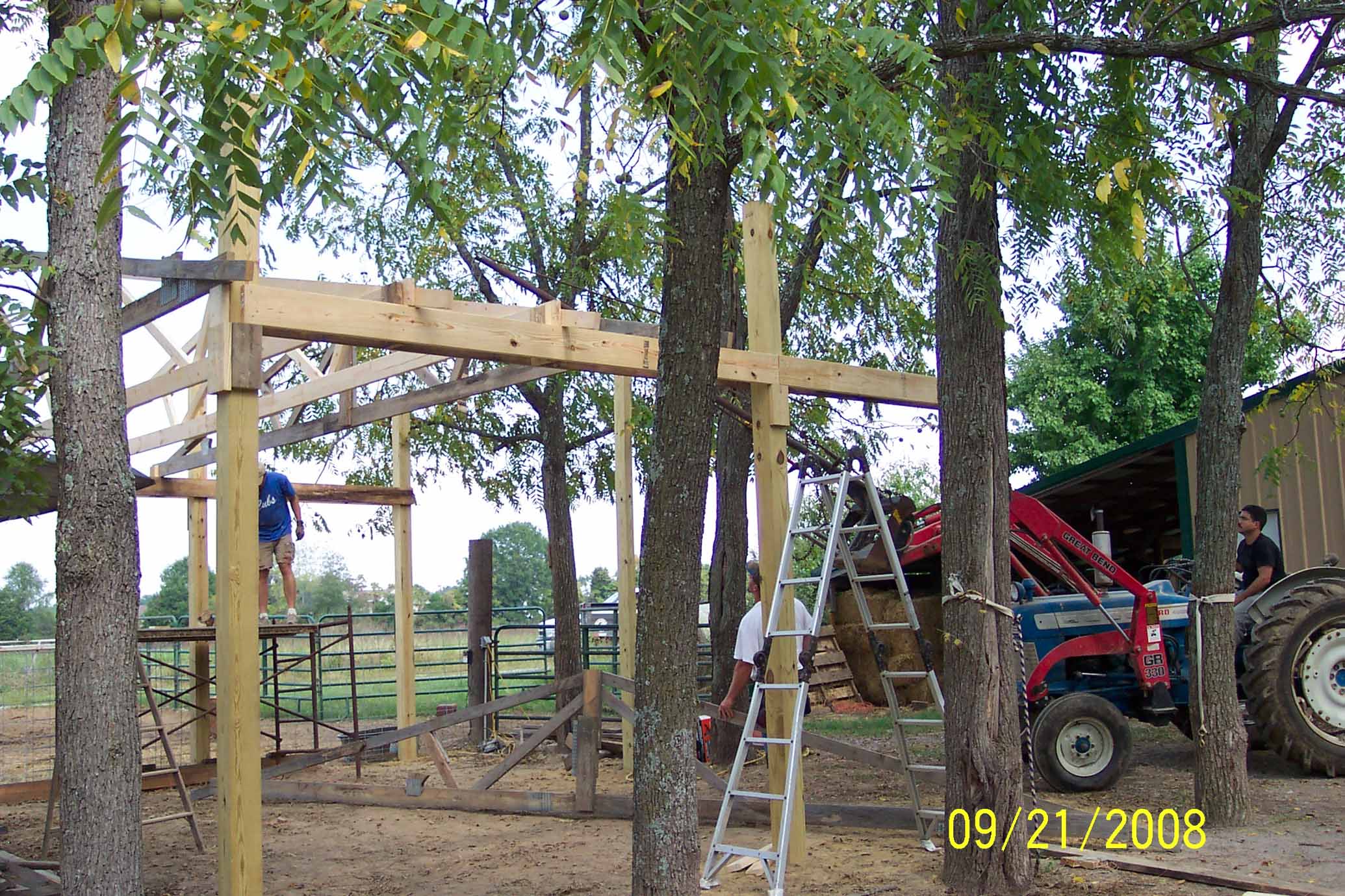

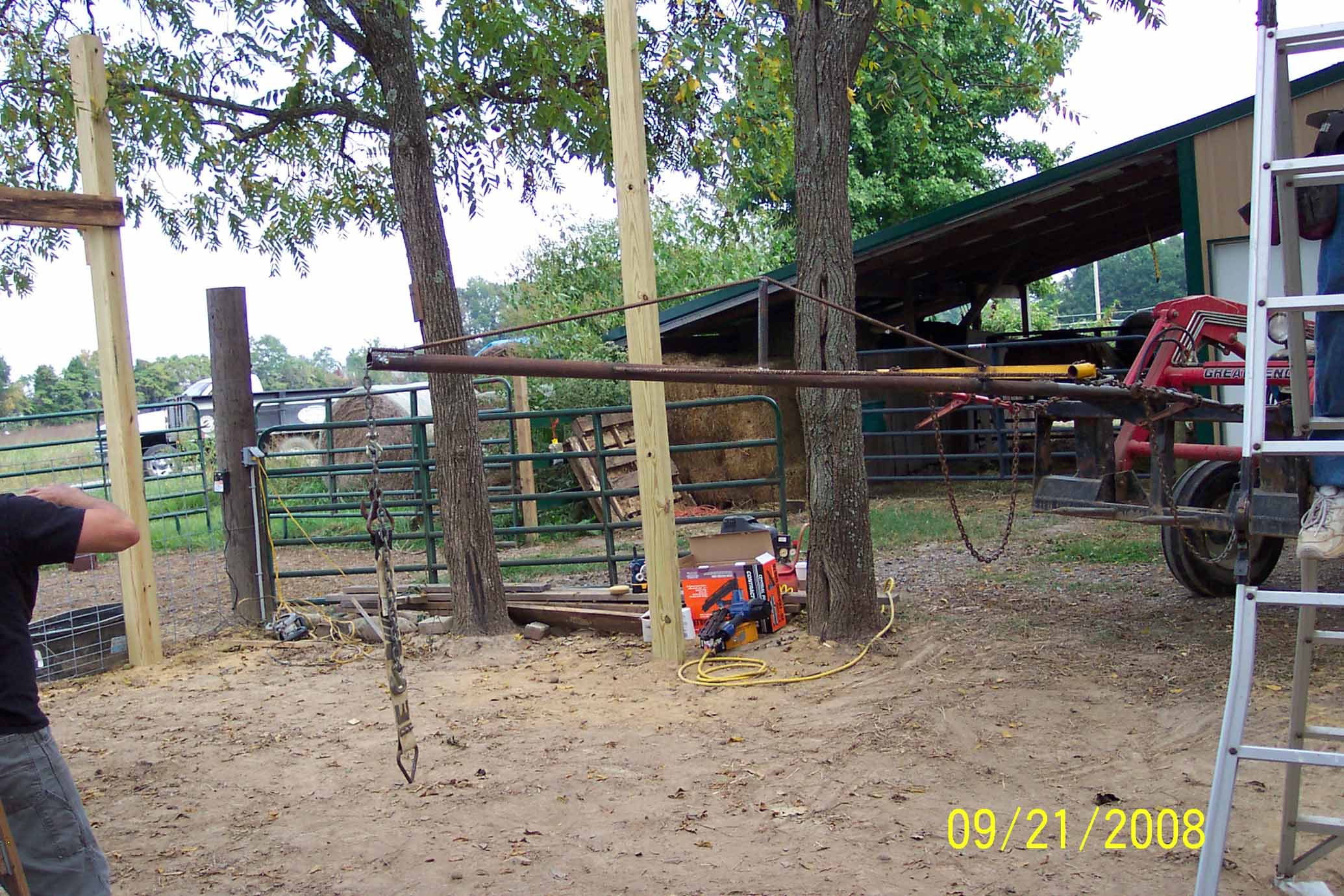

I made something similar, but not as advanced. We (I) wanted one quick, my buddy wanted to lift the trusses by hand, and I am ummmm, Lazy so wanted a boom pole so I made this one to anchor onto his bale spear and give us some height.
The sky is the limit for how creative you get in your mounts. My Backhoe has big U's on the bucket to hang my forks on, if I was going to use it on that I would have built something along the lines of my hang on forks.
Weight limits? Who knows, afraid I would get sued if I put any numbers out there :)

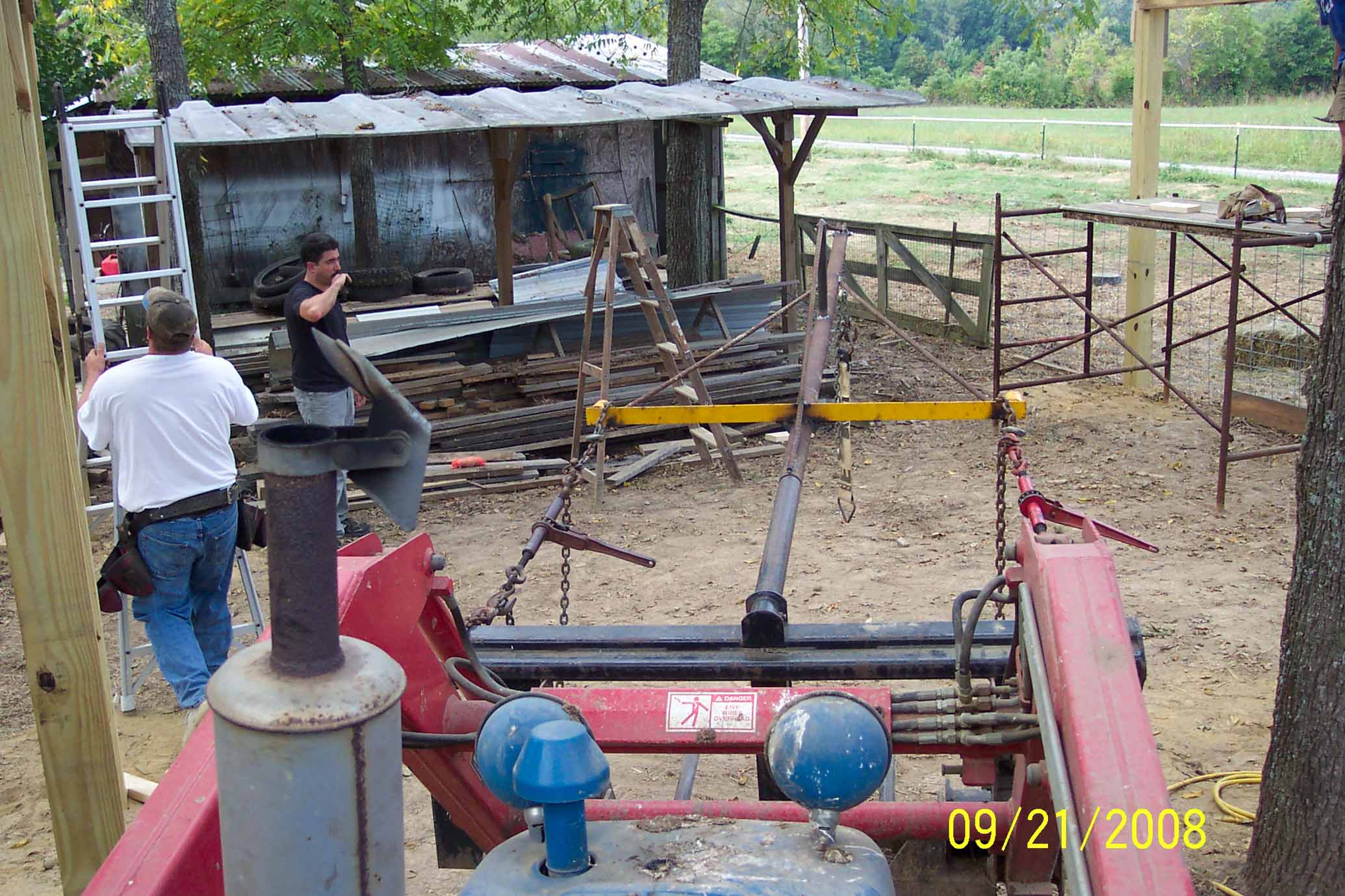

/ Boom pole for front end loader #7
I just measured it, and I used a 10' piece of pipe.
Just realized I left off the picture of the "hanging"
I hate manhandling stuff like that into place, it goes so bad when it goes wrong.

I know the feeling. When I did my shop we had to put steel trusses on the top of 6x6's 12ft in the air. I had two people helping me and we built walk boards along the 6x6 posts and tried to do it by hand. After about 5min of attempting the first truss I broke down and rented a pull behind JLG lift from home depot. About an hour with the lift behind my 4 wheeler and all 5 trusses were set.....
I didnt have my back hoe way back then and need to lift alot more weight than a JLG lift will hold now. Im building something similar to whats in the pic and have all done but setting the top pole

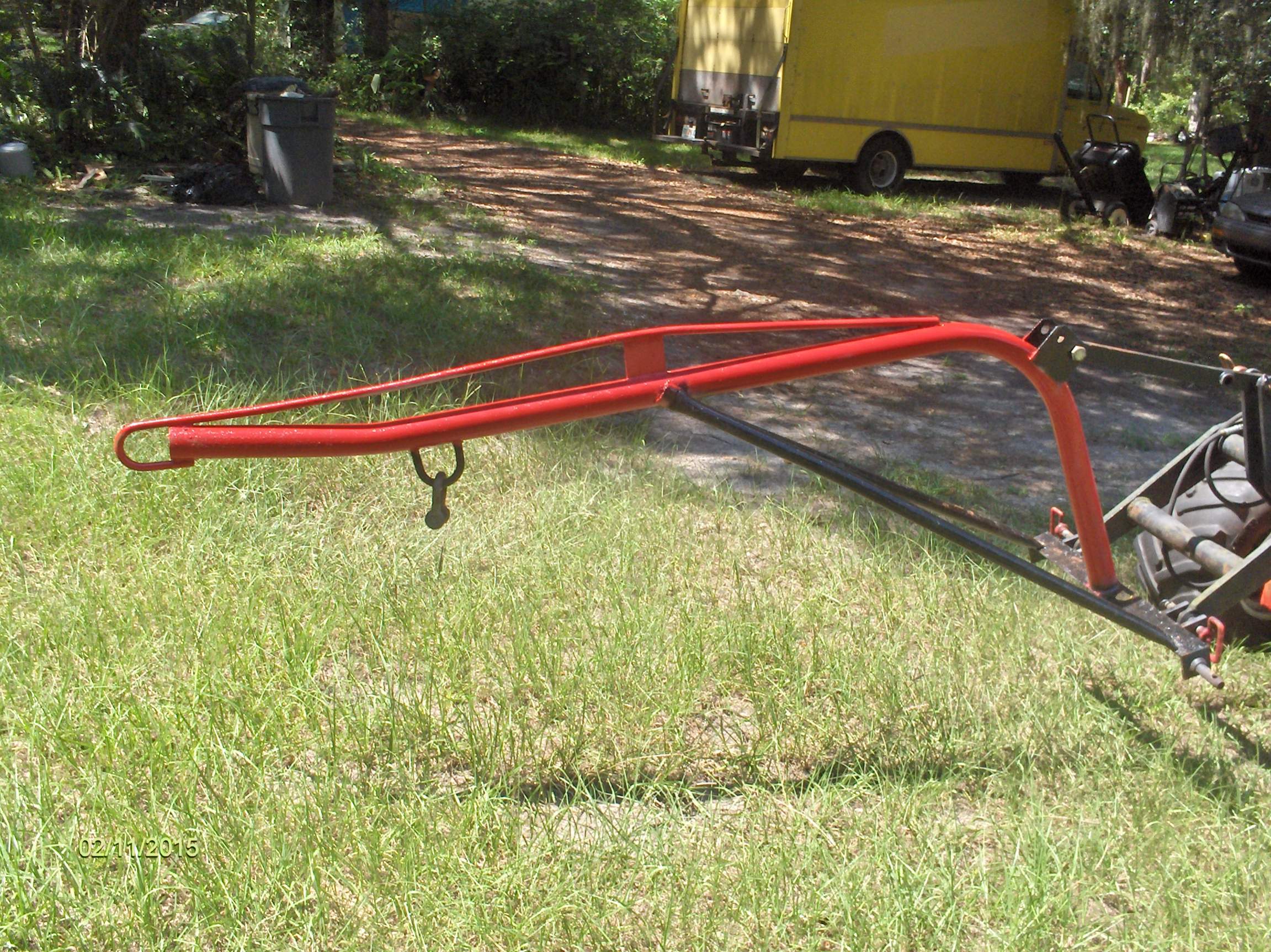

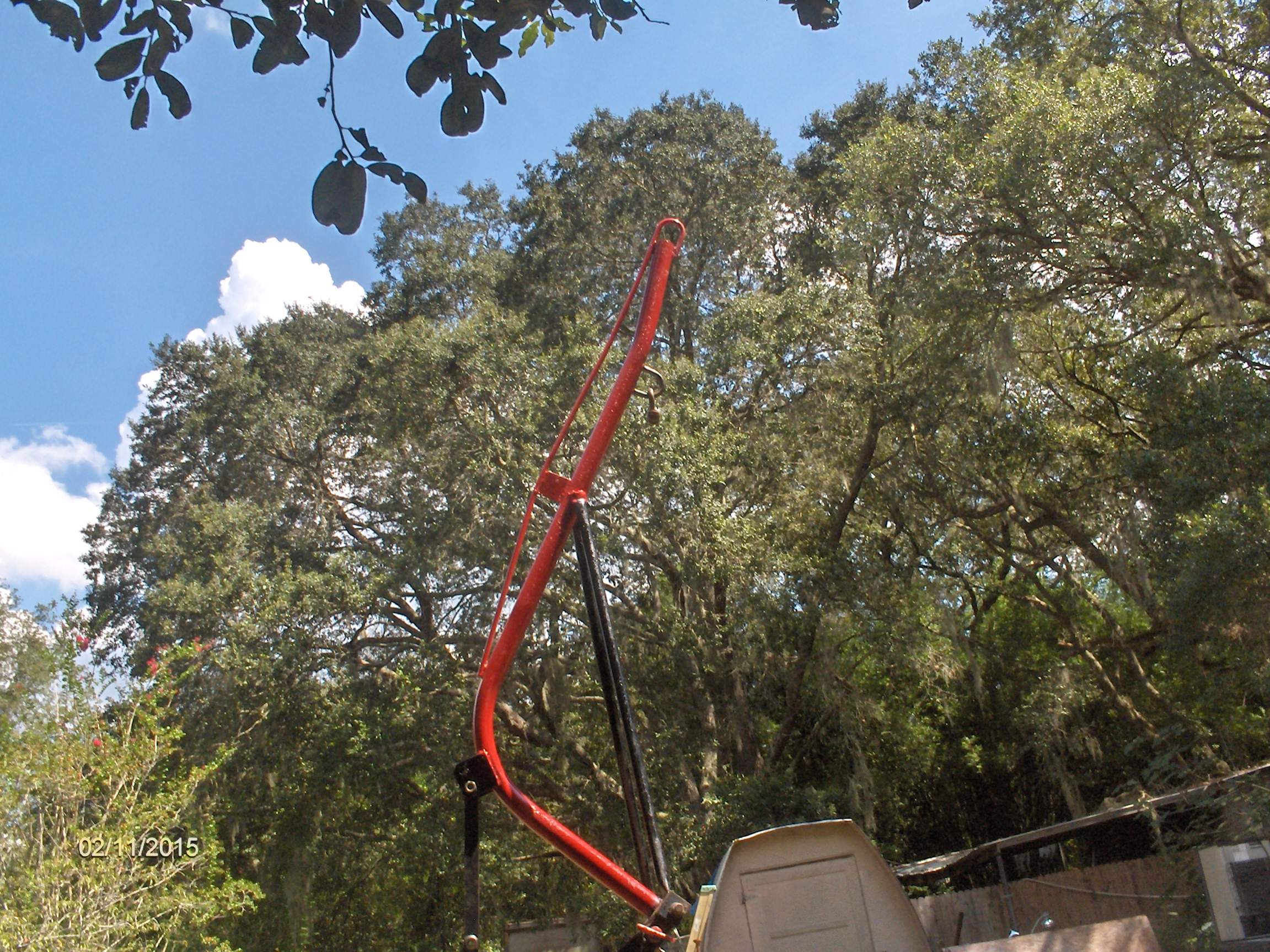

/ Boom pole for front end loader #13
I just adapted one of these for the front of my Power-Trac.

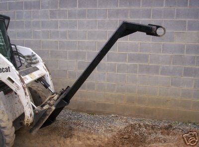

:Here are some more samples of boom poles.

::UPDATE:: I got the pole set yesterday using the boom pole I made. I ended up simplifying my design and using chains to hold everything one. It worked perfectly, with out any problems, and didn't appear to put a strain on anything on the hoe. The first pics posted are of the contraption I built, then one of me ripping the walk platform down that I had built before I owned a back hoe, then some of the completed project.
