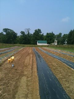

I am going to build a sprayer for our gator, currently we have 4 rows in 12 feet then a drive then another 12 feet on the other side. So 12 foot boom on each side will get the plants from above, I have read about 2 nozzle systems that can cover 24 feet without booms but they spray close to the ground.
Has anyone had any experience with the later.

I will point out that I am not spraying crops but turf. My single point nozzle will cover 16' or more, and allow for more overlap around objects that booms will allow. Also don't have to worry about it catching on anything behind you.
/ Boom or non boom sprayer
This is for spraying insecticidal soap or neem oil, we control weeds by mechanical means and heavy layers like leaves and grass clippings. We are not an organic farm but we only use organic approved pesticides.
Drift isint much of an issue that I am aware of, the neem and soaps don't hurt the plants in this concentration, they just disrupt the feeding, breeding and damage their exoskeleton.
I have been spraying by hand for years, but we are getting too big now. Sounds like wee need to go boom sprayer and I am good with. That just don't want to spend anymore money than I have to lol.
