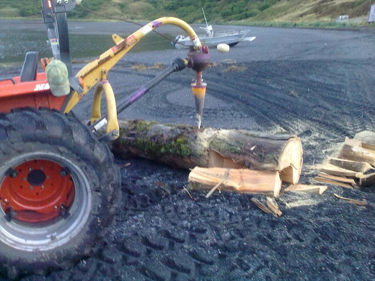

I developed an allergy to what I call "real"boats quite a few years ago, now I just fish in open skiffs from a cabin on the beach. The one I use for crabbin is 30' and just an open skiff, I just put it sideways to the shoreline to load/unload it reaching in with the loader. If I don't do it at the top half of the tide then I have to travel 1/2 a mile one way so I need to do it relatively quickly. A full load is 75 pots and I only do that many on a nice weather day. I just reach over the rail with my forks and put off/on a stack that's y if I could just reach in with the bh(not long enough by itself) for another stack it would speed things up considerably but with a rapidly incoming tide loading/unloading stoneboats/trailers would take up a bit of time. About half of the time I am fishing alone and have to get off/on the tractor to put the hooks in each load.
I was mostly just worried that a 5' extension attached to the bucket with 500 lbs would stress the bh. With it on the bucket for transportation I would be able to lower the dipper with the bucket boom raised keeping the pots lower and not swinging as they would be resting against the bucket boom just like they do against the forks.
I appreciate all the input from you guys! Except for a few months in the summer there is noone else in the bays to bounce things off of don't know how I got by without a tractor or tbn:thumbsup:.
Rick

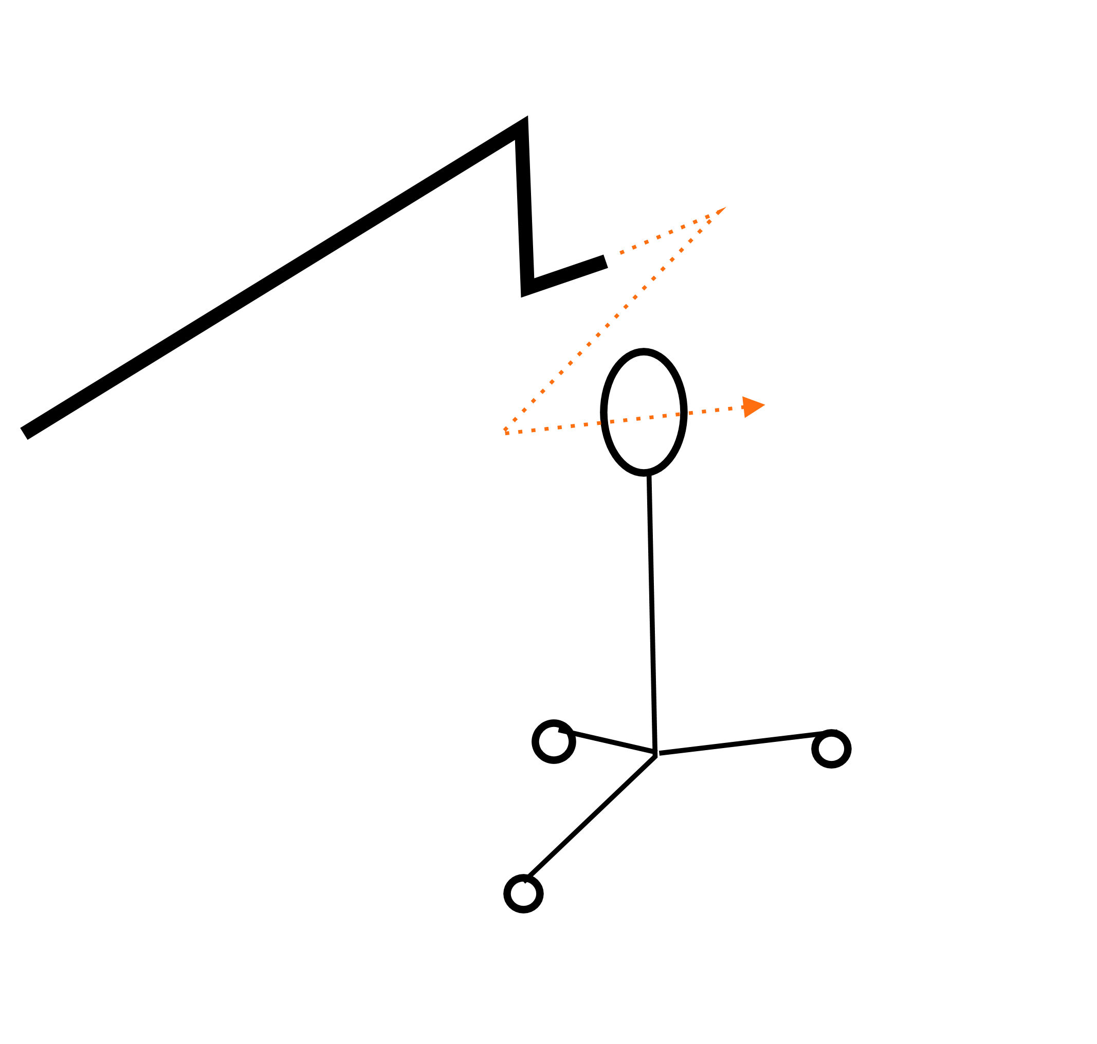

Let's say you have fair weather and 40 pots on the boat as you approach the beach...they are stacked? 8 stacks of 5 pots...is each stack "rigged" and ready to be hooked? or, only one? That is, is there only one set of "rigging" or 8?
If you were able to use the backhoe as you had hoped, you would have two stacks rigged to pick up? That is 2 sets of rigging (or 8...all stack rigged)...
But, (again, if the backhoe worked as you had hoped) wouldn't you stillhave to get on/off the tractor twice at the beach and maybe only once on the high ground ... so with 8 stacks and 4 runs using loader & BH you are on and off 12 or 16 times. Using just the loader, you are on and off 16 times (and probably can drive a trifle faster, no? Where am I going with this? I bet the lion's share of the time (and certainly the effort) is getting on and off, not the driving. So, that's where I might focus my efforts...what's the minimum number of times you need get on and off? Once on at the beginning of the process and once when you are done. ...suppose we could save 15 on/offs?
If all 8 of our stacks were rigged at the start, ready to be hooked ...and if you could hook on and disgorge without leaving the seat...
Perhaps 8 sets of rigging something like the attached pix ...you are a fisherman, right? So, pre-rig each stack with the gizmo on top...beach and get on the tractor, snag-carry-disgorge ...snag-carry-disgorge ...etc.

saw the (two) gaff hooks ...my gizmo would use 3 which, if uniformly spaced, makes it stable and holds the stack captive (which 2 does not)....but, something in your post leads me to think you feel you can't always conveniently attach three because of the way the stacks are packed on the boat...
understand that you want to do the rigging when beached rather than on the open water ...still, when you have a crew they can be rigging the next while you are delivering one... if you have enough sets of rigging... and the open-hook scheme means you can disengage w.o. getting off on the high ground...just drop the load turn around and hook next. ...
I am assuming the goal is to minimize the total offload time without increasing the effort, so it seems reasonable to understand where the time really goes. It may be, however, that you've got it as good as it's going to get (short of pulling the whole loaded boat up a set of ways with your D-8)
