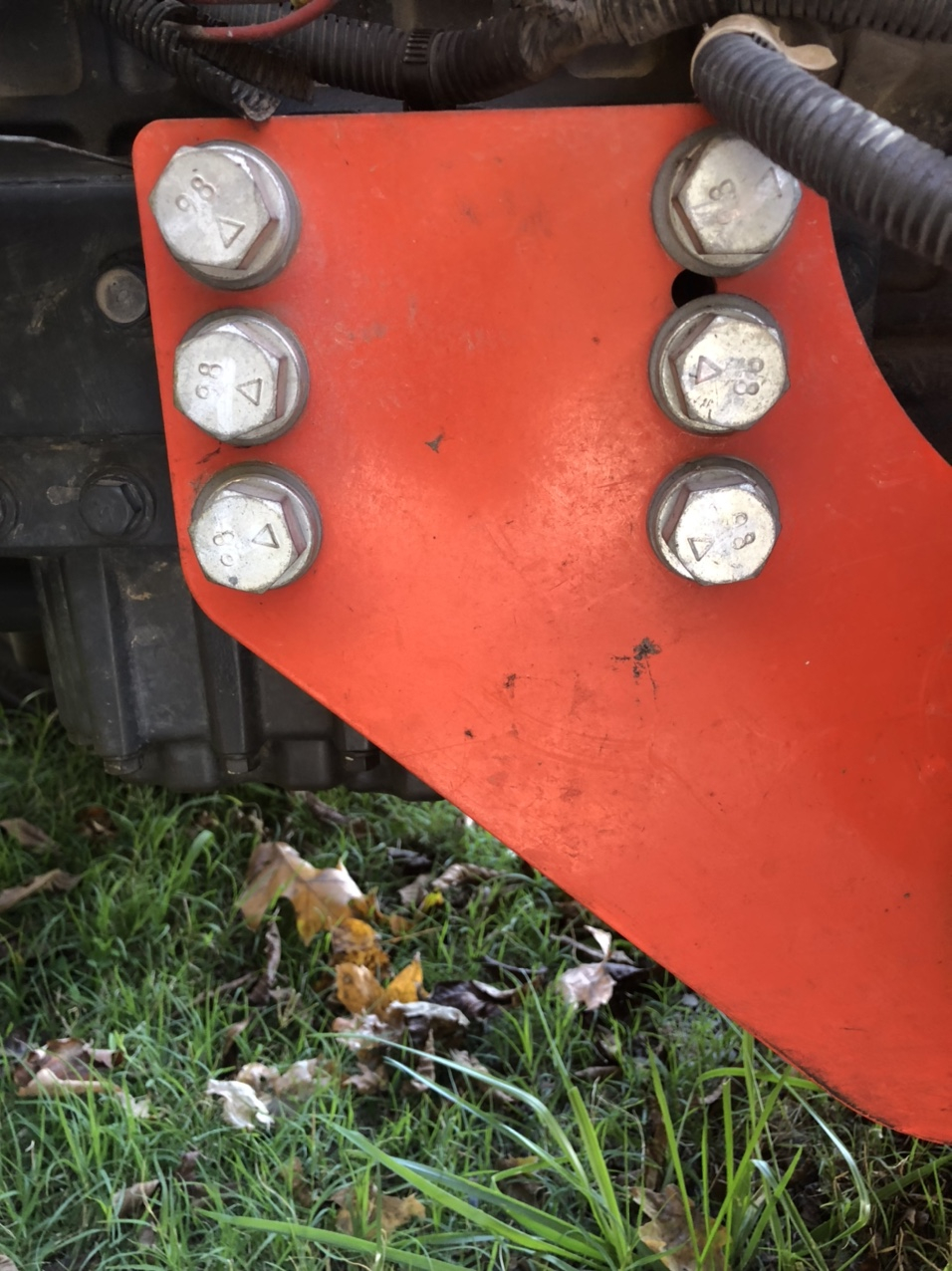

Update, Sort of? I was able to get some bolts and get to the tractor today. 14mm is too small and goes in the hole without even touching, However 5/8 bolt seems to be about the right size and will try to start a thread but i did not force it for fear of cross threading. So here is my plan, I am going to get the paint out of the hole, gotta find a small enough wire brush or had thought of a dremel wire wheel also. while i am at it i am going to get a 5/8 fine thread bolt just in case and a 16mm 1.75 and 2.0 thread just in case. I am bound to be close if the 5/8 standard sae is trying to thread. It was late and didn't get to fool with it much this evening but i think i am making progress.

I don't think they make a 16x1.75.
You already tried the 16x1.5.....that only leaves 2.0 pitch if they are 16.
All the Kubota I have had....and from what others here have posted.....those casting holes are fine thread..
Now I wondering if the 16x1.5 bolts are indeed the correct bolts....but the threads just need cleaned.
5/8=.625
.625*25.4 =15.875 (most major diameter or outer diameter are a little small for clearance).
I think you are on the right track and another here warned about this type of overlap where even the pitch ALMOST fits.
If you have a bench grinder or Dremel, you can grind a cut into the first few threads imitating a tap. With the right bolt, this becomes an area for grime and paint to collect just like a tap does for chips. If you cut it right and leave the sharp edge on the left side of your cut, it can also help clean up some burrs as well.
Glad you are close. After 9 pages of posts, I think we are all invested in this now and need closure. :)

Can you take a picture of these holes? I went back and looked at your original post with the picture and those holes on my 7060 are 14mm. Are you looking at holes further back toward the drawbar bracket?

Bolt Update....here we go i have had time to fiddle with it some in between trying to do another million things. 1st off my tap and die set only goes to 1/2 inch bummer, that's just too small. Second 14 mm is just too small and 16mm is too big to start or even go in the hole. Third, and the pictures I will post show both a fine thread then a coarse thread 5/8 bolt starting into the holes. They will start however the fine thread just isn't it best I can tell. The coarse thread will seem to continue to screw in but it is extremely tight and i stopped after about a quarter turn out of fear! I have not worked out if this is a paint issue yet or a wrong pitch issue.....still trying things...and i will keep updating Thank's to all the third picture is just the hole itself showing the threads...

Rule of thumb: Cast iron and aluminum will always have coarse threads, whether SAE or metric.
