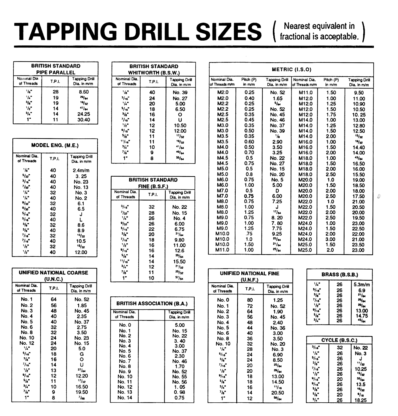

Here we go, this is what I have laminated in my shed

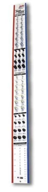

It's situations like this that drove me to get the full set of these:
Perhaps not as cheap as buying individual fasteners, but a lot more convient to have the full variety on hand and all hooked together.
(may be possible to find them cheaper elsewhere, but Bolt Depot tends to be one of my first stops for buying fasteners - and these were one of the more comprehensive sets I found).
BTW from my (very limited) understanding JIS fasteners use the standardized metric threading, but have smaller than standard heads.

I like the idea of screwing in a wood peg or even a whittled twig to get the correct thread pitch. BTW for the OP....metric thread pitch is the distance between each thread. A 1.5 pitch is 1.5 mm between each thread. Also, the tap drill size is the bolt diameter minus the pitch....so a 14x1.5 tap drill is 12.5 mm.
Another cool tool to have in the garage Thank You very Much

I bought one of these years back and also bought a nut or bolt to fit each stud or hole. Now there is zero guessing ever!
