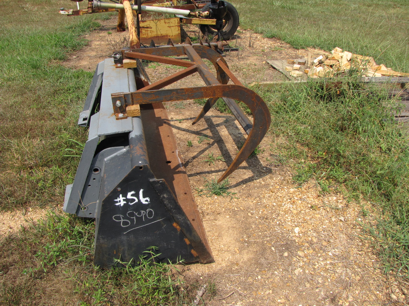

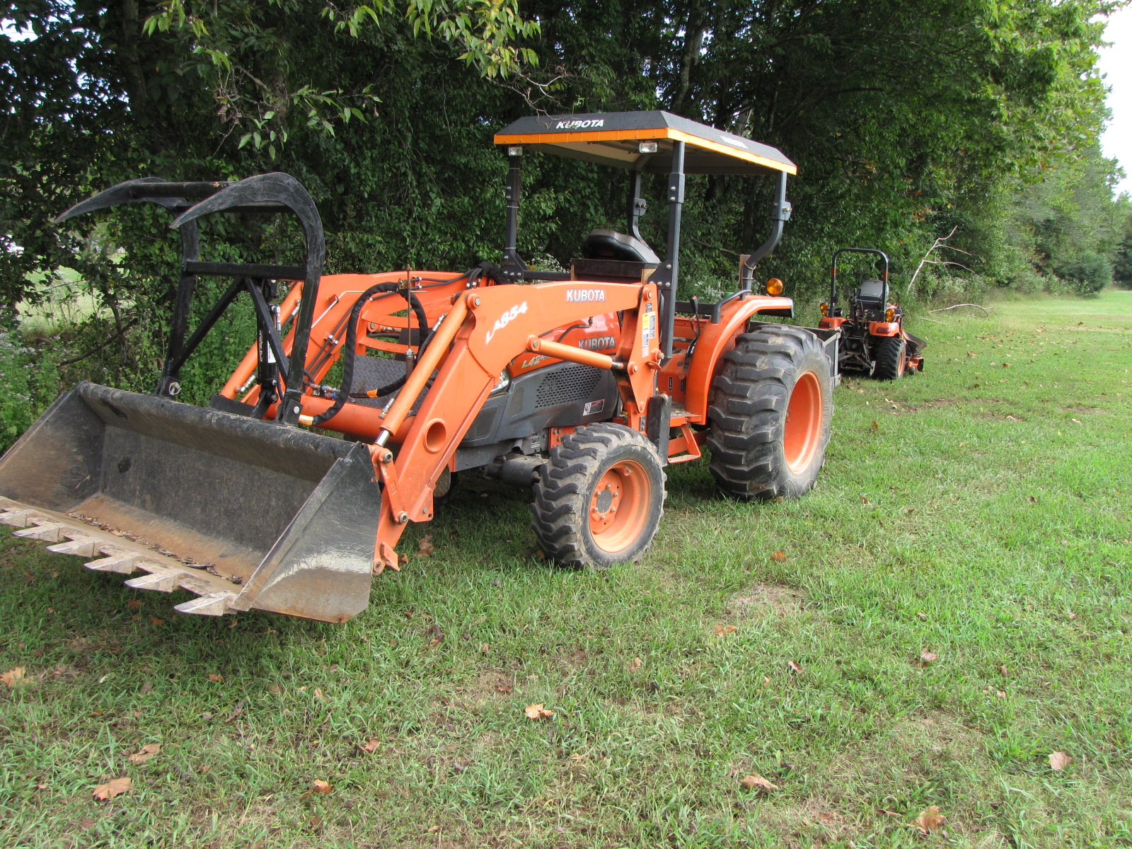

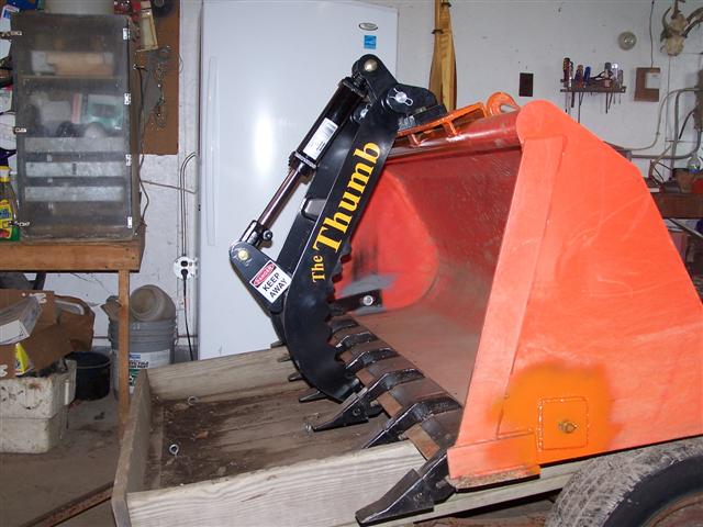

I was able to pick up this bucket for $160.00 and put a QC on it. Then added the grabber and the teeth. The teeth was right at $25.00 each. The cyl and hoses were about $120.00. In 2nd picture you can see the holes you are talking about.
Leejohn,
That bucket and graple look like they mean business. I wouldn't want to take you on in a tractor fight.
