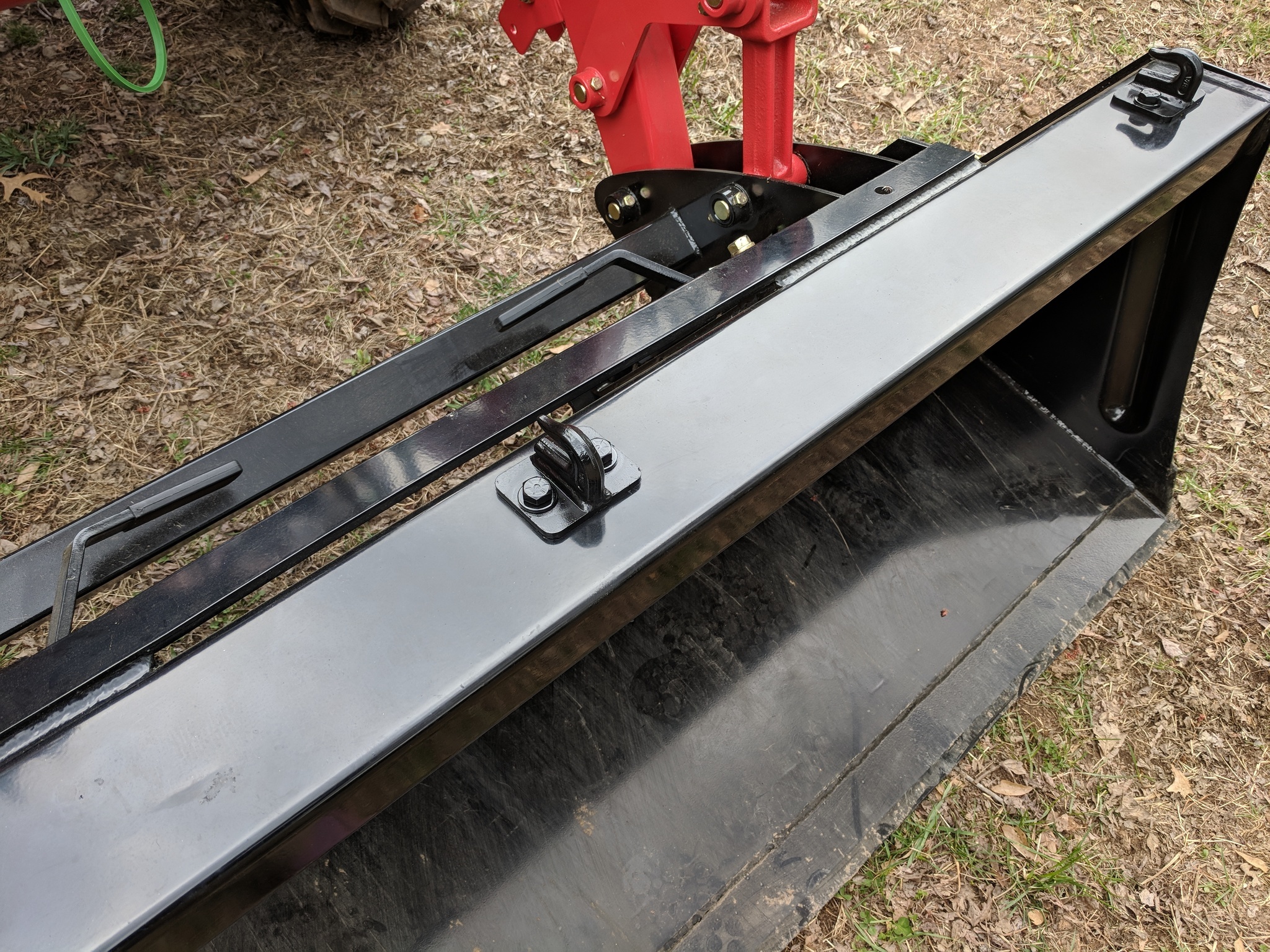

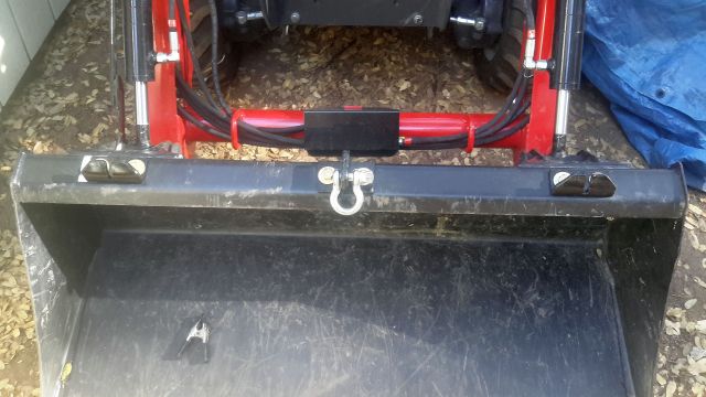

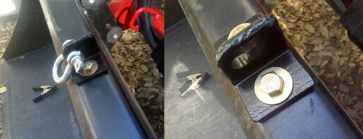

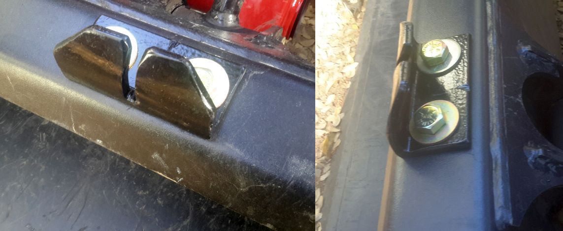

So it was a little scary drilling holes in a brand new tractor, but I got my hooks from Ken installed today. Easy 15 minute job.
Ahh - I remember that feeling. But in 20 years it will be covered with dodaads you added and it will feel like it is really your tractor. You will like those hooks !

I have a question for you engineer types and those that have abused bucket add ons. To spread stress, prevent distortion and cracking,shouldn't the hooks be mounted on plates with bucket sandwiched between? Yea,I know that mean's drilling more holes. If one chose's to weld,it would seem especially advisable to weld hook to a plate then weld plate to bucket rather than welding hook to bucket.
Ken actually sells some pre-made, pre-drilled backing plates that you can buy to use in case you want to mount the just the clevis without the hooks. The price was reasonable. Check out his site. You may need slightly longer bolts depending on what you do.
