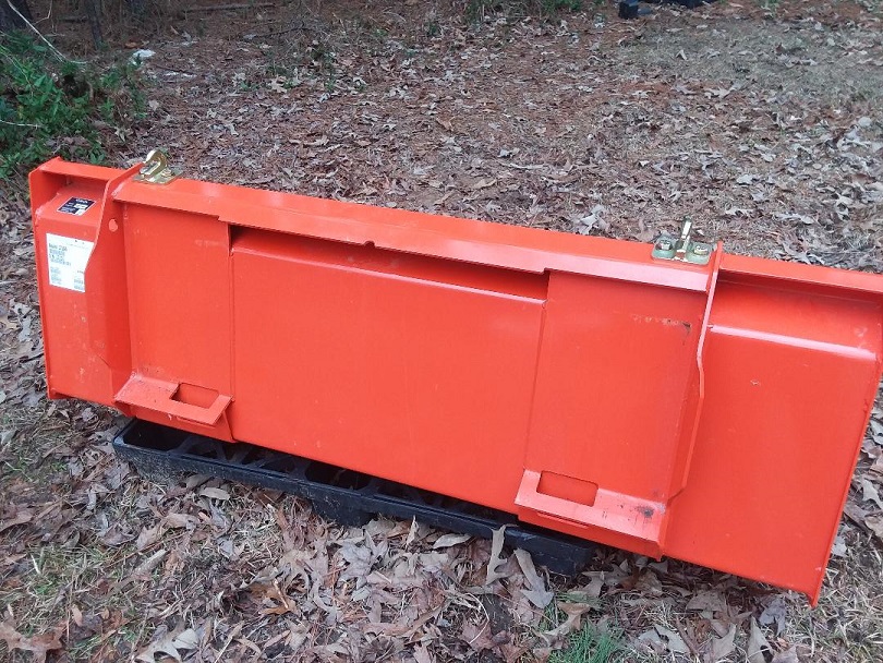

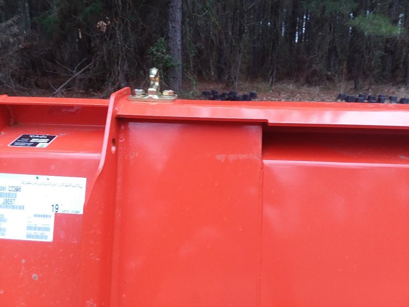

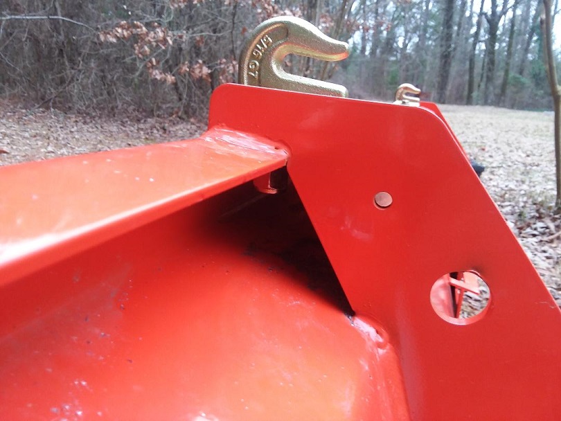

I recently installed two bolt on hooks from Kens bolt on grab hooks
The hook were high quality.
Two things to remember:
1) Drilling 4 holes took nearly 1 1/2 hrs. I'm sure this was due to going through 2 plates of metal on the bucket. My wife and I took turns. I used an electric drill and a Cobalt High-Speed Steel Drill Bit (1/2" x 6"L).
2) Going slow speed on the drill allowed for a better bite on the bit and straighter hole. The last hole I used highest speed and the hole ended up wallowed and not straight.
3) The placement of the hooks made if difficult to get one of the nuts and washers on the bolt. Needed my wifes small hands to reach behind the compartment.
I still need to put two bolt on shackles on the bucket will wait for next week and a new bit.
