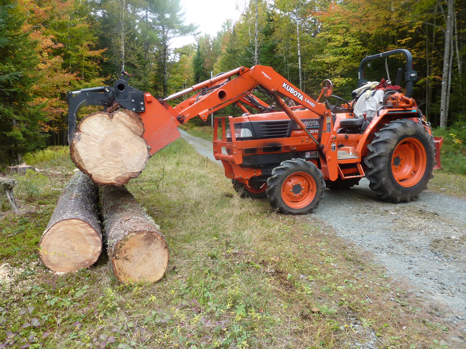

I have an old JD 855 with pin on bucket. Adding a quick attach and grapple is more than I wish to spend. I saw the Thumb bolt on unit and was wondering if anyone here has experience with it, or another device that will work for me. My plan is to add a diverter valve off the curl circuit to power it.
My loader is rated for 700 lbs. I want to limit the weight of the grapple. I use ballast (500 lbs in a carry all) and have about 375 lbs of fluid in the rear tires. Tractor weight is 2000 lbs. Any idea how much I could safely lift?

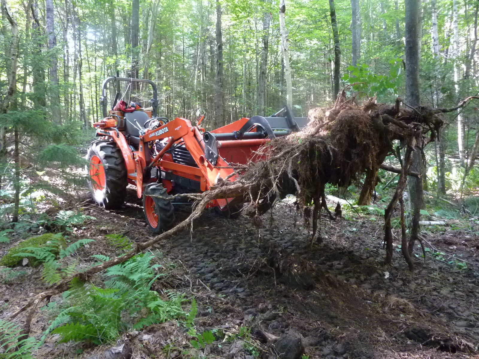

I do all the same things you want to do with my tractor. I had my place logged off last year, and seeing all those tops laying around looked like a very daunting task. I also have a pin on bucket, so a grapple didn't seem practical. so last spring I added a tooth bar and a thumb from Greens Machine. What a work saver and time saver! I pick up logs, brush, rounds for the splitter, rocks and anything else that I can think of. I run mine off the rear remote, because it was already there. I just unloaded a tandem trailer load of slab wood, which would have taken hours and a whole lot of hand work
Because of your limited lift capacity, a quick attach and a grapple would not leave much left of your lifting capacity, you would also have to alter your bucket for ssqa. Get the Thumb I love mine, wish I had done it a long time ago. You could go with just the thumb first to save weight and add a bolt on toothbar later if you feel you need it.

I have had ATI bolt on grapple for over 15 years. I have found it tremendously useful in the woods and around the firewood landing. Logs, brush, rocks, stumps and what ever. It is similar in function to the Thumb. Mine is on a loader rated for about 1000 lbs and a 30 hp tractor. I don't think you can go wrong adding a bolt on grapple. Watch the weight like you are doing and with your 500 lb ballast and loaded tires you should be well set up. If you can keep the weight you lift centered there is no reason you won't be able to safely lift to the full capability of the loader.

When you get your attachment look closely at where it mounts on your bucket. You may want some reinforcement added. The grapple will try to pry up and back on the top edge of your bucket.
If you think it needs strengthened and don't feel capable, talk to a local welding shop. They can guide you on what's needed and do the job for you or sell you the material.
You won't be a happy guy if you bend the crap out of your bucket.

If you buy the thumb,you better be prepared to fabricate and weld. I put one on my tractor. I used a 6x6x1/2" angle to reinforce the bucket and to mount the thumb. Part of the mounting is deciding where you want the points of your claw to hit your bucket. I changed my mounting several times and added on to the points with some scrap steel.
Then you need to learn to use it without seeing through the bucket. Imagine picking up a big dowel rod with needle nose pliers or scissors. Then under no circumstances should try to back drag with the thumb. You will really hate what that does. Then once you get the hang of it and really start using it,that's when those cheap mig welds start popping like buttons on a fat mans shirt. I rebuilt mine with 3" tubing and 7018 welding rod.

not sure what this means...my thumb has picked up huge boulders, 14 foot telephone poles and never had a prob.
I did add piece of angle iron to the top of the bucket
Back draging? The thumb is on top, please explain....
Popping welds? What are you doing? Maybe you need a bigger grapple. Got pics?

I broke the welds on each side. It was dangling by the cylinder. Got it back to the shop and lined it up and rewelded. Next I broke the tubing where the cylinder rod is connected. Replaced that with 3" tube and welded some gussets in the corner. I opened the grapple wide open rolled the bucket all way down until the grapple was in the dirt. Then started back dragging some small debri. It brought the thumb past the geometrical magical point of no return. Then you have to pull the pin and let the thumb slam closed,extend the cylinder, and find that spot where it will reconnect. I welded stops on mine after doing it two or three times. I heard they have adjustable stops that go on the cylinder to keep from retracting it to far. When I changed the tubing support I must have changed the geometry enough that I didn't have that problem and it didn't hit the stops anymore. I still recommend you don't back drag with it.
