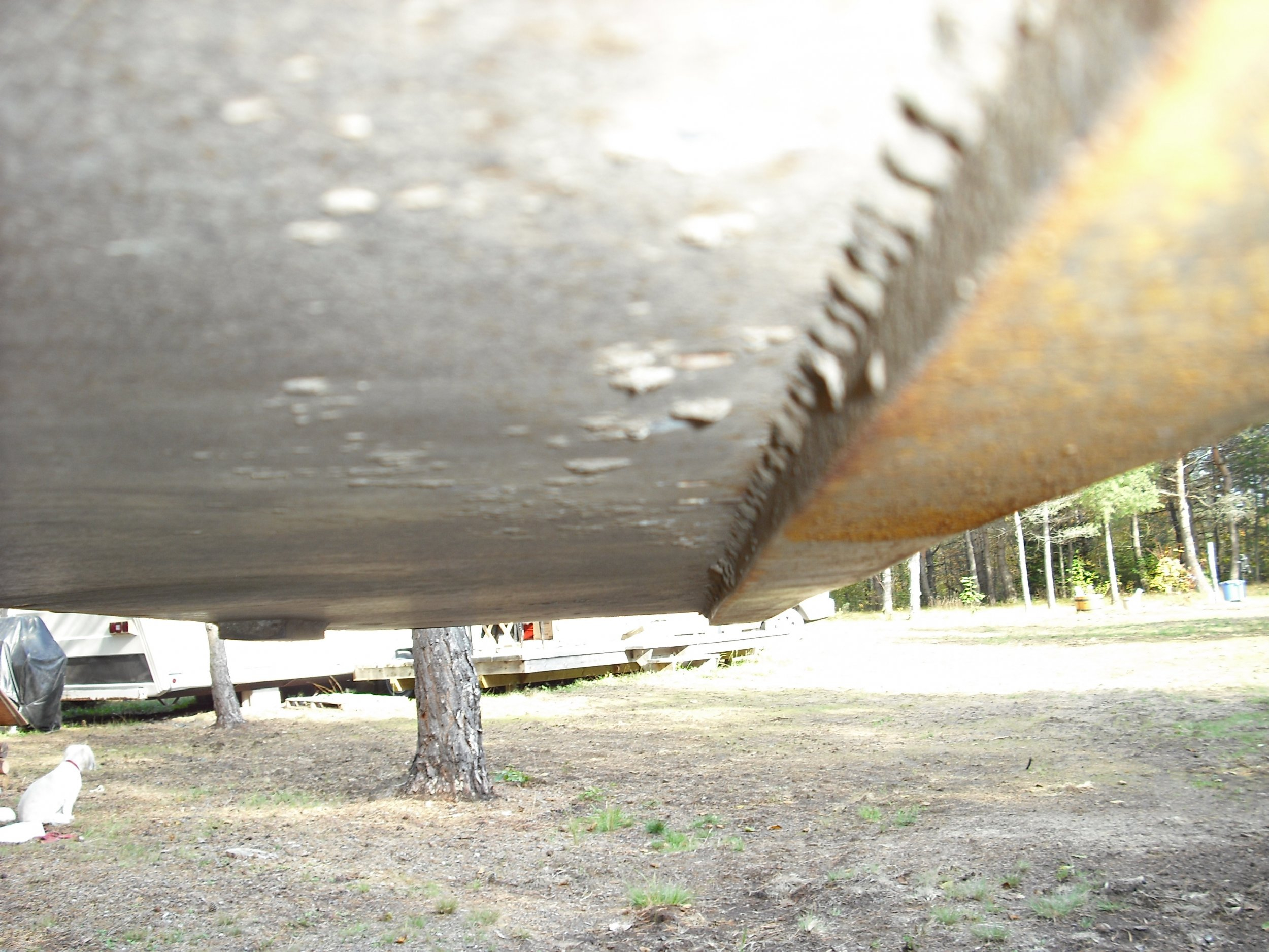

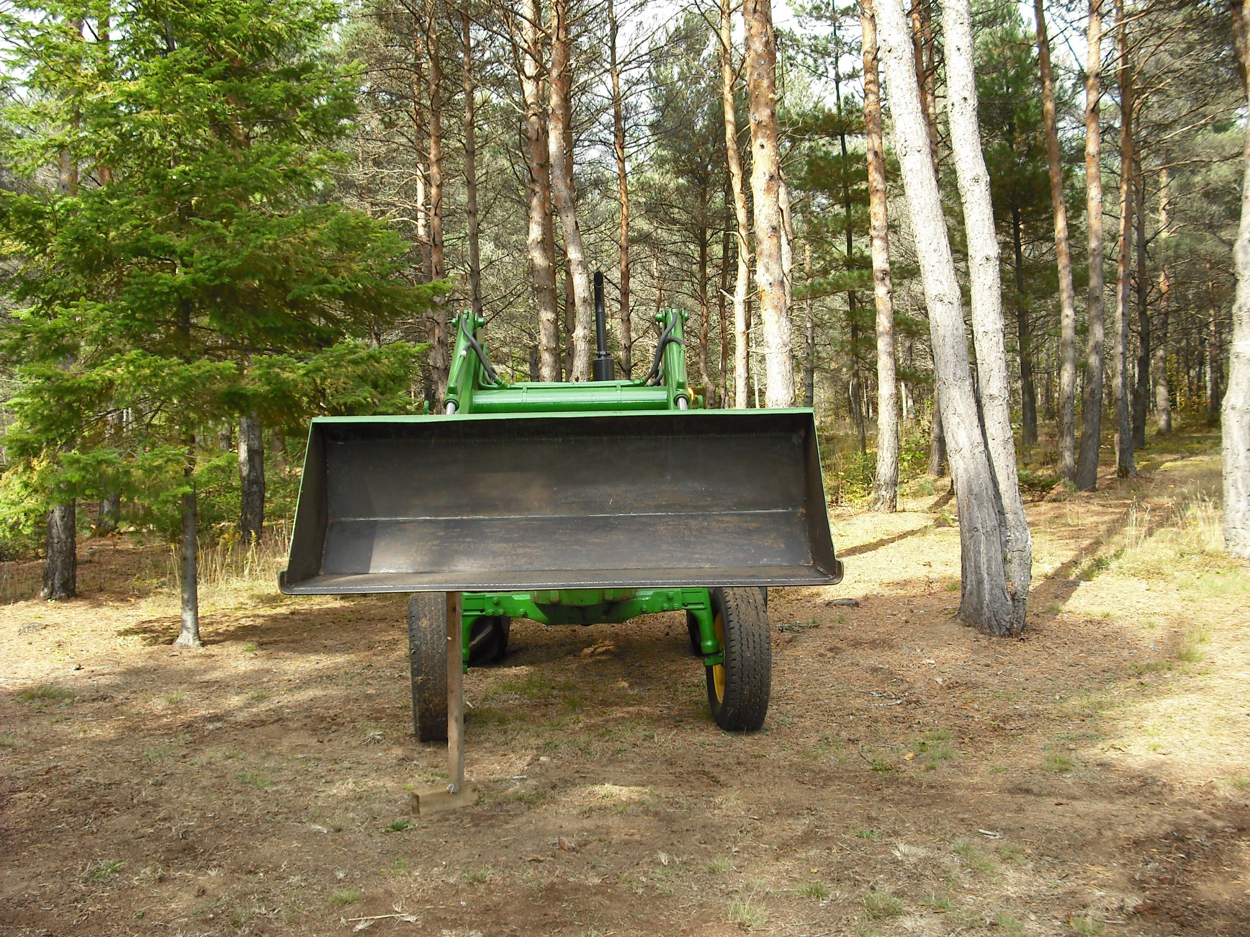

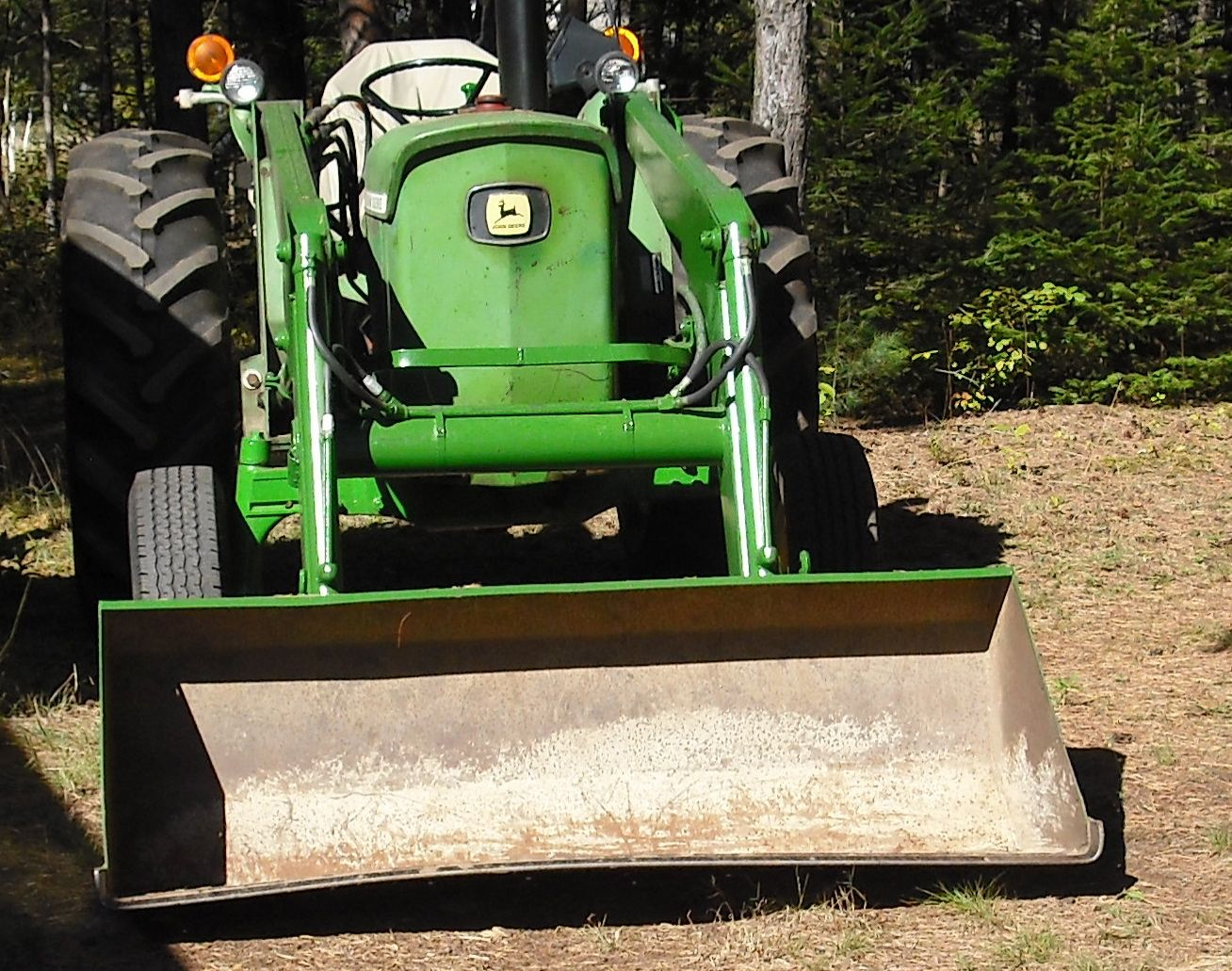

/ Bolt on blade for buckets #24
Went into local township road yard and they gave me a chipped snow plough blade that was done for them. I welded it ontp the front edge and works for many years now. It was 1" thick by 5" wide and full 6' long
/ Bolt on blade for buckets #25
So the 1" blade took the "smile" out of your bucket?
