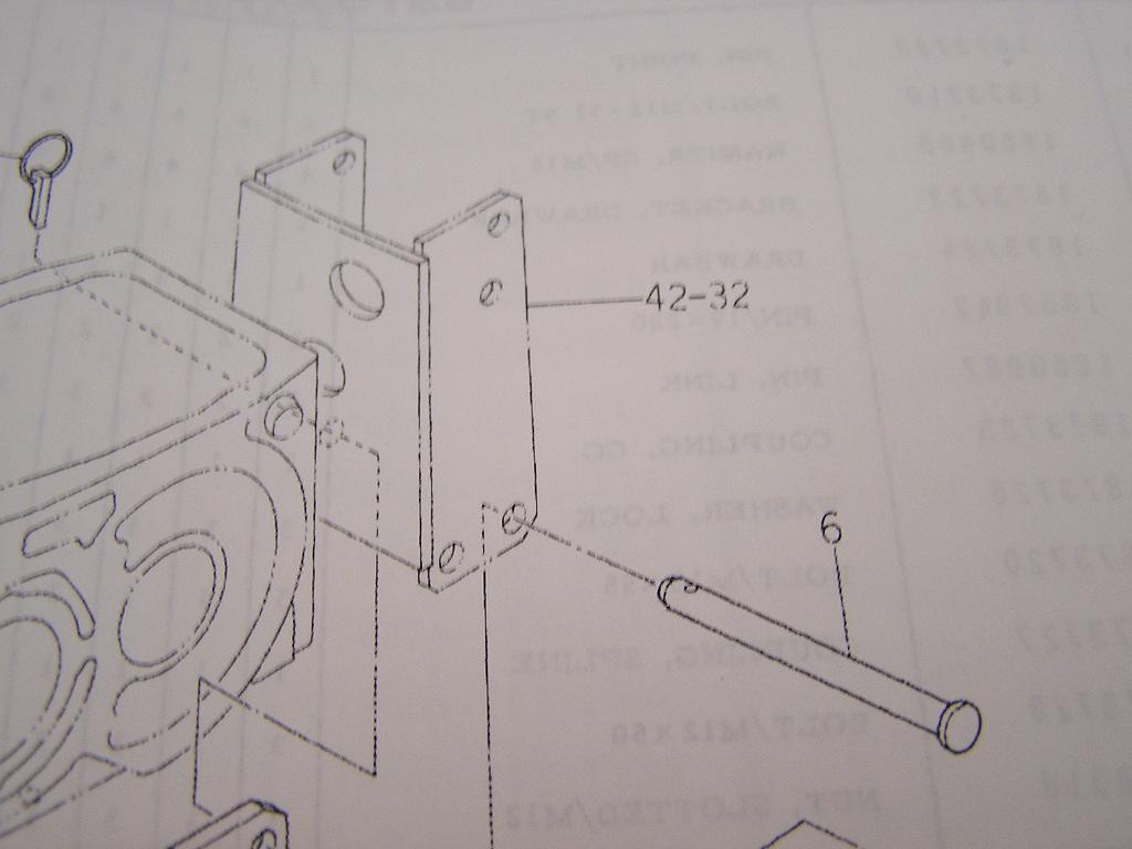

/ Bolens/Iseki rototiller help needed #4
I believe that your machine is similar to my TS1910/G192. Do you have the U shaped bracket bolted to the rear of your transmission case? see attachment.
If it's the same as my tiller setup, the tiller should slide inside this bracket and attach with 2 of 19mm(3/4) pins. The 2x mounting holes on the transmission case bracket on mine are double thickness for additional strenght and 160mm (6" approx) apart.

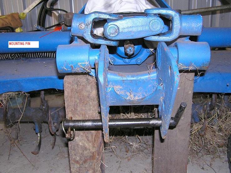

/ Bolens/Iseki rototiller help needed #5
This is a picture of my tiller showing one mounting pin in place and I have noted the lifting arms mounting pin locations.
The PTO drive shaft is shown just for good measure it's 280mm long.
Hope this helps. /forums/images/graemlins/smile.gif

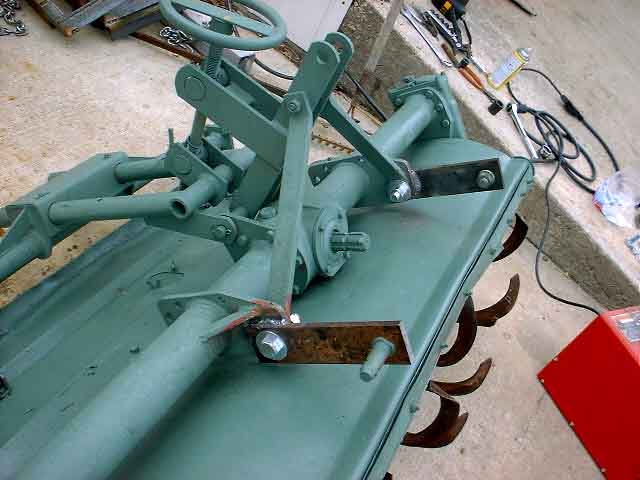

/ Bolens/Iseki rototiller help needed #8
You just need to find an sturdy place on the tiller to mount the hitch pins. Attached is a picture of a grey market tiller that shows how I extended the hitch pin brackets. Maybe it will give you some ideas.

/ Bolens/Iseki rototiller help needed #10
That wheel adjusts the height of a set of gauge wheels on the back of the tiller. Some of the grey market tillers from Japan come with the wheels, but often they are missing.

/ Bolens/Iseki rototiller help needed #13
