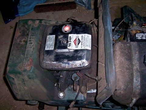

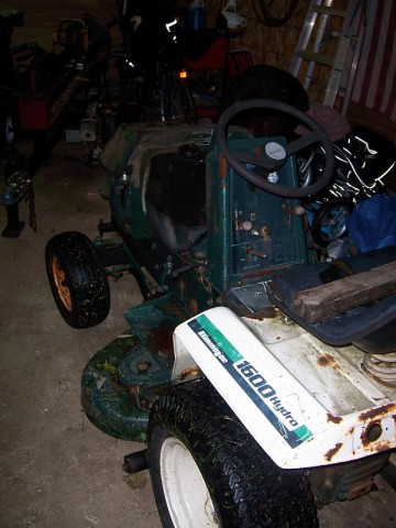

I was given a bolens 1600 hydro today. The engine runs but it's blowing smoke....it must have got hot at some point. I drove it a mile home and all seemed to work well though.
This tractor is new to me and I was curious how much towing I could do with it? I.E. hauling a small trailor around the yard full of wood, my log splitter and up hills and such. It's a hydro drive and I've never owned one so I don't know how durable it is.

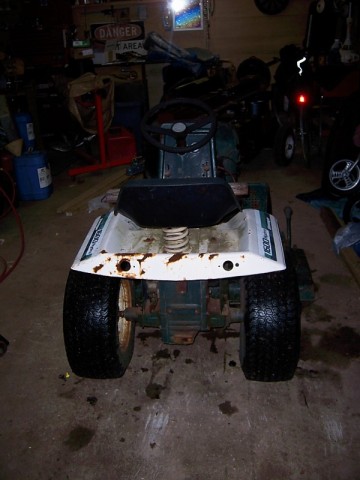

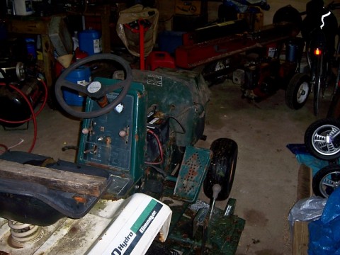

Thinking on doing a rebuild on this 16 hp briggs twin in detail with pictures...
Would anybody be interested?
I've never done one before, would people be willing to give advice/point me in the right direction along the way?
Is this tractor worth it....judging by my first post?
Kevin

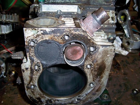

I pulled it all apart and found one of the exhaust seats loose. That's the main reason it had no power. Good news is, I brought the block to my local machine shop and they can fix it with an oversized seat. Also, I got an eng kit with .010 over pistons.
oliver28472..... I know what you mean but I just have to make the old girl run again. I get into things and cant let go.
Kevin

Machine shop called me and are going to install two new exhaust seats, new valves, bore it .020 over, and give it back to me to assemble then I can take it back over and they will adjust the valve hight.
I think this is going to be a nice machine when all's said and done :).
